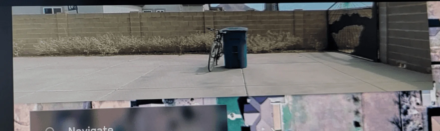

OK. This is one of my more goofy projects considering you can buy a backup camera for $100. However, it works. Basically it solves the problem of not having a rearview camera when the tailgate is down. I experienced this when I was carrying a full sized bed with the tonneau cover down. I only had my side mirrors and could not see if anyone was directly behind me.
This is a 3d print which holds some acrylic mirrors in a penta-prism arrangement such that it will reflect the camera view rearward when the tailgate is down and still have an upright image.
Image is somewhat degraded but it is still very useable - certainly better than nothing.
Image with tailgate up:
Image with tailgate down and "prism" installed:

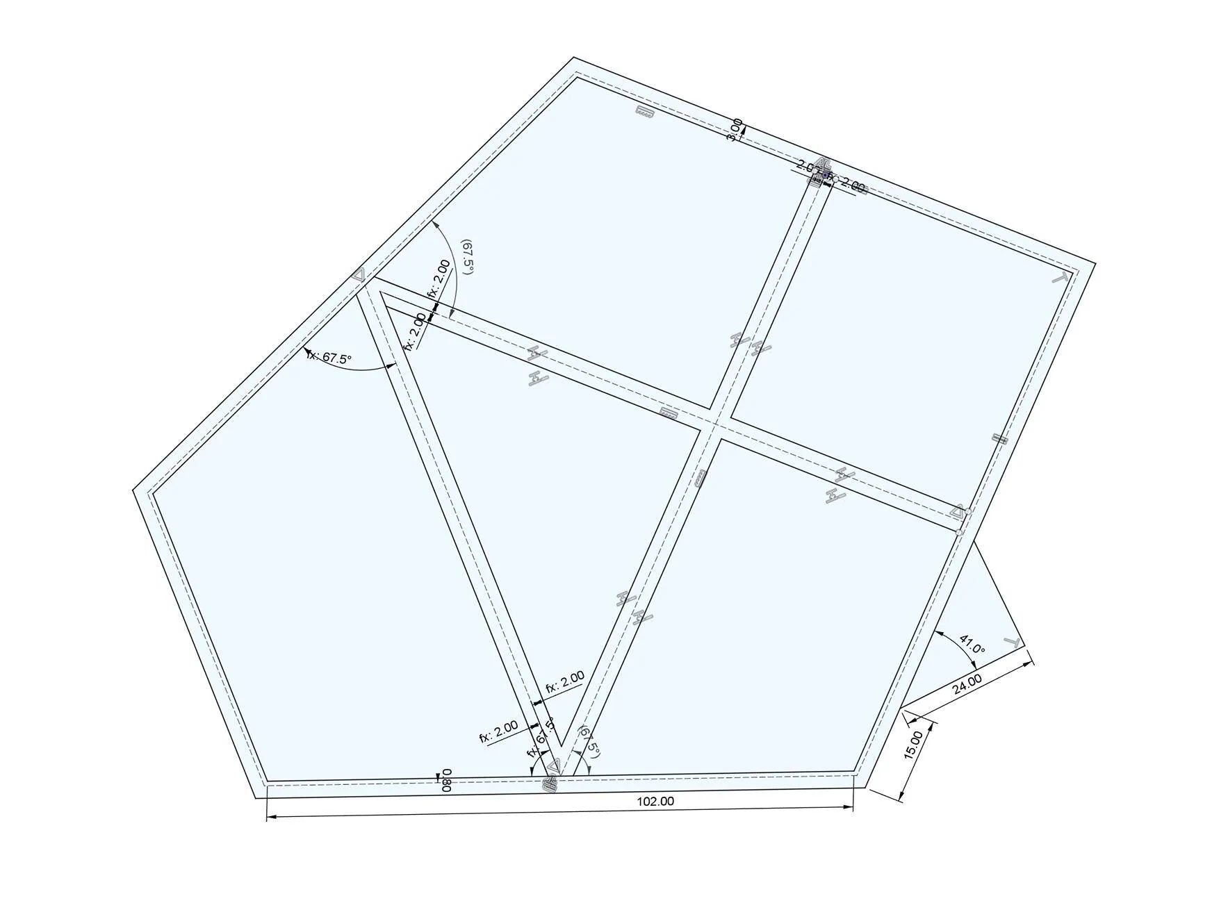

Hi. The idea of the penta-prism is brilliant. I would like to make one of these boxes out of fiberglass, with a snap-on feature rather than the bunji cord. Is there any chance you could post the actual dimensions in a diagram (end-on, in particular)? I realize it is either 300 millimeters or 12' of mirror, but the angles seem important. Those stl files do not have dimensions, and are perspective-view (warped in a viewer), so hard to unravel. TY. )))
The bungees are just for a backup. The primary connection mechanism is the magnets. But anyway, here is the side profile diagram with dimension (in mm). The dotted lines trace light coming in from the top and bouncing off the two mirrors and then exiting on the right (where the camera sits). I just added a constraint in the cad file that the reflected angles must be equal to the incident angles at each mirror and the exit must be perpendicular to the input. The CAD tool (Fusion360), then, solved for everything. You can see the answer it came up with (fx: 67.5 degrees).

Much appreciated. Your angle calculation is one thing, but you also worked out the field of view quite efficiently. I will post up my version of this box as I get to it.
