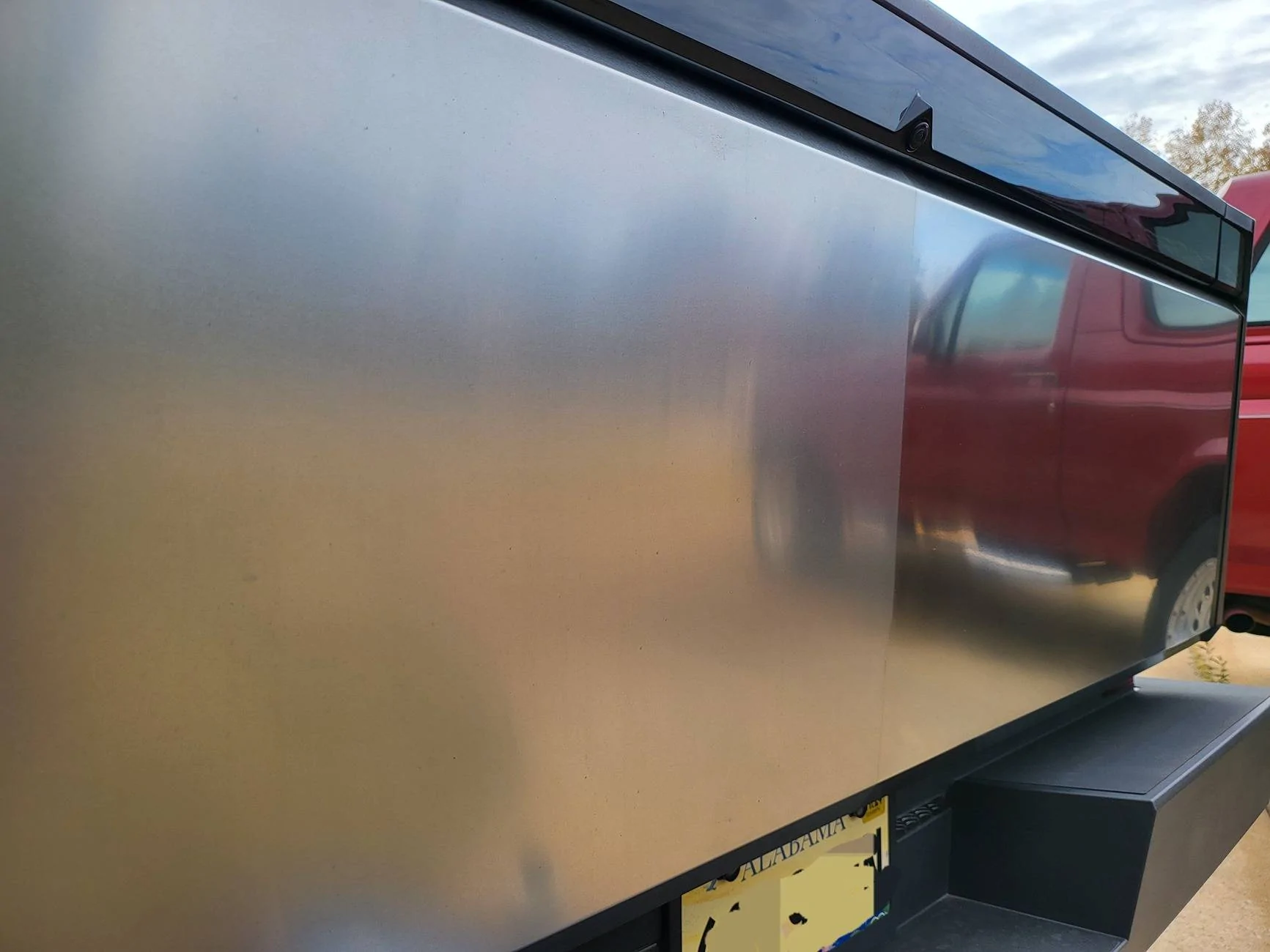

Comparing the passenger doors you can see the difference. Not a mirror though much shinier. My sister really liked seeing the project taking shape and so do I. Shine Bright ? like a CyberDiamond! ?​

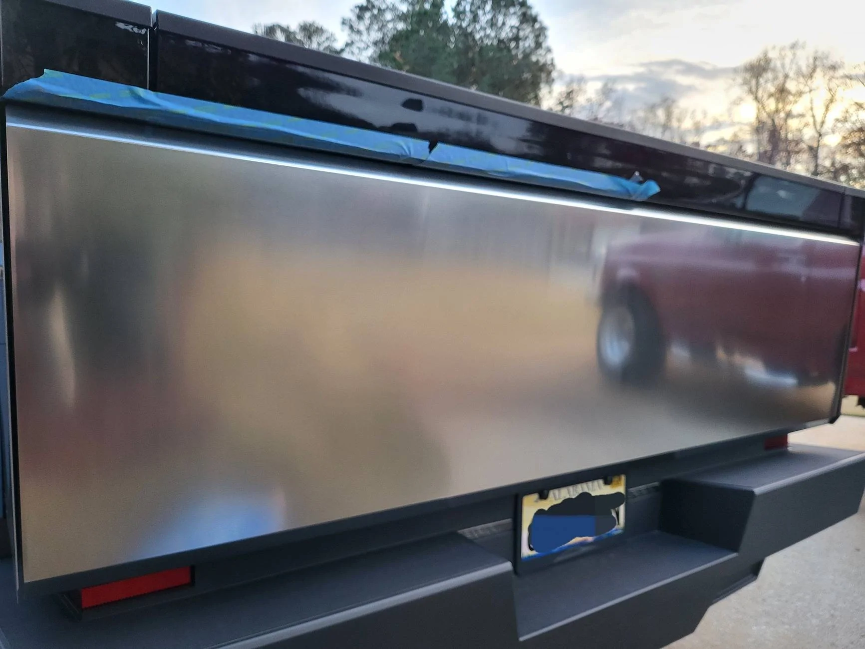

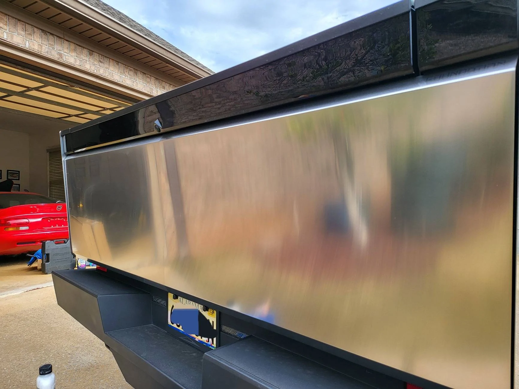

The White Diamond Metal Polishing project continues. Today I polished 007's tailgate with a before and after split to demonstrate the difference in appearance after 3 applications.​
Tesla Roadster 2nd gen "Shine Bright 🌞 Like a Diamond πŸ’Ž  "White Diamond Metal Polish" making 007 *Casino Royale* clean. 20241214_133400
This is how good the metal polish works to make the CyberTruck stainless steel shine like chrome. Apply it and polished it off. Do this three times to achieve this level of shine from the factory look.​
Tesla Roadster 2nd gen "Shine Bright 🌞 Like a Diamond πŸ’Ž  "White Diamond Metal Polish" making 007 *Casino Royale* clean. 20241214_135532
Apply a dime-sized drop of the metal polish to your pad. Rub the polish into the stainless steel covering the panel until it turns "black." Then use an old/shop cotton towel to remove it. Polishing off the residue is the hard part but reveals the stainless steel shine.​
Tesla Roadster 2nd gen "Shine Bright 🌞 Like a Diamond πŸ’Ž  "White Diamond Metal Polish" making 007 *Casino Royale* clean. 20241214_133423
This is a before/after photograph showing how shiny the stainless steel will become and the reflectiveness. Not a mirror but,definitely eye catching.​
Tesla Roadster 2nd gen "Shine Bright 🌞 Like a Diamond πŸ’Ž  "White Diamond Metal Polish" making 007 *Casino Royale* clean. 20241214_133436
Now, 007's tailgate is chromed-looking, bright stainless steel.​

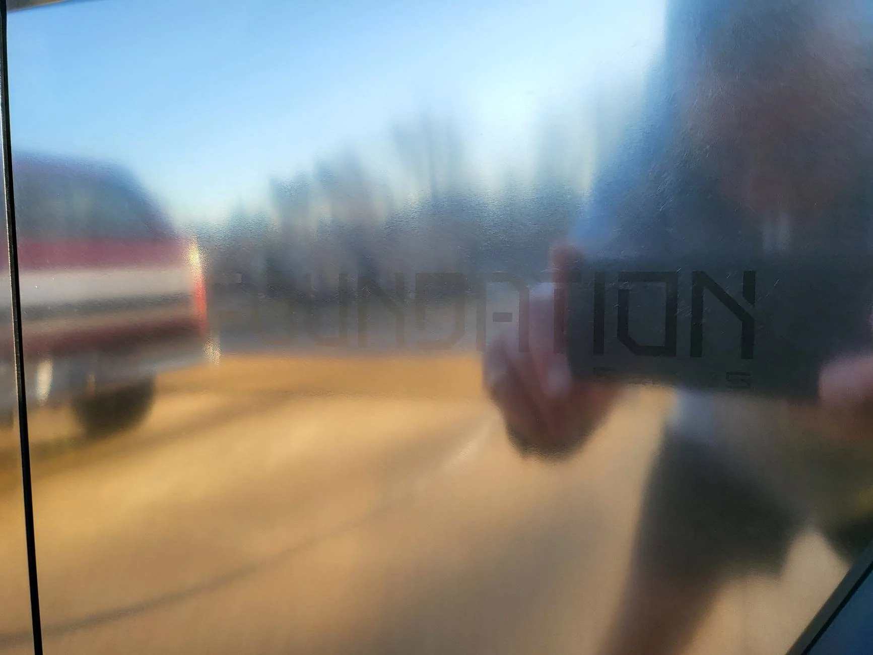

Making my way around to the driver's side of 007, the quarter panel compares to the doors and front fender contrasting *polished* vs *unpolished* factory finish.​
Tesla Roadster 2nd gen "Shine Bright 🌞 Like a Diamond πŸ’Ž  "White Diamond Metal Polish" making 007 *Casino Royale* clean. 20241215_174046

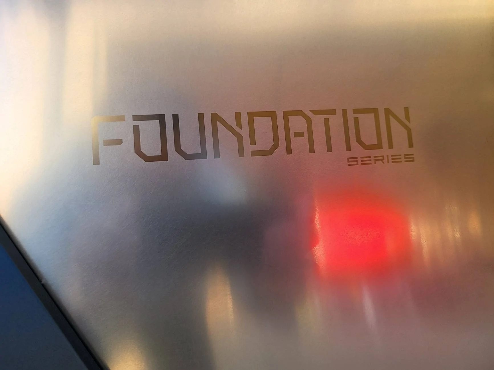

Polishing will fade the *Foundation Series* laser etching on the front fender and tailgate. However, it does not remove it and depending on the angle you look, it is still very legible.​
*unpolished fender logo*​
Tesla Roadster 2nd gen "Shine Bright 🌞 Like a Diamond πŸ’Ž  "White Diamond Metal Polish" making 007 *Casino Royale* clean. 20241221_152252
*polished fender logo*​
Tesla Roadster 2nd gen "Shine Bright 🌞 Like a Diamond πŸ’Ž  "White Diamond Metal Polish" making 007 *Casino Royale* clean. 20241221_152340

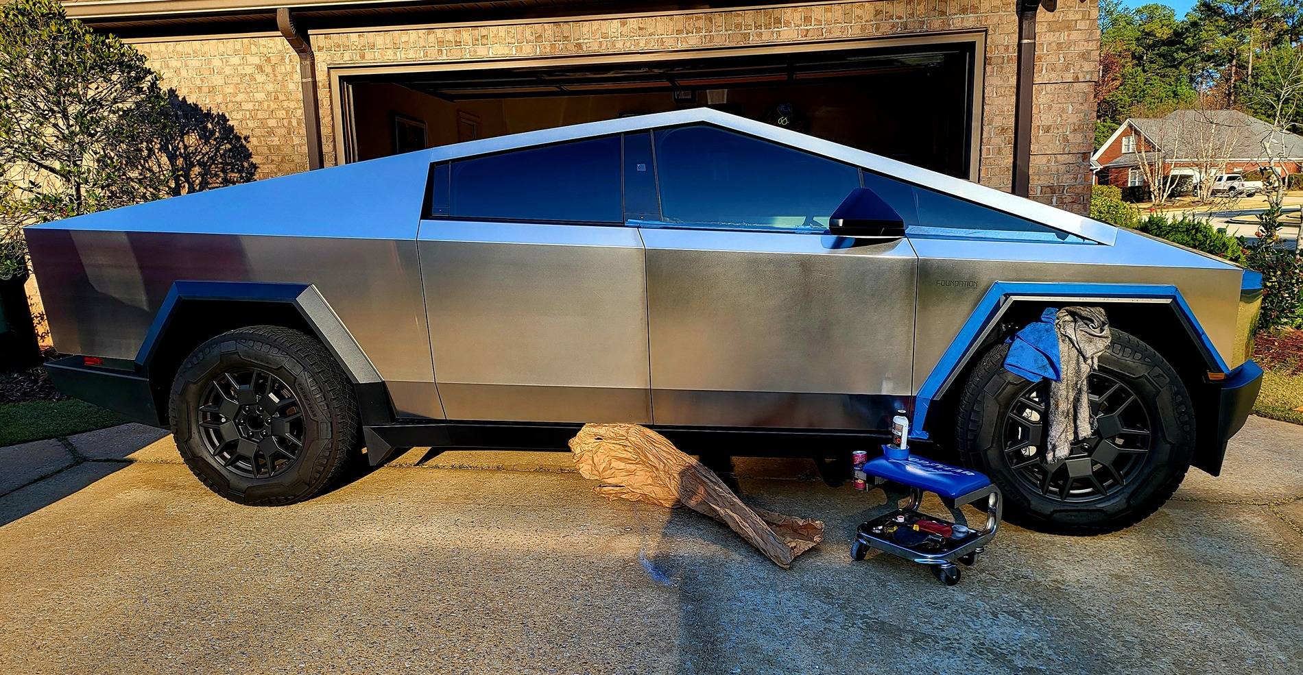

Moving along the driver's side door panels this is the reflectiveness you achieve with 3 applications of the White Diamond Metal Polish.​
Tesla Roadster 2nd gen "Shine Bright 🌞 Like a Diamond πŸ’Ž  "White Diamond Metal Polish" making 007 *Casino Royale* clean. 20241221_162612
Reaching the finish line, I've got to finish 007's front fender to complete his shiny transformation.​
Tesla Roadster 2nd gen "Shine Bright 🌞 Like a Diamond πŸ’Ž  "White Diamond Metal Polish" making 007 *Casino Royale* clean. 20241221_162635
Project *Shine like a Diamond ?* completed. 007 looks amazing and i can't help but think it should have been delivered looking this good. Not a mirror, but, a chromed-look with a deep silver brightness that just looks lux and jewel-like.​
Tesla Roadster 2nd gen "Shine Bright 🌞 Like a Diamond πŸ’Ž  "White Diamond Metal Polish" making 007 *Casino Royale* clean. 20241227_130441
Finally, I've completed this project working panel by panel for about 3 weeks in the rain and cold weather. Three coats applied and removed before moving to the next panel. I've also returned to some areas that were not as shiny as I liked, primarily the doors. There is a patina or film that is thicker and harder to remove than other panels. The CyberTruck's tailgate is the easiest to polish to a chromed-look finish. My hood and frunk have been polished five times creating a highly reflective finish.​
