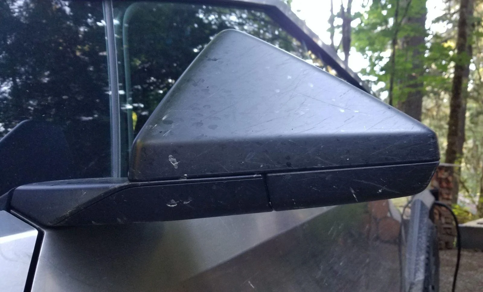

I'm afraid any type of plastic coating over the hard metal of the Cybertruck would be a diasaster for anyone who uses their trucks like I do. It lives a hard life, which is what attracted me to the hard frickin' steel to begin with. When your truck gets dirty, and then brushes up against vegetation, even at slow speeds, it grinds the abrasives in the dirt into the plastic.
This is after only 2 months use:
Tesla Roadster 2nd gen NEVR-DULL metal polish cleaner results…….. 20240613_074409adsm
Mirrors are known to take a lot of abuse, so they are molded out of relatively hard plastic. I'm glad they are not painted or coated with anything, or the scratches would look worse. Coating the hard frickin' steel with softer plastic coating is very unwise, IMO, unless your truck is just a garage queen that rarely gets dirty. Even then, the coating will fail due to UV exposure (even with UV inhibitors) and the results will not be pretty and the solution will not be easy.
I encourage people to think real hard before making a mistake they will regret. My truck has very fine scratches in the stainless panels, the reason they are so fine is because the steel is so hard. They will polish out very easily when I want to bring the truck back to a "new" look again, the same cannot be said for plastic coatings (and the scratches will be deeper and more numerous because these coatings are not as hard and durable as the hard frickin' steel.
Still, I'm interested to see your results, particularly longer term, so I'm not trying to shit on your experiment, I just want to warn people that all coatings eventually fail and then you have an even bigger job than the initial application to restore it.

I'll sub to this hypothesis. My CT is a regular creosote muncher, HFS is doing well, mirrors not so much. Tbh, I'm really tempted to just toss the mirrors and get the delete kit because I don't use them hardly ever, just finger clean your cameras on your morning walk around and I can see more than the mirrors can. Using the cameras takes practice, but the angle is so much wider

Do you use the mirrors often? Sounds like you'd be a perfect use case for removing them. I'm very hesitant to fully trust cameras
I'm super nervous about removing them too, but I probably will once I get tired of the mangled look or they get broken.
I've been practicing just using the cameras and I've made a few interesting personal observations:
1. It's a big trade off, you get a significantly wider angle on camera but also significantly less visible distance.
2. The visible distance on camera is more than sufficient for what's immediately around you but it's disorienting at first and feels unsafe. In other words it more than sufficiently covers your sphere of influence.
3. If someone doesn't have their lights on at night, you have no hope of seeing them on the cameras. But with the way the mirrors darken at night this is also true on the mirrors.
4. The cameras cover your rear and side blind spots perfectly. You know, that spot where a car is right next to you and can't be seen in the mirrors, but not level enough with you to see them out of the side windows either. On more than one occasion I have turned on my signal to be surprised to find a low profile car or motorcycle right next to me. The red blind spot indicators are also very effective at warning you. This has boosted my confidence in the cameras a lot. It also encourages me to use my blinkers more often to check my surroundings if nothing else.
I use the side mirrors quite a bit, I can see more and make better sense of what I'm seeing when backing down a narrow trail. The hazards and dropoffs are more visible. The cameras are great to check for traffic during lane changes and stuff.
