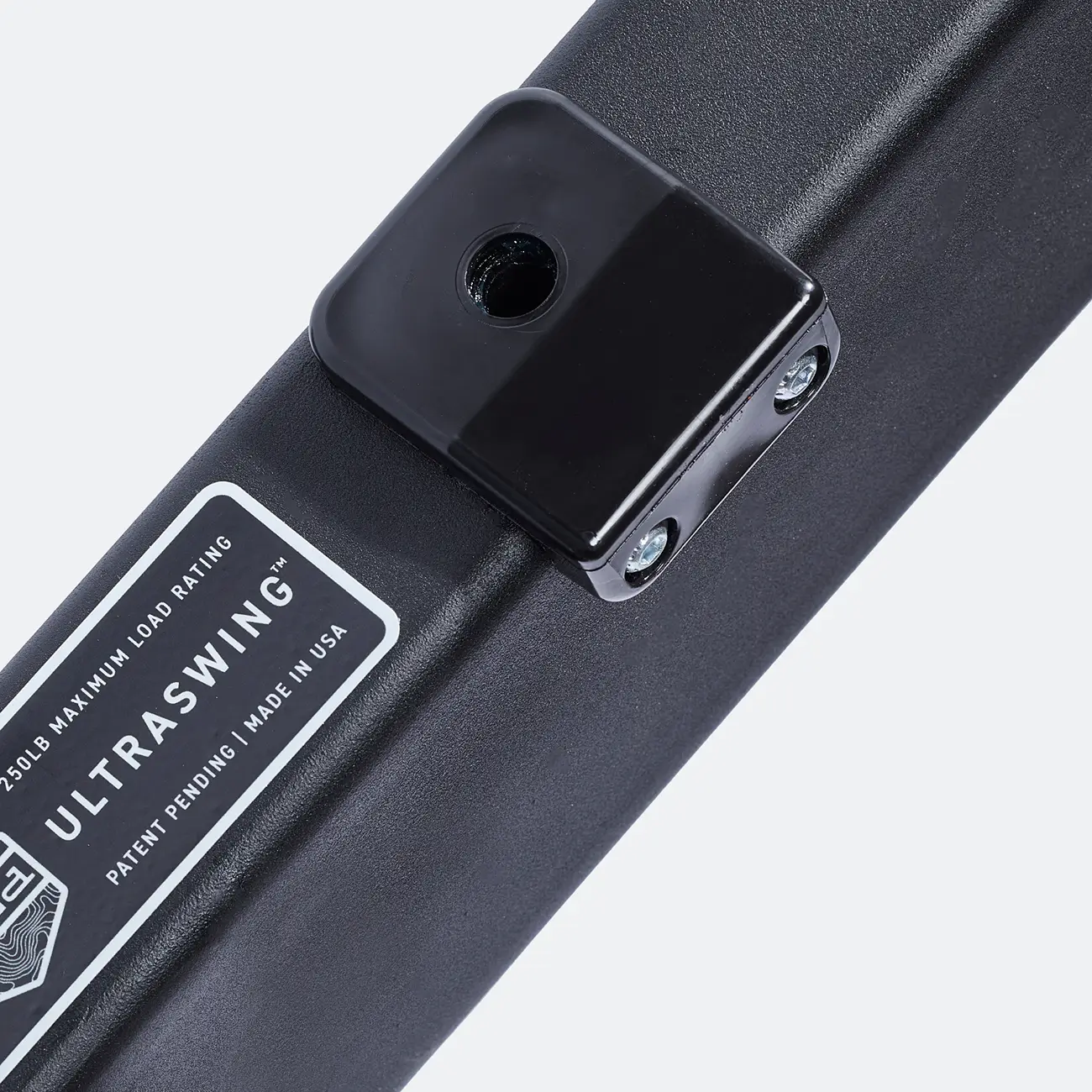

I was looking for this solution for a long time and wanted to share.
https://www.rigdsupply.com/products/cyberswing-spare-tire-hitch-mount
CyberSwing Spare Tire Hitch Mount
CyberSwing™ is our UltraSwing® hitch mounted spare tire carrier designed specifically for the fitment requirements of Cybertruck.
Carry a spare tire, camp table, bikes, and more with the CyberSwing™ spare tire hitch mount.
The CyberSwing spare tire hitch mount is a swing-out carrier designed for Tesla Cybertruck. With an adjustable tire carrier mount for up to 40” tires and an off-set swing-out hitch for bike racks and other accessories, the CyberSwing is purpose-built to carry all your rig’s essentials in one easy-to-use hitch mount.
Don't need a spare tire but want everything else? Checkout RambleSwing™ Pro
Features:
  • Tire and bikes swing out to access the rear hatch or tailgate
  • License plate light kit included with your CyberSwing purchase
  • Rock-solid anti-wobble design for severe off-road use
  • Hitch-mounted (⅝” hitch pin not included)
  • Adjustable/removable wheel plate carries tires up to 40"
  • Now featuring our UltraLatch™
  • Proudly made in the USA
  • Lifetime warranty
  • U.S. Patent No. 11,220,303
Technical Specifications:
  • Supports a combined weight of 275 lbs
  • Weighs 79 lbs with wheel plate
  • USA SAE J684-2014 Tow Rated lower receiver (Class 4- 10,000 lbs/1,000 lb tongue) & Australia ADR Compliant AS4177.1 for tow bars and towing brackets, up to mass of ATM of 3,500kg
  • Zinc Prime with a Black powder coat finish
  • Optimized fitment for Cybertruck
$1,850? Sheesh :-(

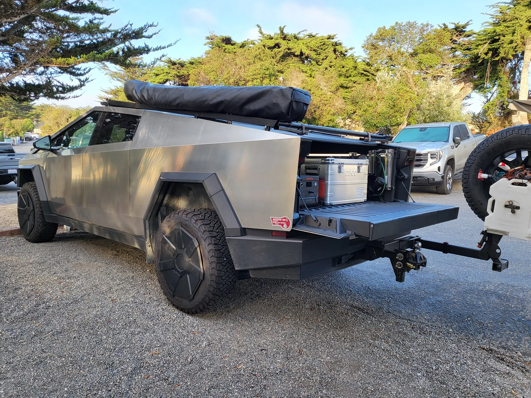

I moved my camera when I installed the Wilco Offroad spare tire carrier back in March 2024 by just disconnecting camera and rerouted the wiring harness which is long enough to reach the tow hitch and made a permanent mount on receiver which works with no calibration, issues, faults of any king and FSD works great still. Theres a post about it all somewhere here but it was easy to do.

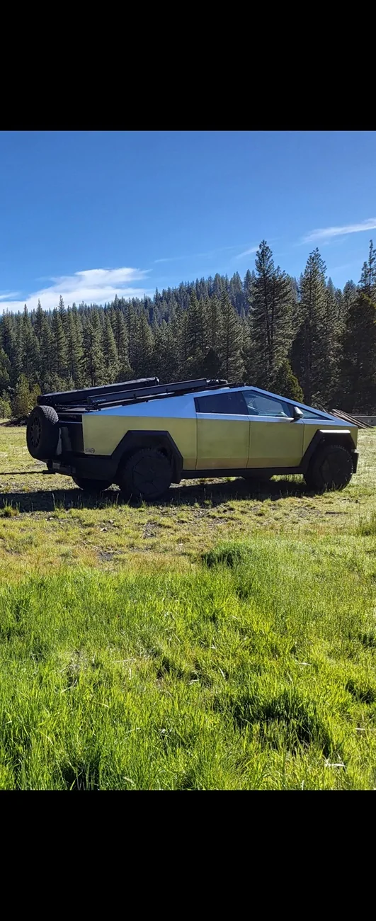

I moved my camera when I mounted the Wilco Offroad version of tire carrier with bike rack mount back in March 2024 to the top of the receiver using a 2x4 inch square stock steel tubing and put camera inside that to protect from basically anything. No need to add wire, just re routed the wire harness to the new location.

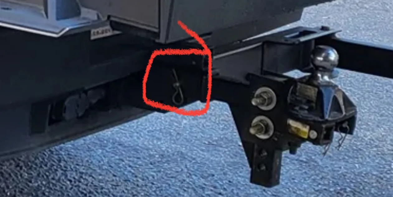

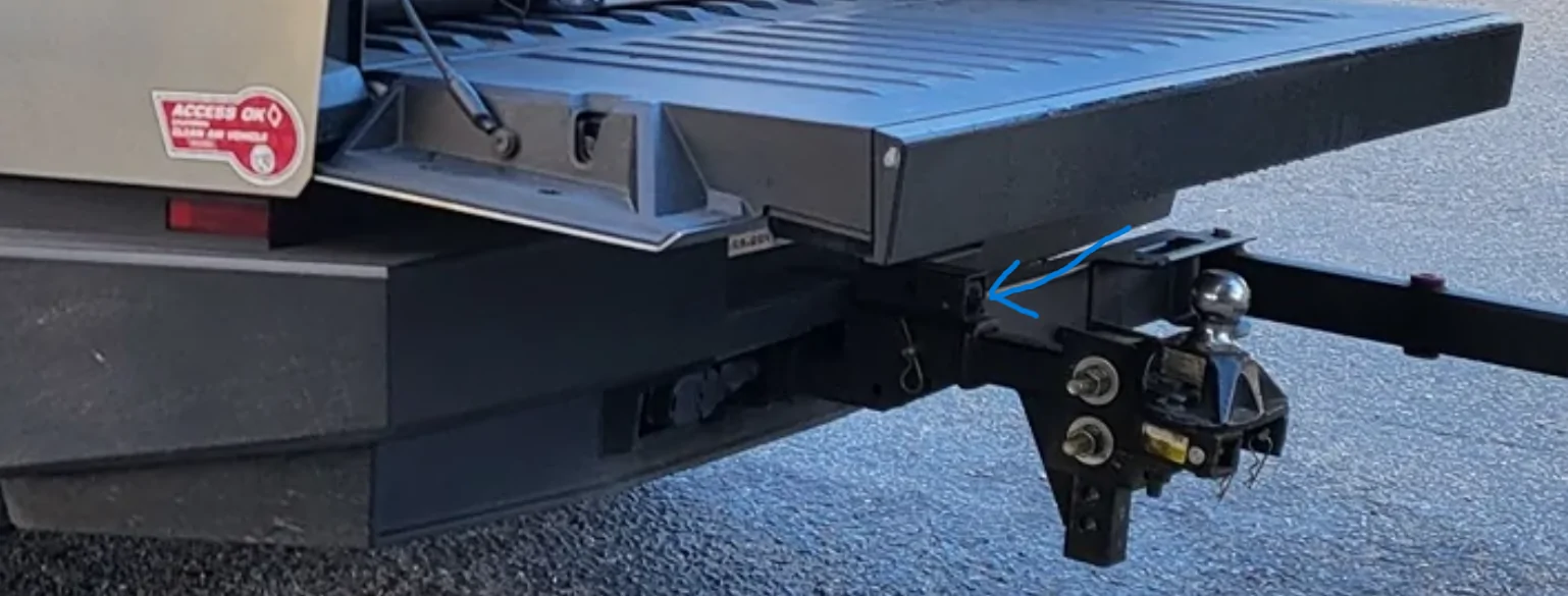

you'll see the 2 inch steel square stock I put the camera in on top of receiver if you zoom in. It was easy
