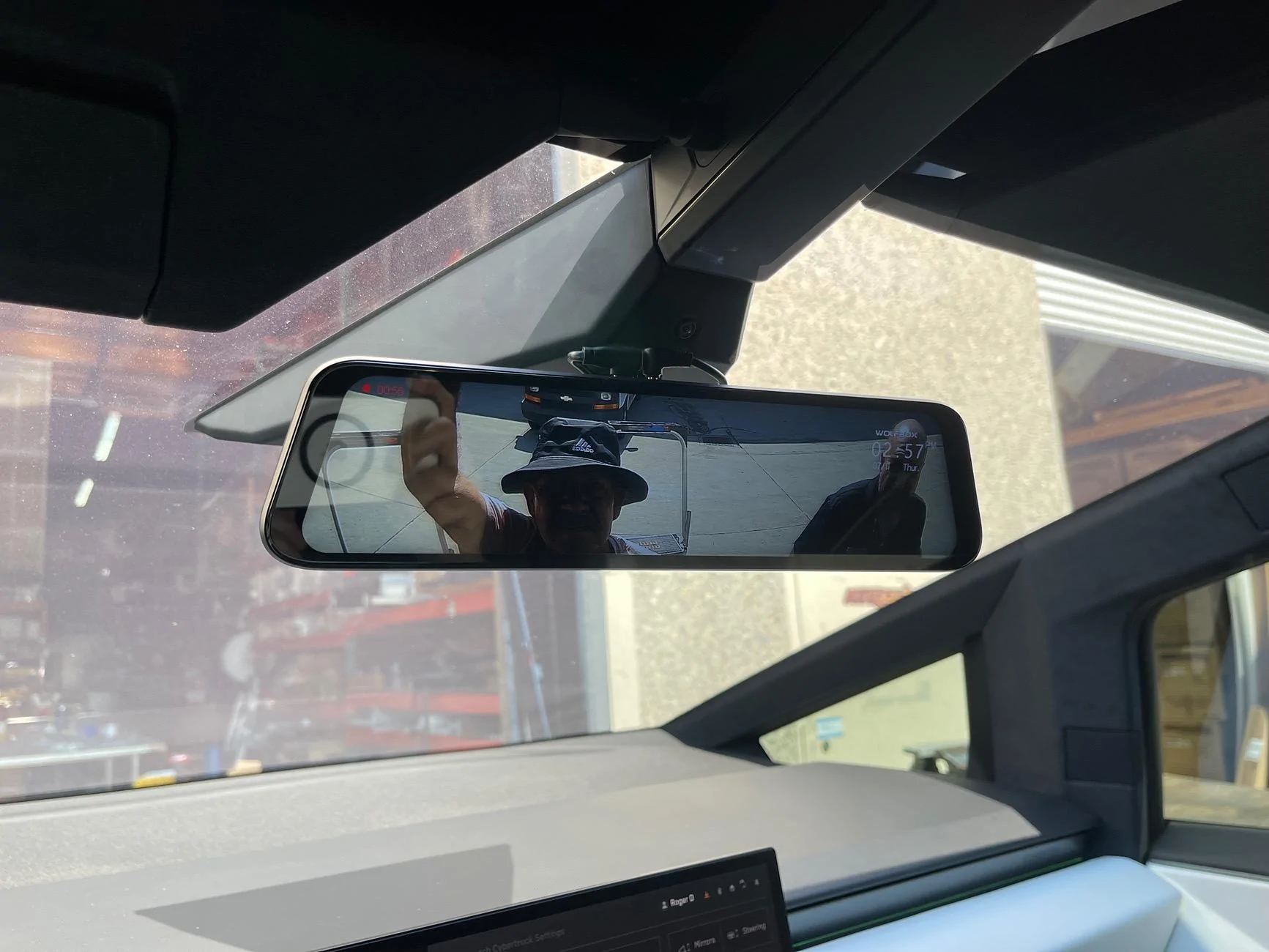

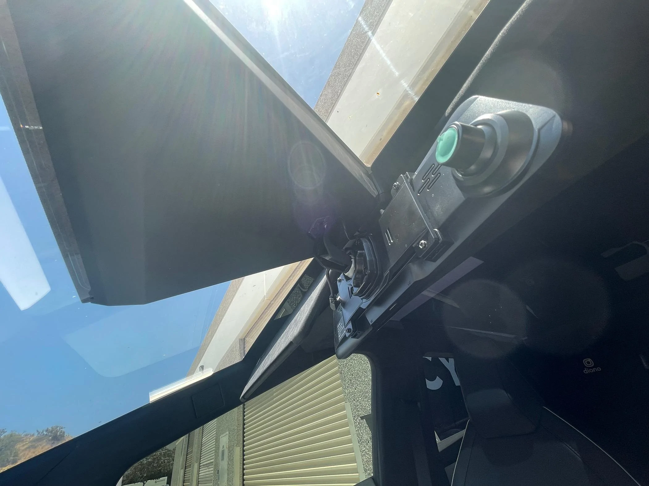

Hi All, bit different spin on the same ...
I'm ok with using the on screen rear view, but when I load dirt bikes (>1 which is most common), I have to leave the tailgate down and it doesn't work as it's pointing to the ground. I dislike the lil physical mirror as I'm sure most of us do...could use it because with bikes in the back the cover is stored so it could work with limited visibility. But....
I have a Garmin Zumo XT I use for long distance street motorcycle rides and I bought the Garmin BC 40 Wireless, Battery Powered rear view camera....installed the Zumo on the OEM Mirror 20mm ball and the BC 40 on the lic plate - now I have a rear camera view where a physical mirror goes and it works with the tailgate down!!!! Additionally, since Garmin it connects to my inReach sat messenger (no cell signal in Colorado mountains), topo maps, backup GPS, national parks/poi's/offroad/gas stations, etc extra "in mountains" functionality!
I dont plan on using all the time so didnt wire it to the Mirror 12v, nor the Truck USB-C (I may, we'll see)...it's quick release and I can charge off the USB-C in the center storage.
2nd Pic is with tailgate down....
3rd Pic is mounting - it all comes off easy (< 10sec), except the Tesla mirror arm.

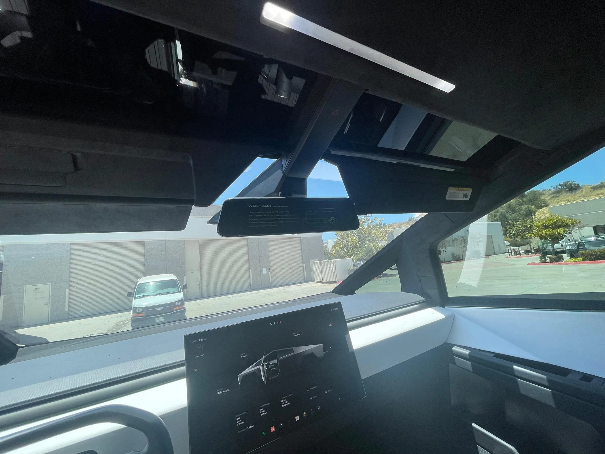

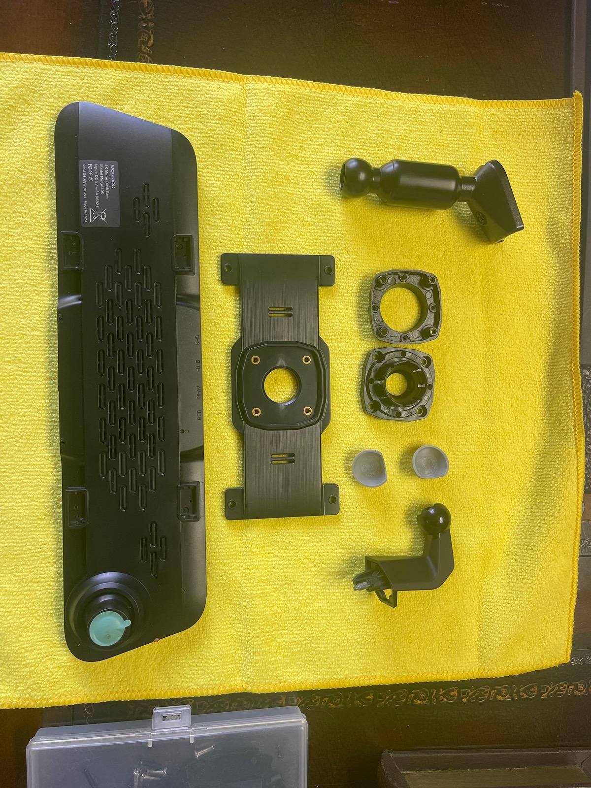

I just finished a similar install using the Wolfbox G900 mirror. I used the original Cybertruck mirror mount and the ball sleeve STL that CYBERTRUCKco generously provided. I opted for a license plate camera mount since I don't have a cap and preferred that over the hitch mounted camera some people have used. Overall, I'm happy with it, since the stock rear view bar on the center screen is just too small for me to make out detail and I don't like it vanishing when I use the turn signals.
A few downsides in my opinion:
The 12" mirror is a little too big, 10" would probably fit better, block view less and resolve some of the clearance issues with the top power and camera inputs. As is, the USB C power and rear camera 2.5mm jack rub against the forward camera housing.
The camera FOV appears almost identical to the FOV in the center screen rear view mirror bar. It's bigger so you can make our more detail, but I'd really prefer an option to narrow the FOV on the display or just a narrower FOV camera.
The display could use a day/night mode. It's too bright at night and the contrast makes it look washed out.
I'm hoping that somebody develops a digital mirror that intercepts and splits the stock rear camera signal and lets you adjust and crop the image onto a 10" or so display with a Cybertruck inspired design. I'd happily pay more for something that looks like a factory accessory with more focus on function as a mirror replacement rather than a backup camera (i.e. narrower FOV).
