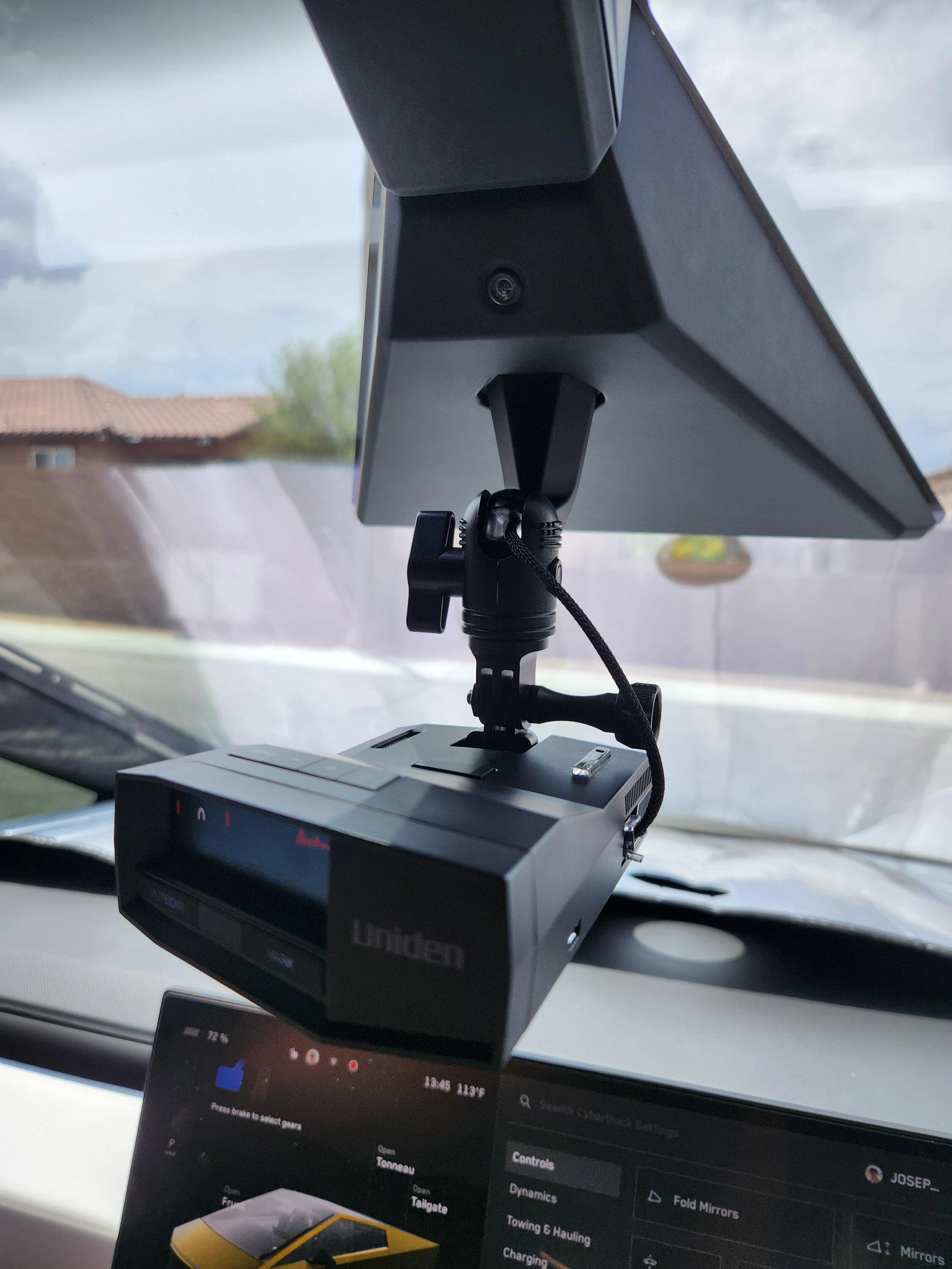

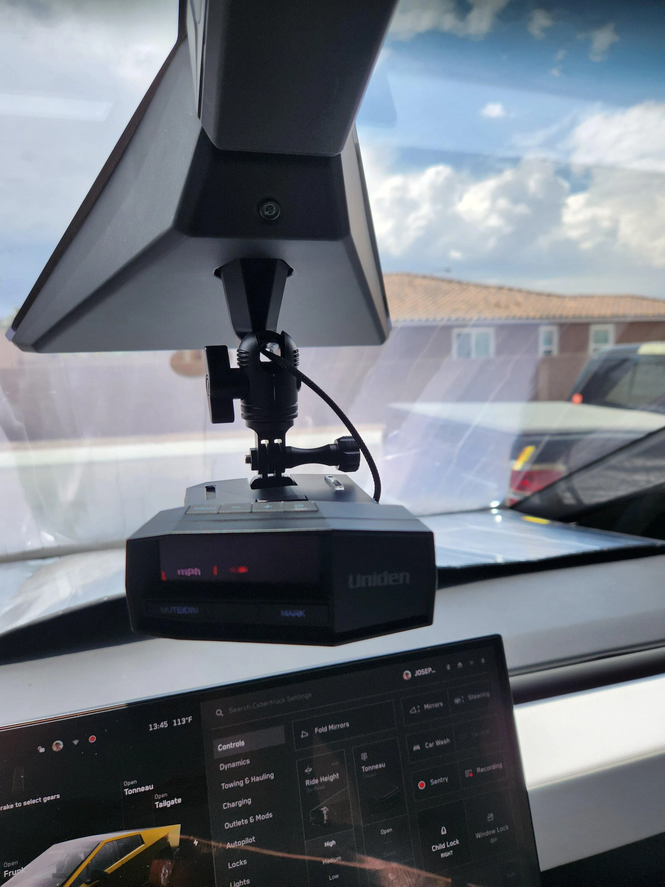

Replaced my mirror with my Uniden Radar Detector. Just pop out the mirror and and you have a 20mm ball. The ball has a channel where you can run the wires through and tap it into the red and black wires. I have a Uniden radar detector that came with a gopro mount which i used.
Attached are some pictures on how it looks and a screen shot of what the camera sees inside with it on.
Parts I've used :
Mirror Tap: https://www.amazon.com/MirrorTap-MT...mirror+ta,aps,467&sr=8-5&th=1&geniuslink=true
20mm Mounting ball: https://www.amazon.com/dp/B08295RLCJ?psc=1&ref=ppx_yo2ov_dt_b_product_details

I've seen these threads. I like the 3D printed arms, bit you need filament that is heat resistant. This is an option for the existing mirror arm.

Not sure I would like the detector hanging down that low. A cop may say that it is obstructing your view out the windshield. I installed mine up by the visor. Doesn't interfere with the visor folding down, and is up higher than what the rear view mirror was.
I have a front windshield the size of Vermont and I should fear a a ticket for having an obstructed view of the road? I don't know if that is even a thing but I am not gonna sweat it.

I’m retired police, so I can say if you get pulled over for any traffic violation, odds of a warning are slim when your radar detector is in plain sight. That’s a pretty common practice.

I tried to get one made like you did at pcbway but they said there were to many dividing lines after I converted the STL file to step. I'm not familiar with CAD do I didn't know how to do these things lol.

My cop friend said it's okay they won't pull me over for that here in Vegas. To much work for a secondary offense that doesn't look like they can write a ticket for. They won't pull you over here in Vegas unless it's a primary offense like speeding.
