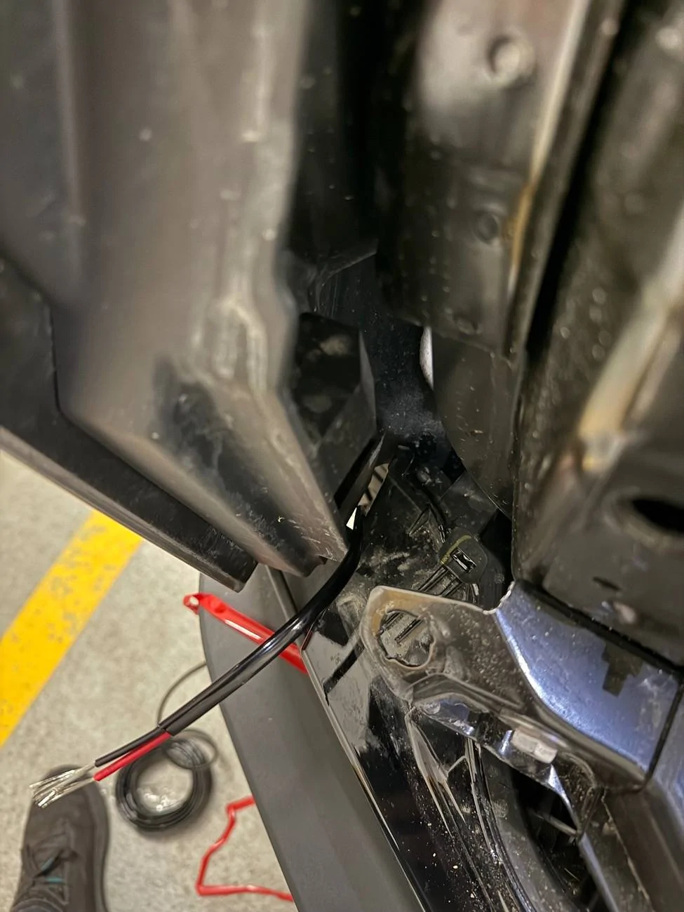

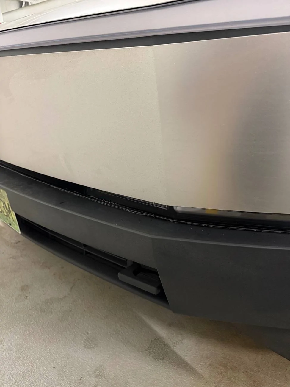

I will post my pictures of what mine looks like - Sorry the pics are not in order. If I find there are more questions than answers, then I will try my best to follow up with either a video or detailed post on this. However, I truly think it's pretty self-explanatory. It's a shame plans fell through with TesStudio as my hope was to create an easy to bundle package with everything a person needs in one box.
