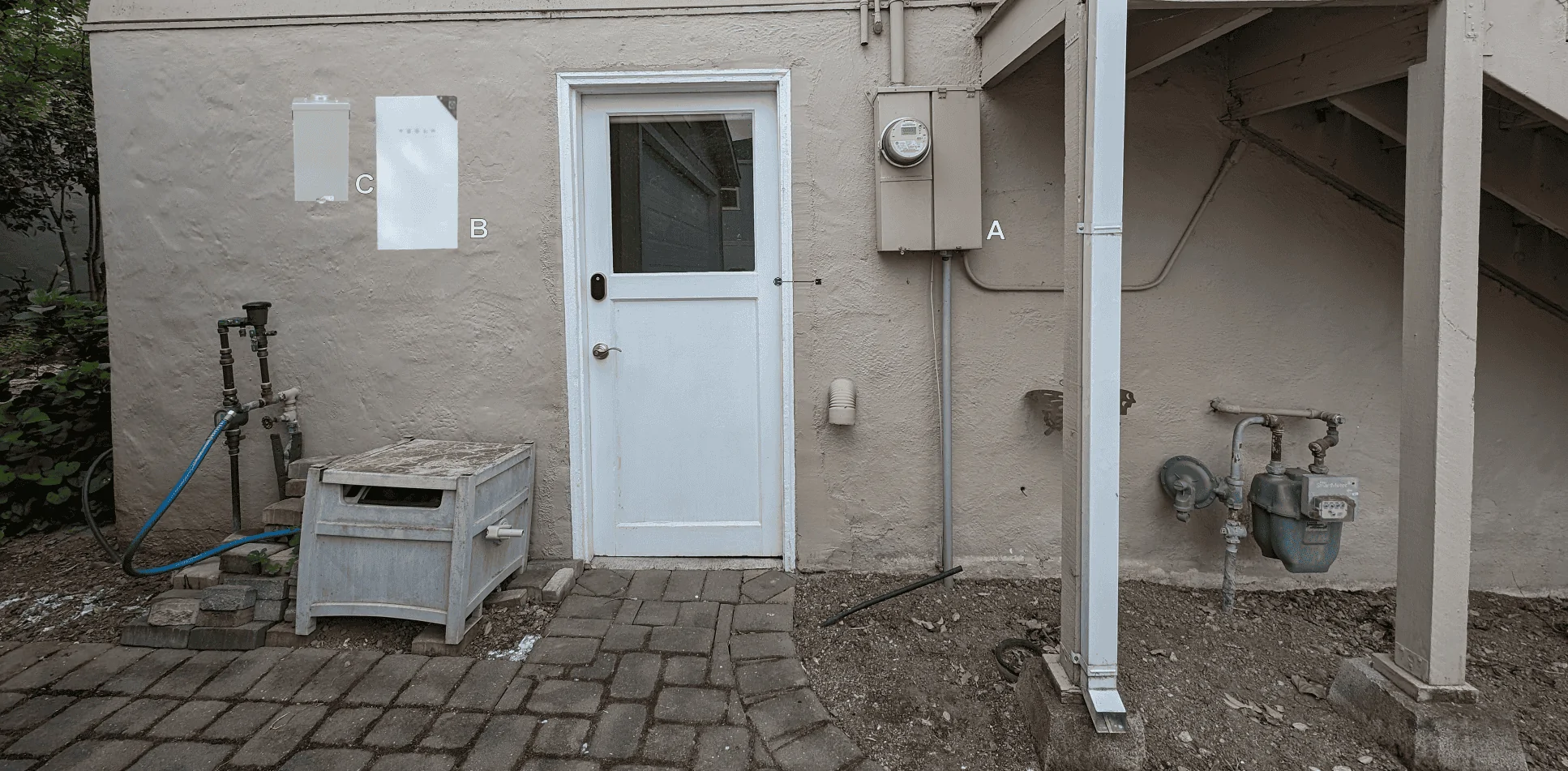

The first picture is where the mains go to the garage. I have 2X 200amp panels for 400 amps of service. That was there before the install.
The second pic is the panel but I believe the front of it is facing the wall. It is very clean.
Could I trouble you for the gateways dimensions?
I wanted to put it and the additional load center (they say I need?) under some stairs but the NEC Work Clearance area would be an issue and then the gas meter is too close. PG&E wants 3' on either side of the main gas line and a 3' radius around the vent opening for any new electric device.
I'm also hoping they can run the wires inside behind the enclosures.
