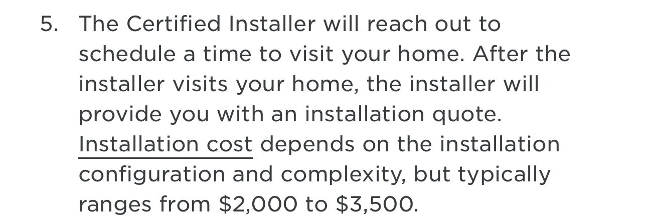

I received a quote for $5200 (Washington state), and immediately reached out to Tesla if I could get additional quotes. They provided me a link to the Tesla Certified Electricians page.
Even on the Tesla PowerShare FAQ page it states installation should cost between $2000-3500. A handful of electricians certainly seem to want to price gouge this install.
Tesla told me their minimum is $3500.
geez, sounds like Tesla might be trying to implement some price gouging for the installers and go against what their own website says.
