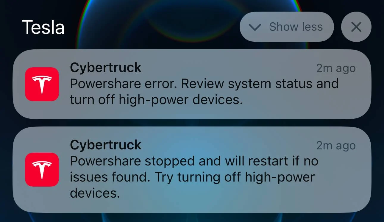

I've tried reaching out to Tesla via email about this, but haven't heard back. This primarily concerns a couple app errors I've seen on my phone at times, never during an outage I really notice, but it seems only during brief spikes where power blips out for a second, or several seconds tops. The errors are-
"Powershare error. Review system status and turn off high-power devices"
"Powershare stopped and will restart if no issues found. Try turning off high-power devices."
My Powershare for my Cyberbeast was completed months ago outside of Qmerit with a Tesla Certified electrician. As far as I can tell they did a solid job, load balanced for heavy loads on both the A and B legs of a subpanel that's downstream of the Powershare equipment (100Amp -> Powershare Gateway -> Subpanel). Per our calculations even though it's a heavy load overall, the load even under max usage is good.
When I analyze the power graph in my app when these errors have popped up (maybe 4-5 times now) I don't see power graph ever drop to 0. Up until yesterday, I never even noticed anything in the house actually show signs of a real power loss after seeing the errors, however yesterday there was clearly a short outage that was long enough to reset all clocks in the house, and turn off air purifiers that we normally run. Despite that, the graph still didn't show any drop to 0 for power usage, nor any output from the truck via Powershare.
Has anyone else seen these errors? Anytime I test Powershare from the panel by switching off the 100Amp breaker Powershare works fine. No errors, just flawless operation, and once I flip the breaker back on, it hands power back over to the grid without any problems. That said, I've never been able to catch an actual organic outage to verify the hand-off in that scenario, only a breaker flip.

Just had this happen with my Powershare system. Did not notice any grid power blip, surge or outage. Checked my CT and all looks normal. I've had this happen 2 or three times now. CT was not charging at the time this message showed up.

I had 2 notifications pop up today as well. We’ve had high winds and power outages in the area since yesterday, not sure if power flickered, but was showing we had grid power when I checked 2 minutes after receiving the notification.
I’ll have to check some things when I get home tonight.

I'm in western WA, too. Had the same winds, rains, and weird error notification. Power did flicker once or twice, but we never lost it long enough to trip anything. Maybe it was right at the threshold of the gateway deciding to switch?

Yep those are the exact errors I've been mentioning, and that I've tried to notify Tesla about as well. I've mentioned it to my electrician that installed everything too, but he's not sure what to make of it, nor has Tesla given him any feedback on it.
Has anyone who has had the error had an actual power outage to test that the system is working fine with a true powerout? I'd imagine it's the same as flipping the breaker main off, anytime I've tested that it worked flawlessly both taking over, and handing power delivery back over to the grid.

Got the same thing, they must have been testing something.
Also, my simulate ā€œoutageā€ button is gone in the app as well.

I had a 1 minute or so outage today, Powershare did not take over, I think because the truck was "Asleep". When I pulled up my Tesla app to see if it was in the process of delivering power and got the truck to refresh I saw "Communicating" as the truck status, but then the power came back on, and the Powershare errors appeared.
I'm not sure if this is evidence that these errors are more likely to appear if the truck meant to take over, but then didn't due to too small of a disruption, or what. This power outage (which I was home for) did cause all clocks to reset, whereas in previous incidents of the error they did not. Power outage seemed to be related to high winds.
Hopefully one day Tesla gives us some news on this. I also wonder if there's a possibility this could be related to Powershare Gateway updates, where it does a very quick reset? I saw that Tesla rolled out an update allowing solar to now work properly w/Powershare.
Oh also, my truck didn't used to say "Asleep", I would just see "Last Seen", so I'm not sure if that's something new as well which could delay handover of power.
