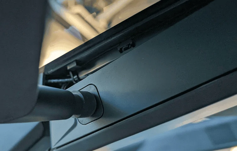

Well, my was one of the "fixed" overhead control consoles. After I got it from service, I pulled and pulled on the console really damn hard - it did not budge. I was really really convinced it got fixed for real. That was over a month ago. Yesterday at lunch I found the overhead control console hanging again.
I think it's the mounting bracket becoming pliable in hot conditions and allowing the mounting holes to ever so slightly flex out which, in turn, lets holding clips to eventually slip out.
My console is still holding in place much stronger than before service, but evidently more permanent fix is needed. I'm of the opinion that to fix it permanently, the white clips needs to be redesigned to have much sharper "holding" edge (red) and more outward spring force (blue)
They might also need to reinforce the mounting frame with some sort of add on bracket so it does not flare out. Here is a pic from the service manual and yellow indicates how mine bracket deformed just slightly:
This sounds spot on. Thank you. It happens more frequently after the interior has heated up in the sun. Sounds like this isn't really a DIY fix.
Thanks for the pics. I thought there were several small clips. After it comes off, there are lots of clicking sounds when pressing up in a few different places.
Mine tends to come off when I use the sun visors. It's too bad the magnets are not part of the base with the console assembly going around it. When the visors are used, it wiggles the console assembly around, which I think loosens the clips.

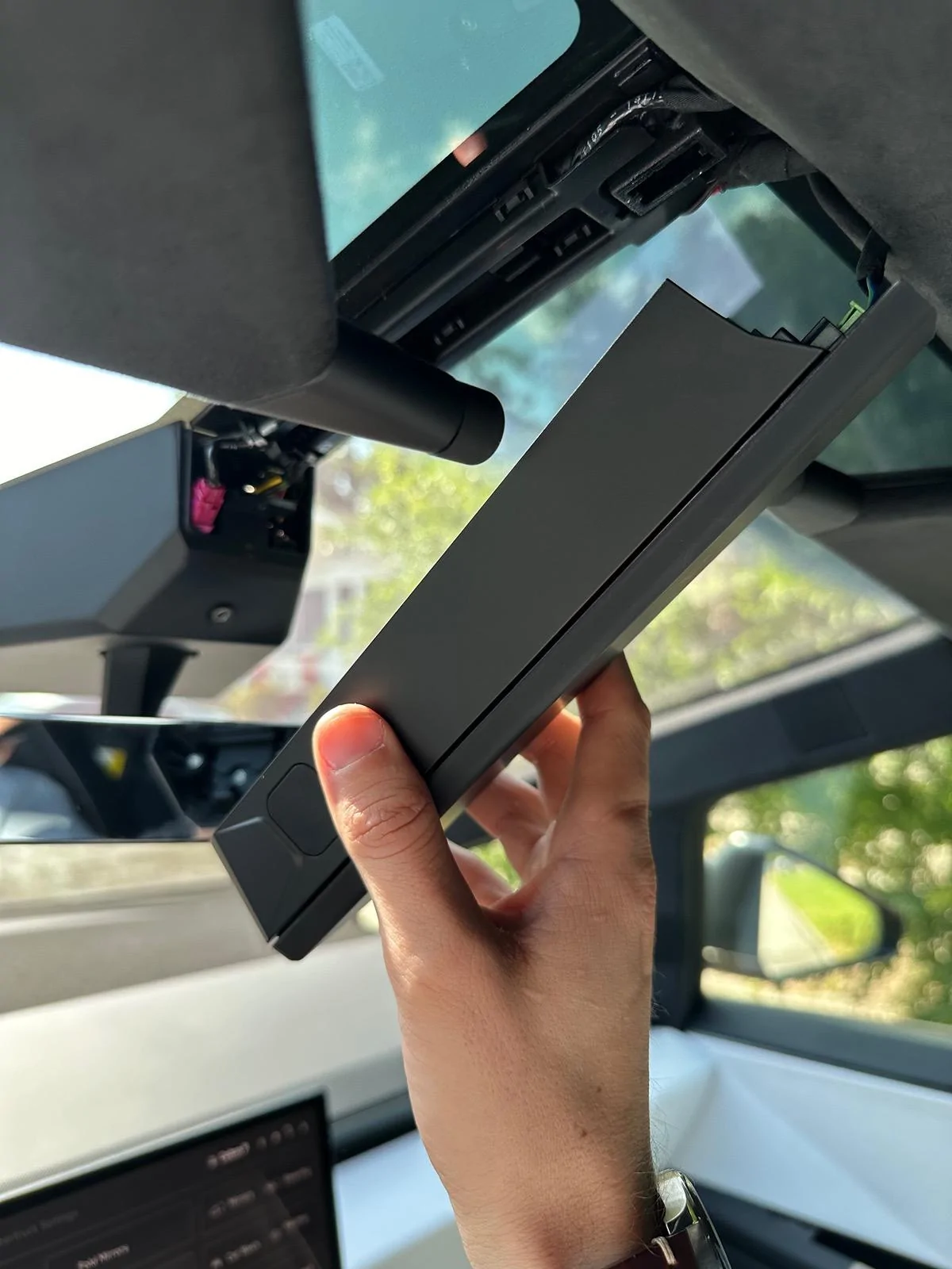

Over 90 days and still loving this crazy truck! Overhead backup shifter assembly has been a consistent issue. With the weight of two sun visors and the hot CA weather, this was an issue the SC couldn’t even fix with “3M Double side tape” ? The guys at SC are great and we all agreed it’s a learning process for everyone. Just came back from the SC and it’s 76 degrees, sunny, and the assembly popped out again less than 1 mile away from the SC. ? Seriously considering super glue at this point. ?
