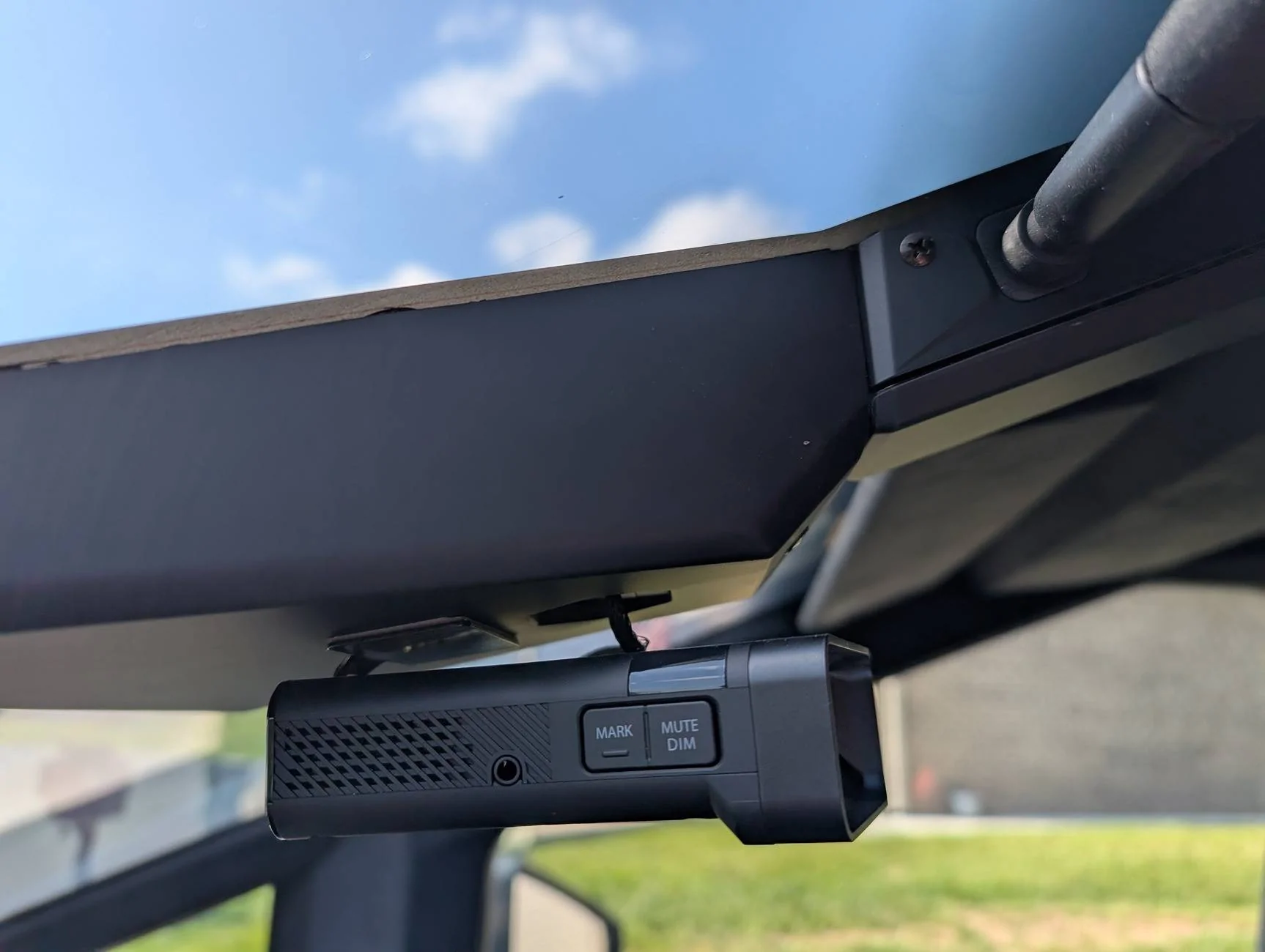

I got tired of my overhead gear selector falling off. I drilled holes through the front of the assembly that lined up with a support on the inside and attached the gear selector using 2 over head screws.
In the picture you can also see that I removed the mirror and attached a Uniden R7 radar detector using an inexpensive stick on bracket that I got from the jungle site.

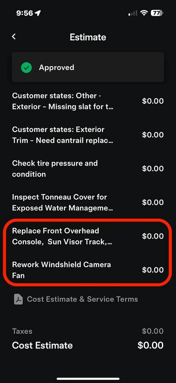

I'm not sure if this is related, but I recently opened a service request to get the missing slat added to my tonneau and the cantrail replacement, and service automatically added a couple of line items regarding the overhead console.
I've never had a problem with it, but I'm guessing it means there is an official revision to it:
Tesla Roadster 2nd gen Fix for overhead gear selector falling off IMG_3493
Looking at the linked invoice gives more details:
Tesla Roadster 2nd gen Fix for overhead gear selector falling off Screenshot 2025-07-16 at 10.04.40 AM

What size screws and what size bit did you use.
What size screws and what size drill bit did you use?
I used a black short #8 oval head screw. I would prefer a smaller screw but this was the only black screws I had. The size of the drill will depend on the size of the screw. Stainless screws are easy to get at Lowe's and will look fine. A pan head screw will be easier to use and will work fine. The plastic tab that I screwed into is thin so don't over tighten.
