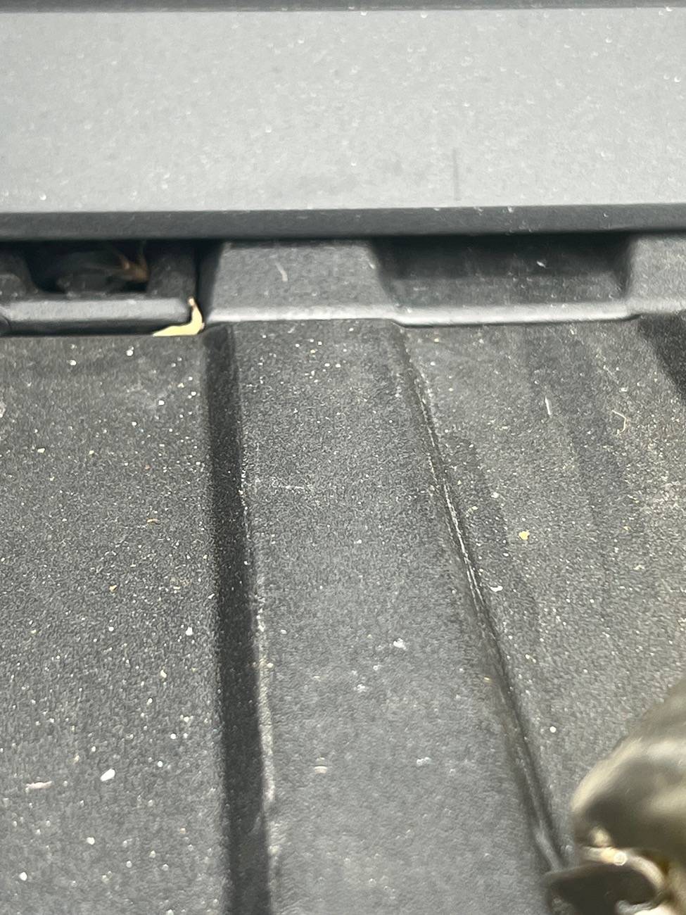

Now, one of the complaints I read was that the feet don't actually touch the bed because the divider is too tall - this seems to no longer be the case. I don't know if they shortened the entire divider or maybe just the bottom section, but with this installed the divider is clearly resting on the feet, not on the grooves of the bed. So I don't know how exactly they achieved this without holding the old design in hand, but the original complaints seem to be rectified.
Here's a photo I took of a scrap of paper slid between the bed and the divider. This demonstrates that it is not resting on the bed grooves, but planted firmly on the feet.
Tesla Roadster 2nd gen OEM Vault Cargo Divider now revised & fixed by Tesla! IMG_4847
