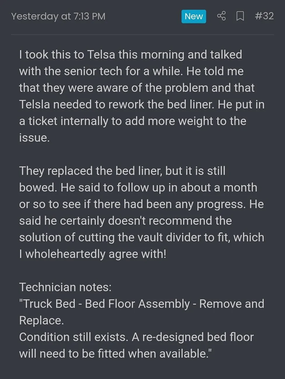

I took this to Telsa this morning and talked with the senior tech for a while. He told me that they were aware of the problem and that Telsla needed to rework the bed liner. He put in a ticket internally to add more weight to the issue.
They replaced the bed liner, but it is still bowed. He said to follow up in about a month or so to see if there had been any progress. He said he certainly doesn't recommend the solution of cutting the vault divider to fit, which I wholeheartedly agree with!
Technician notes:
"Truck Bed - Bed Floor Assembly - Remove and Replace.
Condition still exists. A re-designed bed floor will need to be fitted when available."
Technician notes:
Thanks for the update. There must be a batch of bed liners that aren't to spec. I messaged service and asked them about it but they hadn't seen the issue yet, but I assume it's coming now that more people are getting their dividers. Please keep us updated when you learn more.
