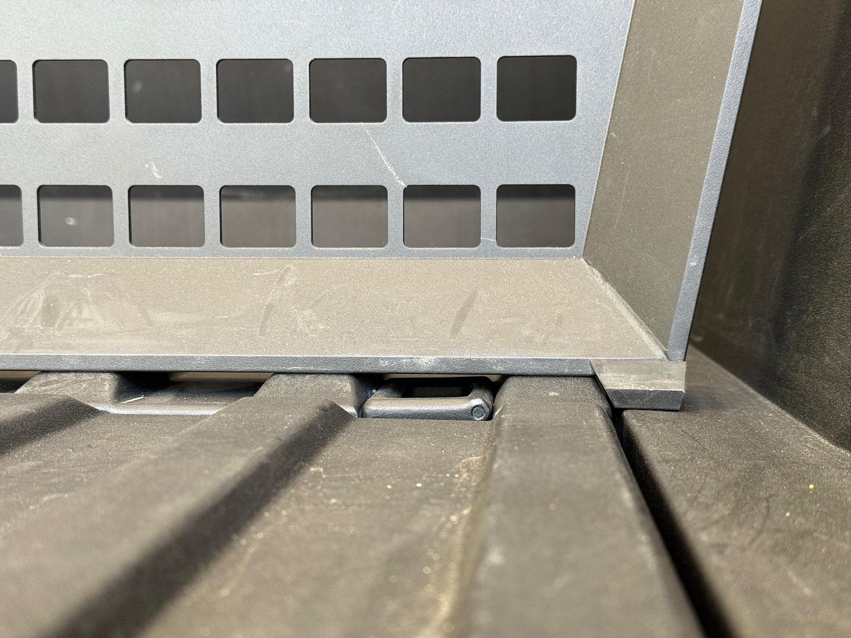

There is a known issue where some Cybertrucks have a bowed upward bed liner and therefore the Vault divider does not lock into the L-Track when used over that portion. If you have this issue, when you place the vault divider over the liner, the sides will stick up too high and will not fasten into the L-track. You do not need much force to lock the divider into the L-Track and should certainly not force it to lock into place.
Recommend putting in a service request if you are running into the issue. Tesla knows there is a problem and will replace your liner under warranty.
I have a request open for mine and will have it replaced next week (after a long wait due to personal and work travel).

Mine isn't bowed up but the bed (front and rear) is about 5mm too high for the divider to work as-is. Had to remove both feet and do Mark Z's modification to get it to fit. Even then it takes some effort. The divider now rests firmly across the tops of all the ribs when I manage to get it in place. So before cutting your bedliner make sure the tops of the ribs aren't the limiting dimension.
