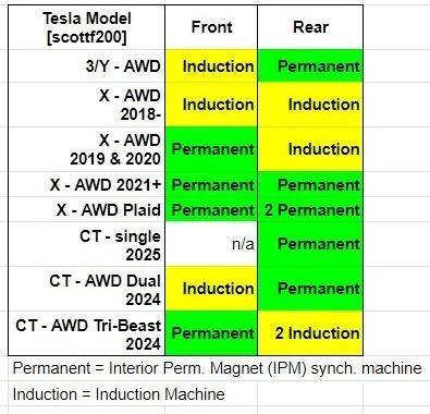

Table for visual:
Thanks for the chart. Would this seem to indicate that the dual-motor will be rear-wheel-drive while the trI-motor will be front-wheel-drive under light-load highway conditions?
My 2017 X with two induction motors still has a 'Range' mode setting. It uses the front motor in highway driving per ScanMyTesla app and CANBus reader. I would guess that front would be favored at the situation you are talking about for both. Permanent is a requirement for coming to a complete stop (one pedal driving). I don't have it but my kids TM3 does.

To follow up with more clarity. Kyle talks about the AWD Dual rear permanent being used for highway crusing and the front induction motor being shut off. The reason is the permanent motors are not able to be 'shut off' and still use some energy.
So in this chart, wherever you see the permanent for the single, dual, or tri-beast that is the highway cruiser. [Re: My TMX with both Ind. motors uses rear for "Range Mode" link]

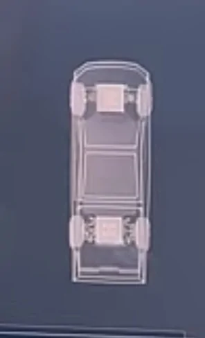

To let everyone know. The AWD FS comes with lockers front and rear. The Beast comes with locker front and rear with motors working simultaneously. Done. Word from actual owner. Tesla employee is their wife that's how they got it early. Woo hoooo!!!! OFF ROAD MODE you will find it when you get your trucks!!!

Well, coming soon! Dang it! Another Tesla software thingy. Looks like trucks are still in development and Jan to March won't be happening for us all.
Tesla Roadster 2nd gen Lockers -- What do we actually know? Screenshot_20240103_121520_Facebook
