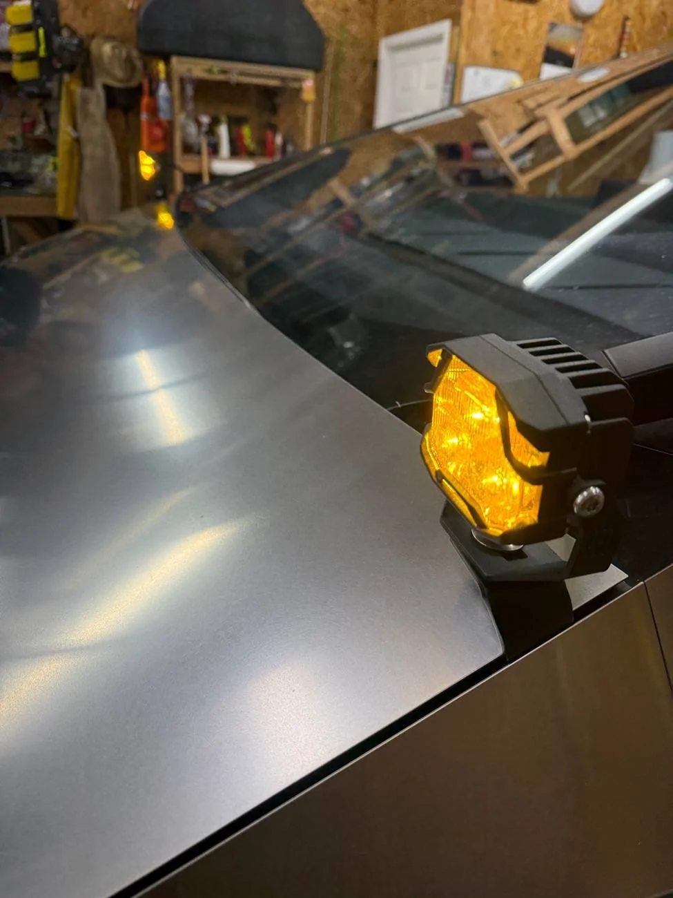

400 watts is not enough for a typical winch. So if there was something intended, it would likely be additional lighting.
Here ya go:
