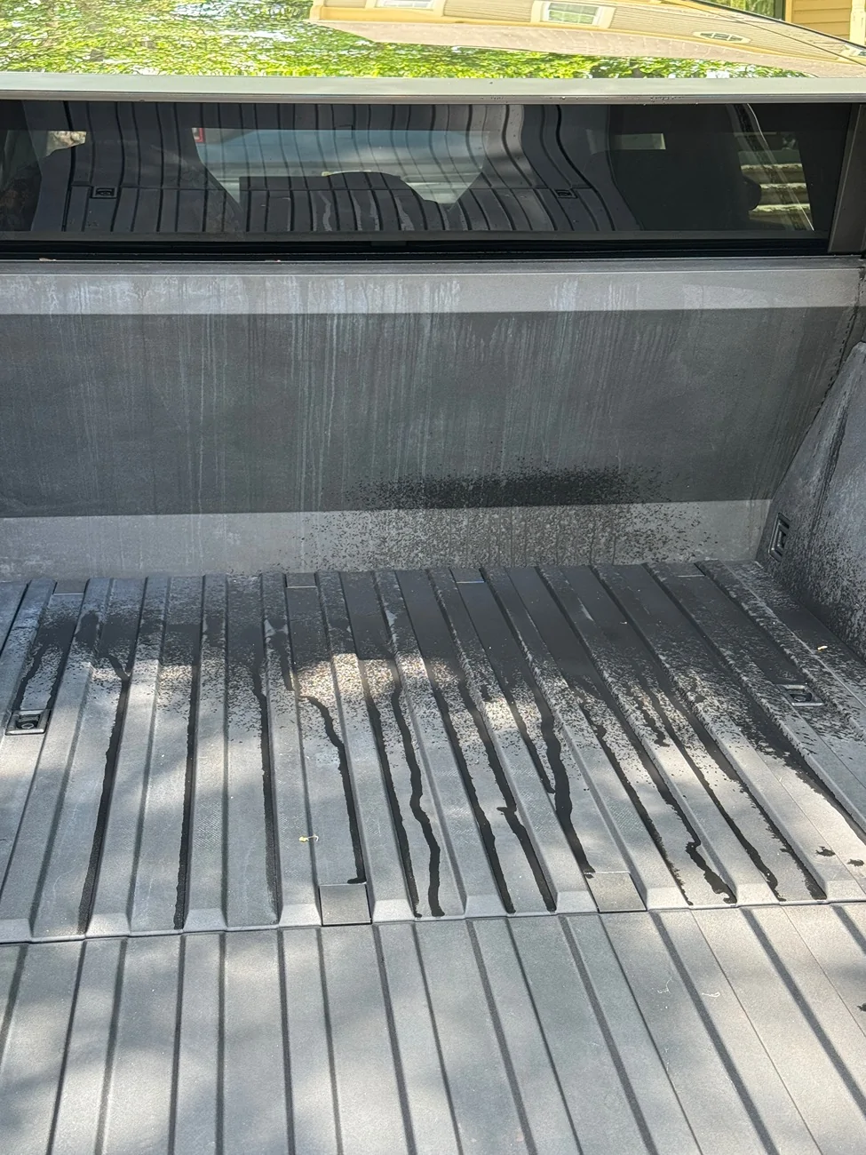

Does anyone know if the vault (aka truck bed) is a series of panels or one peice? Received my CT with severe oxidation stains from leaking water. I have tried to clean it to no avail myself. My next step is to try a detailer who might have better luck. If that doesn’t work, need to weigh plus/minus of replacing bed.

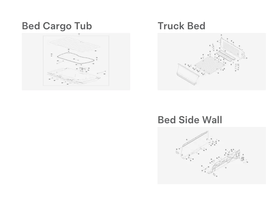

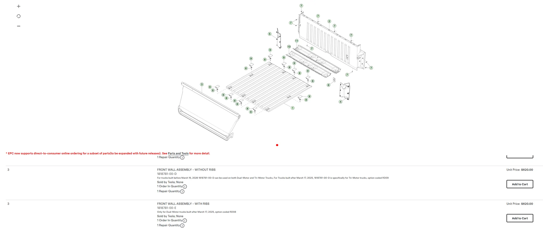

Wow, thanks! Any opinion on replacing the front panel?

I wonder if you can spray paint it?

Get it clean vinegar can do wonders if you let it sit for a bit then rinse off. After ceramic wax it or ceramic detailer will help prevent this type of stuff.
Meguiar's Hybrid Ceramic Wax on Amazon is $20. It can do wonders to keep things from getting water stains.
TEC582 CERAMIC DETAIL SPRAY (1 Gallon) on Amazon for a gallon is great also for $35. For the detailer you may need to apply it more often, but this is basically an area that gets wet when it rains or you go thru a car wash so it should be good for a while after application.

i used citric acid solution, but vinegar should work too. It's basically hard water stains.

I've seen it assembled on the production line and it was very simple outside the truck. It's lifted into the truck as an assembly. I'm sure it's a complicated process to reverse the install.
