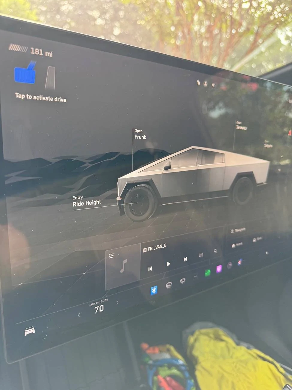

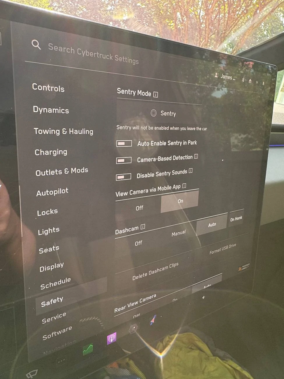

Is everyone else experiencing the loss of 30 miles a day my cyber truck with VIN ending in 8544 experiences this on a daily basis. Even when cabin overheat protection is turned off, and century mode is disabled the problem persists. Would love to hear if anyone else has had this issue and how they fixed it.

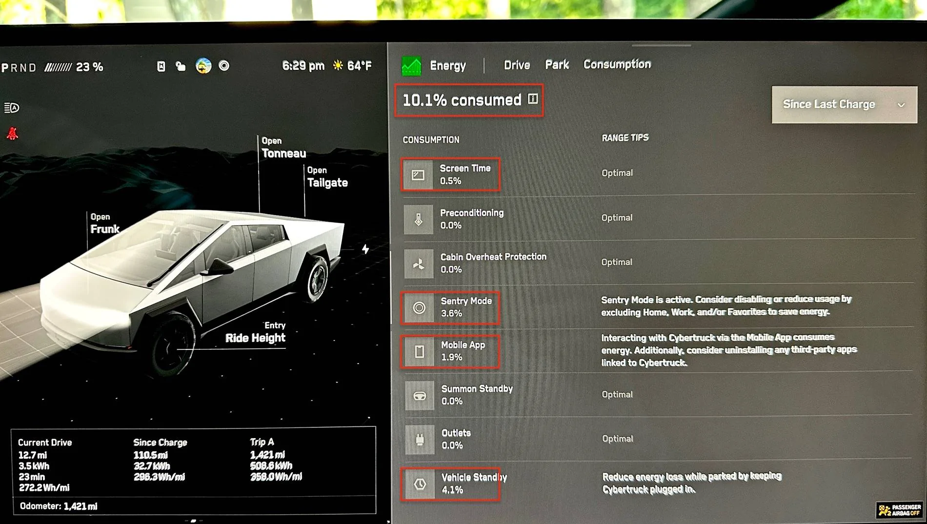

• I'd reboot, to make sure the vehicle takes your settings.
• Try turning off the View Camera via Mobile App. That drain might also partially default to Sentry. Notice the MobileApp is also showing some energy usage.
• Turn off the outlets.
• Lastly, your big issue is Vehicle Standby. To me, that's the fudge category. But, my experience is that temperature changes can cause the pack to lose estimated range. In particular, temperature drops.
Here's an example:
Tesla Roadster 2nd gen Excessive Battery Drain IMG_1246
After 5 days of driving, my truck has used 10.1% while parked. I've circled the 4 things that used energy and 3 are explainable. Yes, I have Sentry on when I'm at the gym. Yes, I used the app to check on my truck. Yes, I sat in the truck and fiddled with the settings.
The one I can't fully explain is Vehicle Standby, like you. But...
Tesla Roadster 2nd gen Excessive Battery Drain IMG_1245
that shows my 5 days of driving, separated by red vertical lines. I used 26.8% while driving. I used 10.1% while parked. That's 36.9% total. Is it right?
Yes. I started at 60% and it's now 23%, that's 37% with rounding. So, what does that mean?
It means, all my energy usage should be reflected on the above energy usage chart. What else do I know? I know Sentry is used at my gym, not at home, so any drops due to Sentry should be in the middle of my daily drive, when I'm at the gym.
The 4.1% drop due to Vehicle Standby should primarily be when the truck sits overnight. And, notice two big drops, where I've put blue arrows. Those are easy about 2%. What happened? In my anecdotal case, the temp cooled off more than avg on those two days, from the previous day.
When I start the truck, the BMS is calculating the pack size, and if it's substantially cooler, the amount of energy will be less, than the amount it calculated the day before.
That's my theory. Do you have warm days, and cool mornings?
