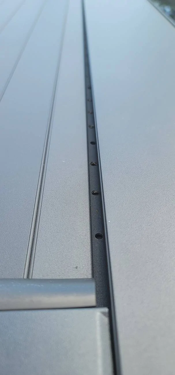

I don't expect it to be leak proof but I think this is my problem I hope they fix Friday.
There's a thread on this, but that's the design of the tonneau now. Almost all newly produced CTs are reporting being delivered with those holes exposed. 1 person had a SC say they would replace it, but most SCs are saying every single new CT is shipped like that and it's the new design.

The holes everyone is showing is not the cause of the leaks (at least in my experience). The URL reference posted above by docowen is a good source for where the leaks occur, and in that video you will see a very poor seal being replaced by rubber. My truck is a later version, with a rubber seal already upgraded as OEM from Tesla. However, my rubber seal also leaked, and when I removed the cover (and two bolts to do so), the rubber gasket was compromised by an irregular pattern in the metal border (see pic below) and that was my cause of leak on both ends of the metal piece I removed.
I put everything back together and used a silicone Permatex sealant to run a "caulk" bead down the gulley and that fixed my leaking Tonneau.
https://www.amazon.com/dp/B000AL6WLA?ref=ppx_yo2ov_dt_b_fed_asin_title&th=1
Tesla Roadster 2nd gen Does Your Tonneau Leak? 1727982123084-so
BTW, my Tonneau cover has exactly the same border holes as shown in other thread responses. On appearance it looks like that might be the culpret but it my case it was not.

When I picked up my beast (vin 20xxx, July), the tonneau leaked horrendously at the top. I made a service appt and, though they said leakage was normal, they replaced the tonneau. After replacement, I could see the metal strip at the top (see attached pic), and it leaked less, but still more than it seemed it should. Plus, the tonneau is a bit canted to one side when it closes - which you can see in the pic of the metal strip at the top.
I took it in again today, and mentioned the updated rubber seal I'd heard about on this board. The service tech said this was the first new seal update he had done (Fife, WA), and he was happy to learn about it. I asked about the uneven closing and he said he tried to calibrate it but it didn't fix it and engineering says it's within spec and not unexpected. Seems weird, but *shrug*.
So, I learned:
- The updated rubber seal is real, and relatively new.
- Tesla is ok with the slightly crooked tonneau.
- It's normal for the the metal strip with the holes to be visible.
Time, and rain, will tell....
