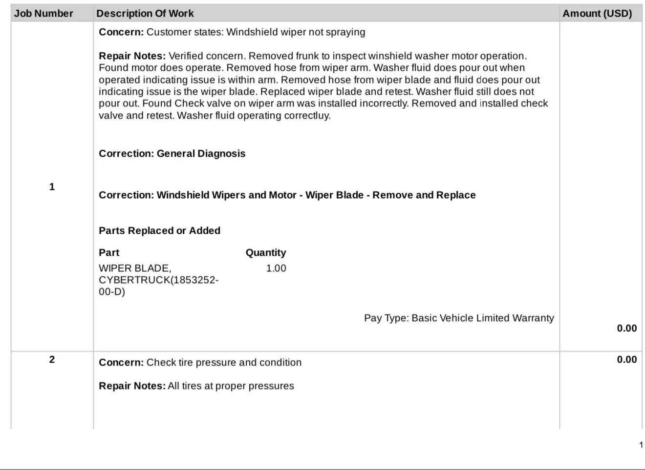

My Wiper is the worst part of the cybertruck. It does not spray or clean. i have to carry a damn long squeegee around with me. Guess thats what the frunk is for.
When I took delivery of my non FS Cyberbeast (2 months ago) my wiper didn’t work at all, had to get it fixed 3 weeks later, it’s fine now.
What did they replace on your wiper? The motor?

Agree! I also did the recall with motor and they replaced the arm and blade too. It's terrible and no matter how much washer fluid you use it still smears.
