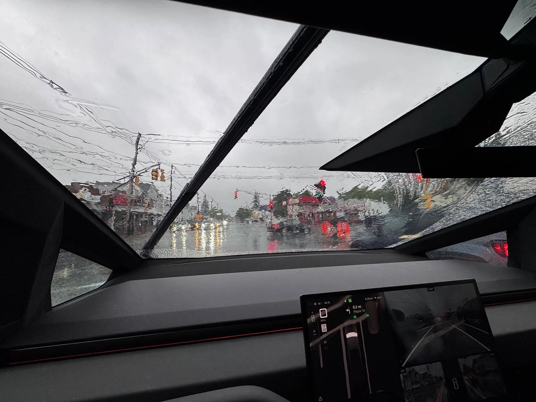

Just wanted to let people know that if you've had (or are getting) your wiper motor replaced, MAKE SURE the Service Center installed the new motor properly. It's outlined in the service manual: https://service.tesla.com/docs/Cybe.../em> <em>Motor</em> Homing after MV reconnect.
I had mine replaced back in February 2025, and the tech DID NOT install it correctly nor did he bother to test it or calibrate it. The signals for me was:
  1. When squirting washer fluid, it squirted when the wiper was going back up to the vertical position.
  2. When tapping the button to do a single wipe, it would do anywhere from 3 - 5 wipes.
  3. The blade never rested in the vertical position correctly (it was off by 5-10 degrees).
  4. When it went to the horizontal position, the tip was below the visible part of the windshield (it was wiping down too much)
  5. When hitting 30+ mph, the wiper shifts 3 degrees (which is correct for aero efficiency) but on mine it would be about 1-2 inches past the black tinted part of the windshield.
Now, the MAIN reason why I'm posting this is because last night when driving on I-93 in the Noreaster rainstorm we had in the Boston area, the wiper just broke and was stuck in the middle of my windshield. I literally could NOT see out the window. I only got home bc I was only 0.5 miles from an exit off the highway and was able to take backroads home...using the front camera and sticking my head out the driver door (like a dog) so I could somewhat see.
If I hit the wiper button, the motor would try to run 4 times but the wiper arm wouldn't move.
Note, the front camera can't be used solely to drive the vehicle bc the aspect ratio is not 1:1 (at least it didn't appear that way to me). It seemed I was at the stop light line but the camera was showing me 2-3 feet before it (admittedly, this could also be bc I was overly cautious!).
This is what it looked like at a red light with my wiper stuck.
Tesla Roadster 2nd gen Windshield wiper behaves erratically IMG_5443
