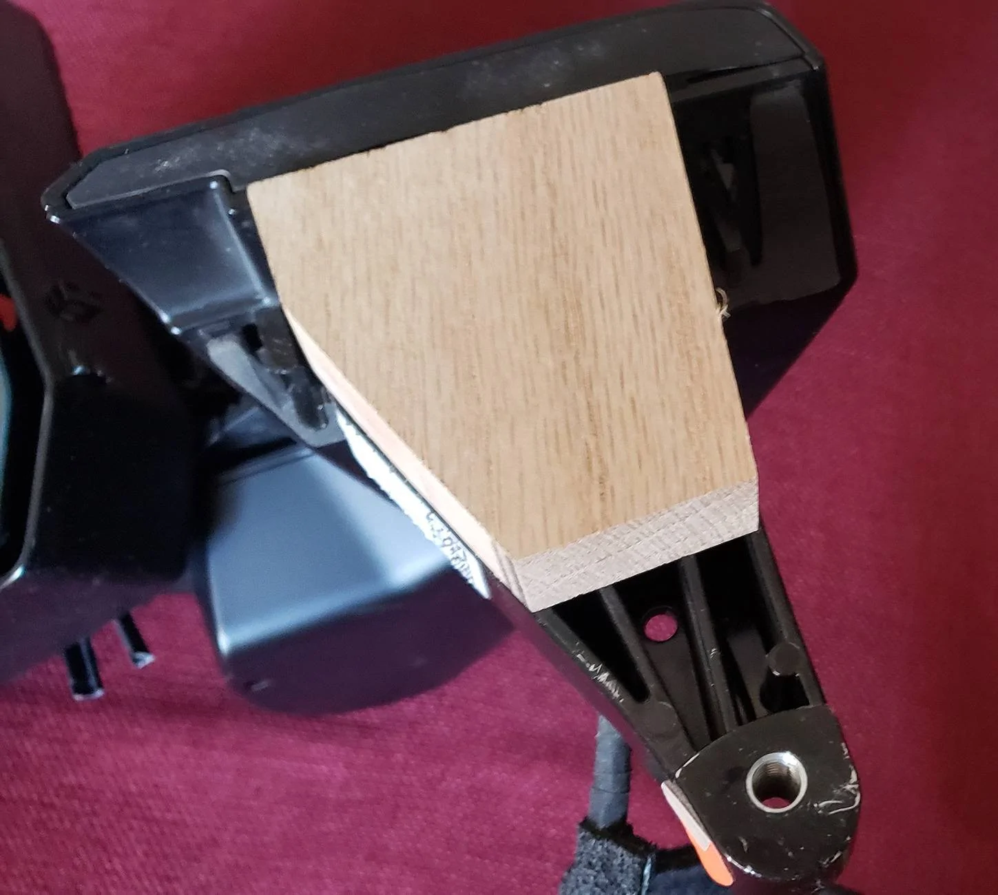

I made the support from pieces of 3/4" oak board I had lying around. I measured the angle of the top section of the door at 10 degrees and cut oak support blocks to that angle on a miter saw.
I used the mirror as a template to mark the next two cuts.

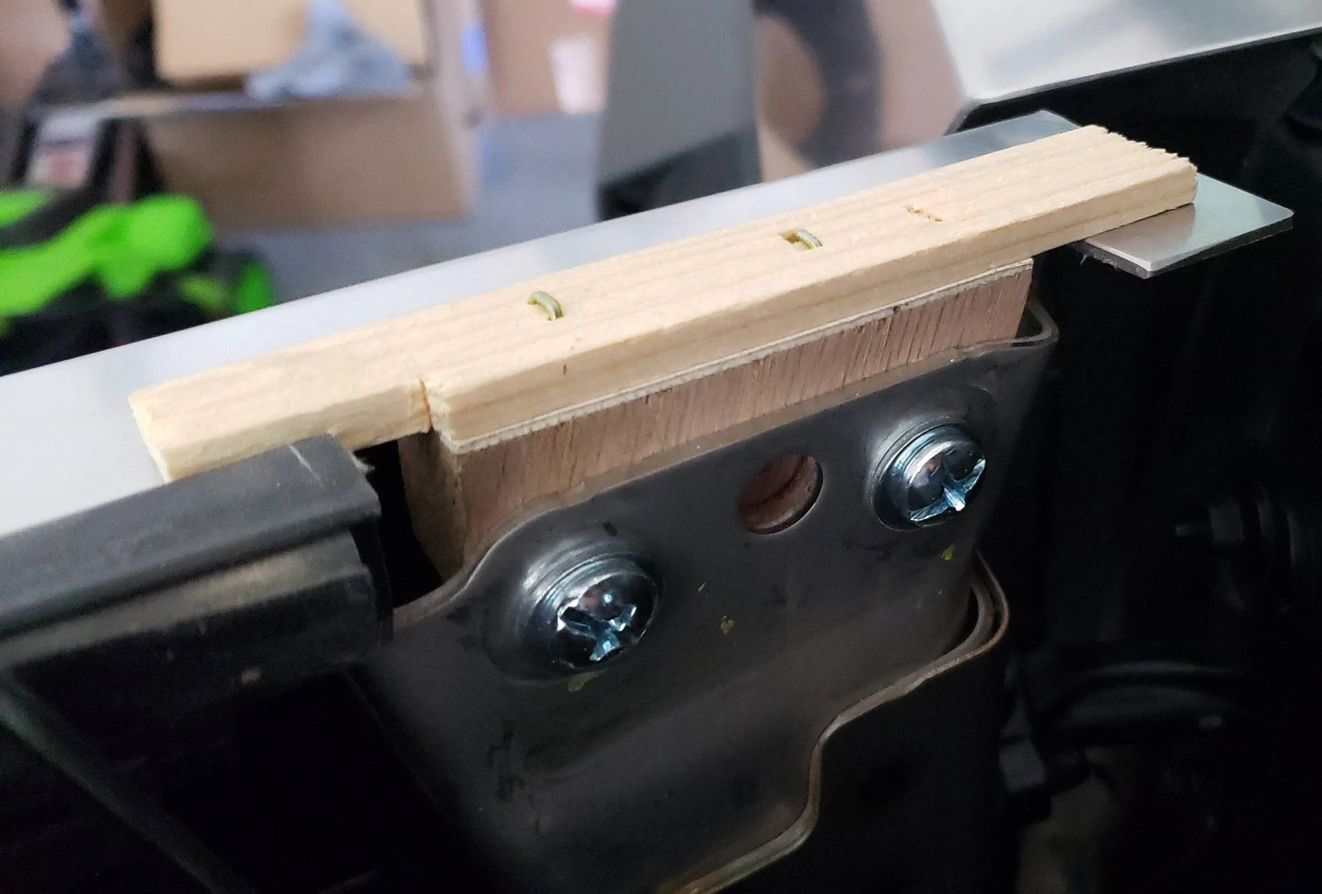

I put several layers of artist tape on the top of the block to match the thickness of the SS card, then stapled a piece of wood across the top to hold the block in place to mark the bolt holes. I drilled two 9/32" holes and hammered in 1/4" pronged T-nuts.

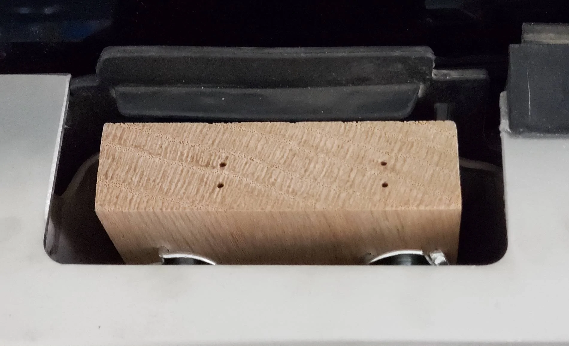

This was then bolted into the Cybertruck door. Note the recess drilled into the wood to make room for the rubber cover's attachment plug.
I then removed the wood strip, staples and tape. What remains is a solid, flat surface to which the SS insert can be glued.

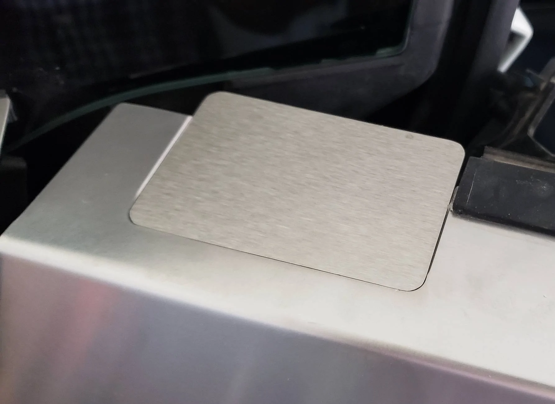

As you can see, the SS card fits the hole in the door almost perfectly.
I only have to cut off the excess material along a straight line to align with the edge of the door.

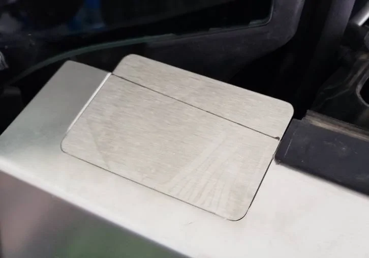

I then used some Gorilla Glue to glue the SS piece to the wooden block. The block can be adjusted a little to get a flush surface.
The SS card is finished with a course brushed surface so it doesn't blend in with CT's surface perfectly, but I don't find it objectionable.

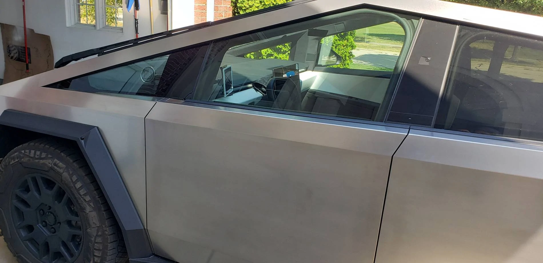

I will do the passenger side the same way.

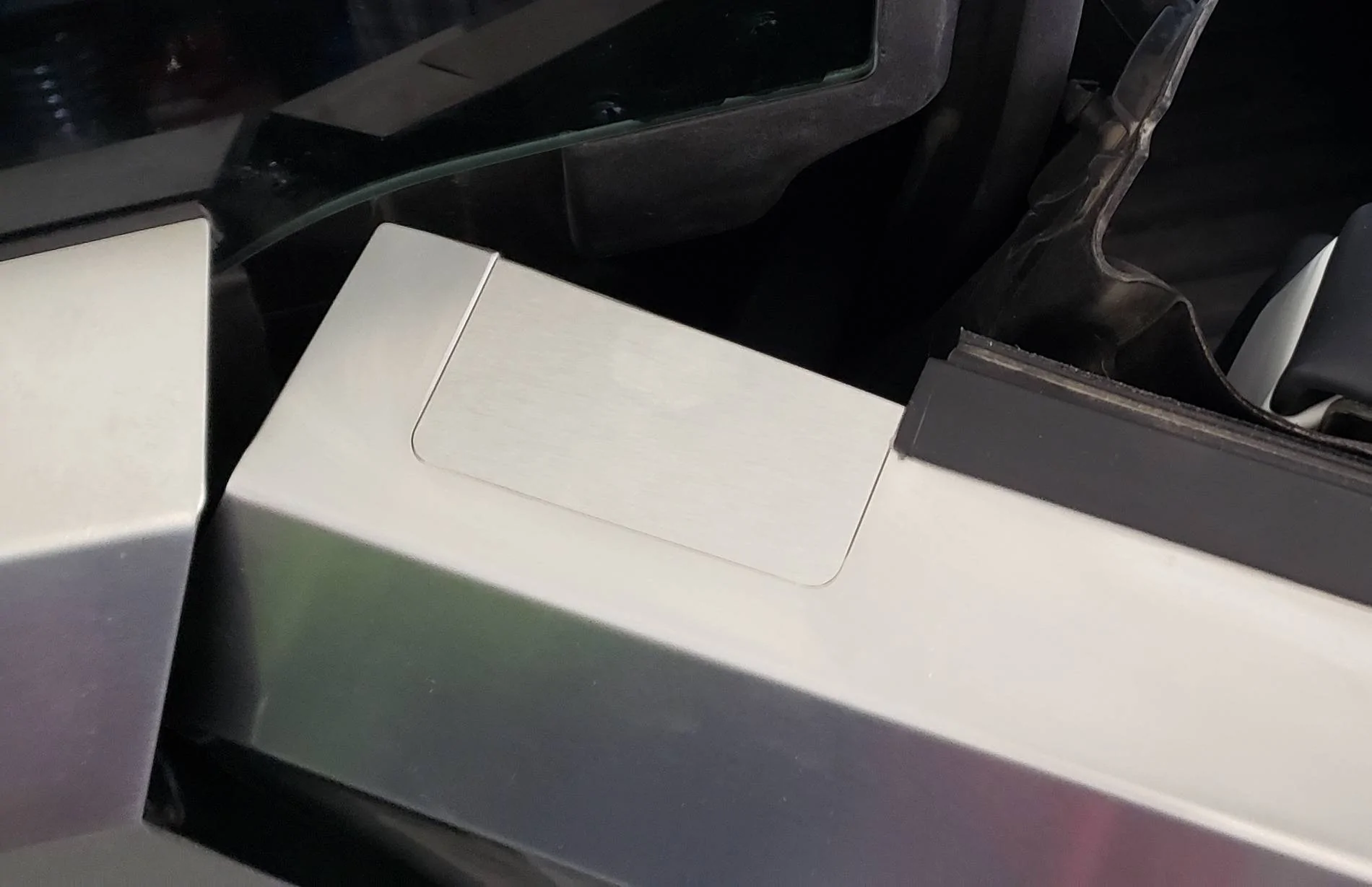

Here's a view from a distance. Not bad. Some rubber trim would make it even better.

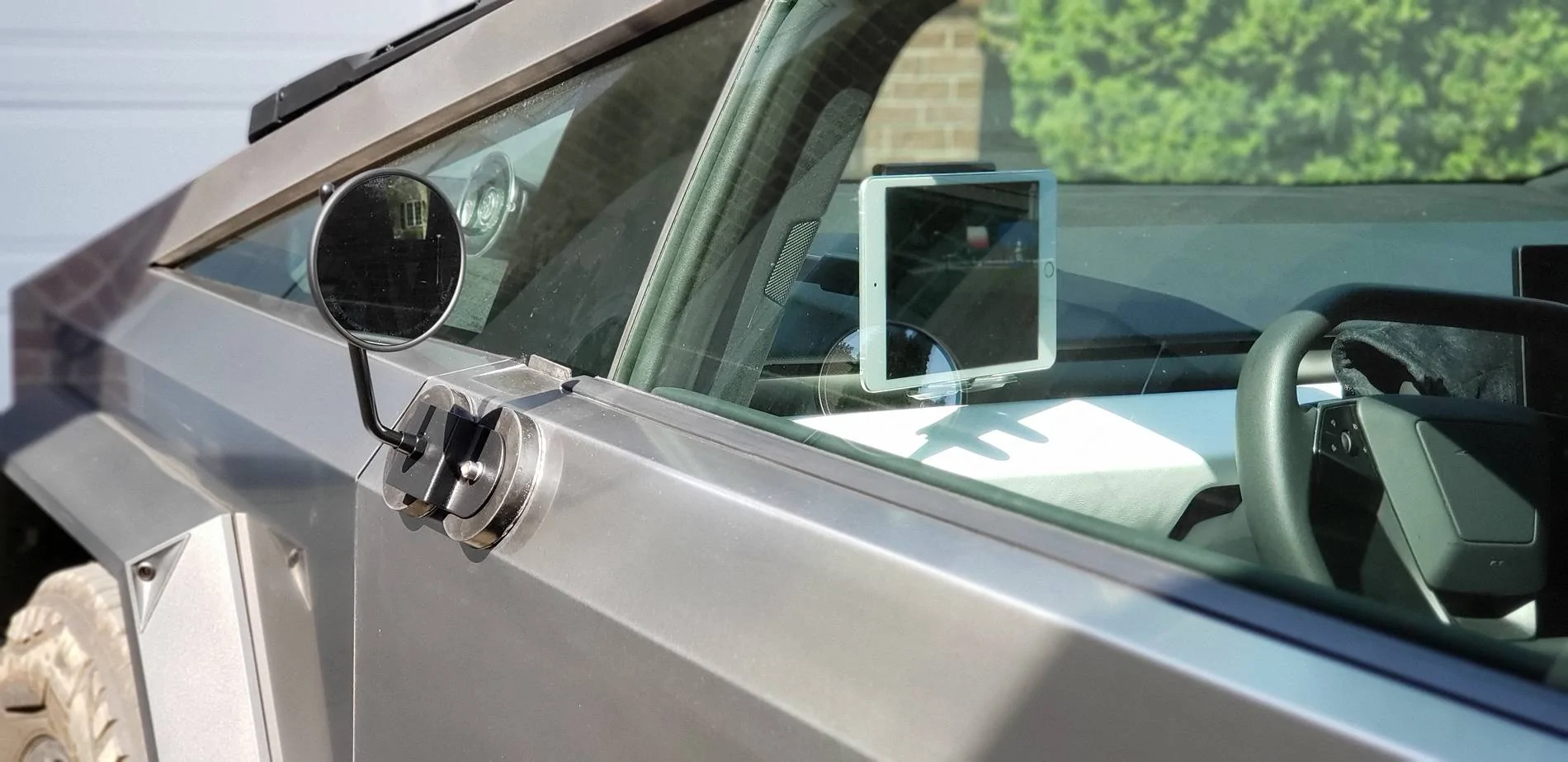

When I'm required by law to have a side mirror, I'll slap this ugly accessory on the door to avoid being cited for an equipment violation. It's a 3 1/2" motorcycle mirror attached to the truck with a strong magnet. Tesla's SS is magnetic, but not exceptionally so. I haven't tested it yet at speed on a rough road. The mirror is large enough to meet Canada rules when I take my dream adventure trip to Alaska. Needless to say I won't be using this mirror all that much. I called it my "compliance mirror".

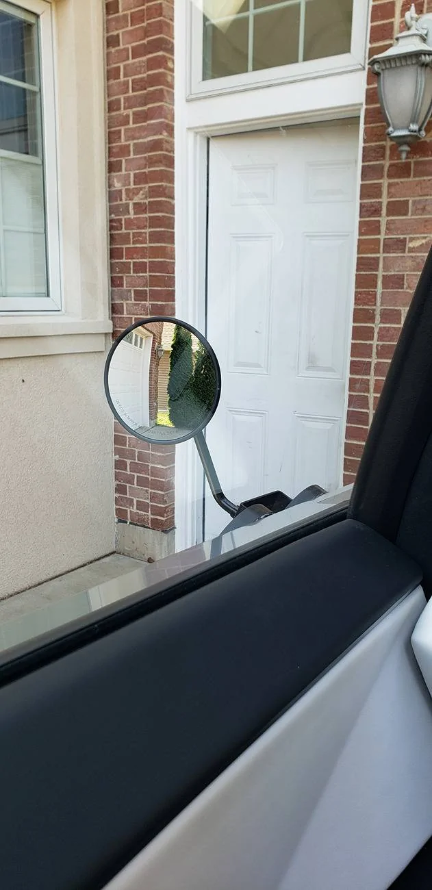

And here's what it looks like while driving. It actually works. I'll mount these mirrors when someone else is driving, like if I bring the truck in for a service appointment and a Tesla tech needs to do a test drive. Mounting the mirrors would be the safe thing to do.

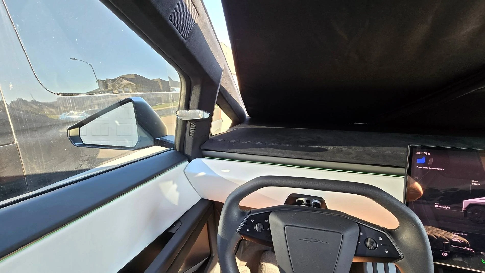

@Cybergirl You and I are the same page. I want to remove my mirrors, but I want an acceptable alternative. I also feel a center mounted screen would be ideal.
I have explored going low tech and adding mirrors inside the CT. They wont be able to see behind the vehicle, but they can at least cover the lane next to you and the blind spot.
So far I purchased these but they are way to small. The perfect mirror needs to be the right combination of size, convex amount and clarity.
