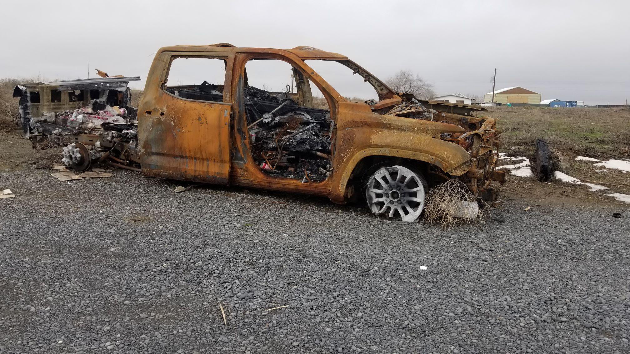

Here's a nice "patina" I found during my Model 3 road trip to Northern Montana in January:
