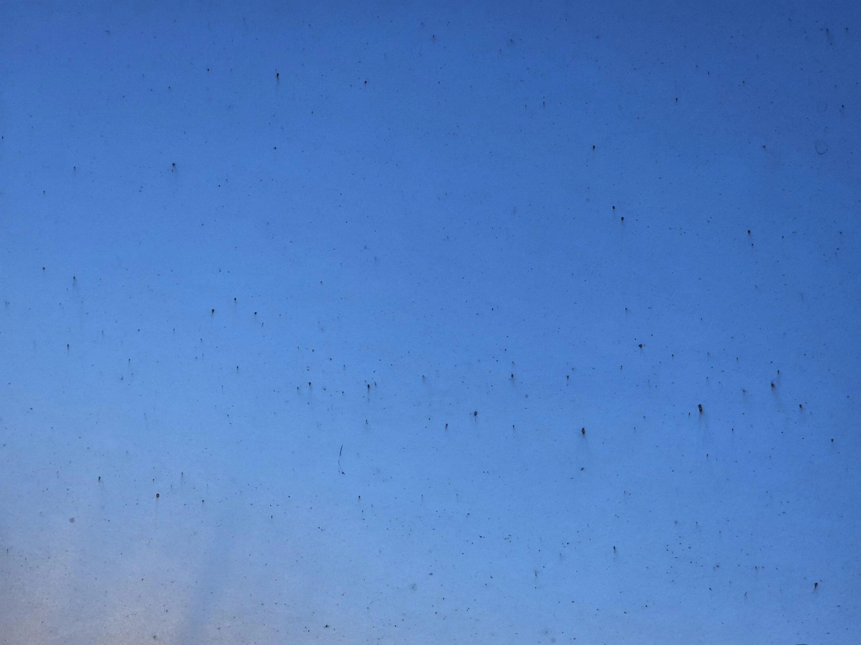

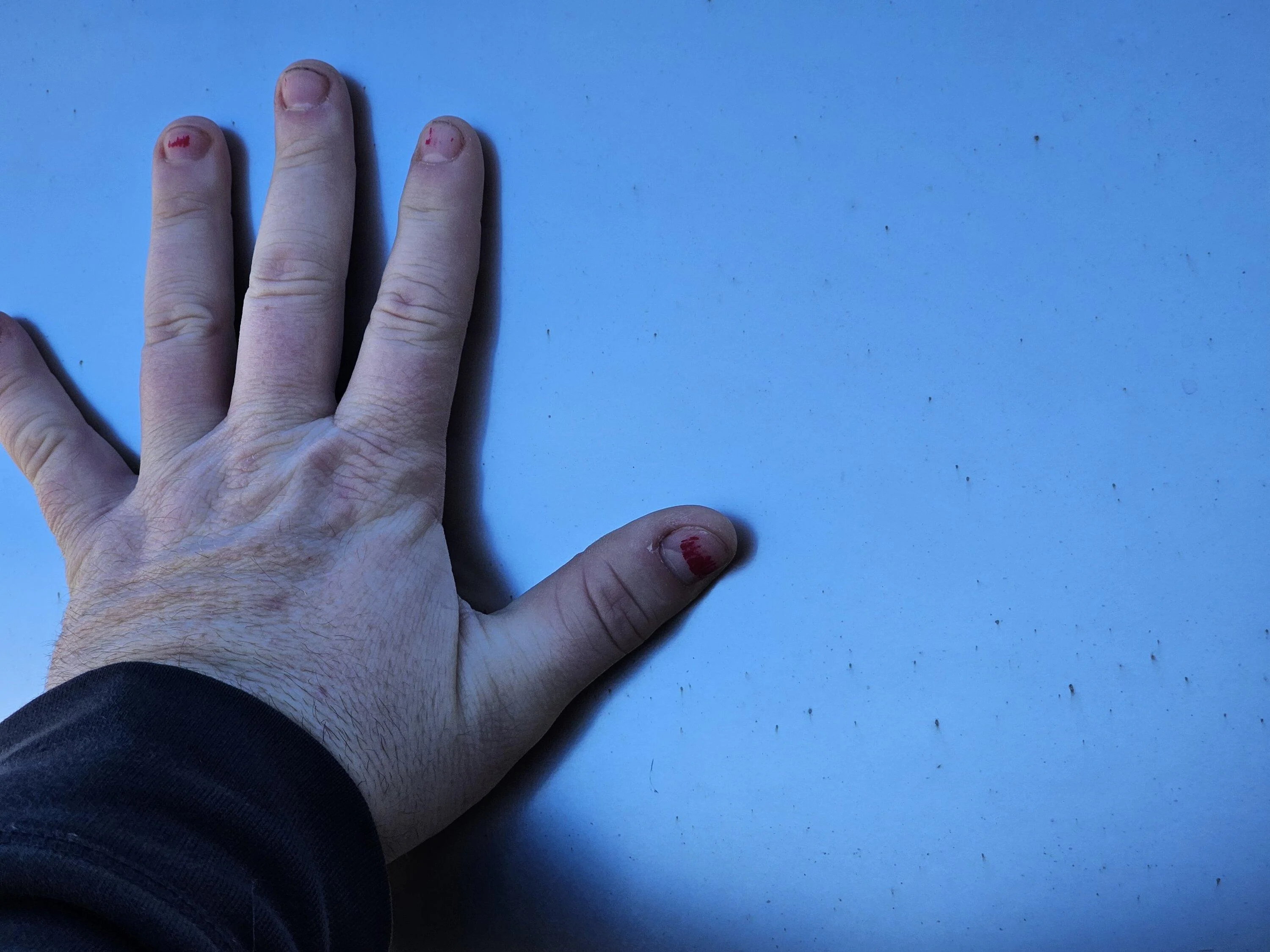

I received my AWD Cybertruck on February 1, 2024. Throughout the LA rain, I noticed the corrosion was forming on the metal like other people have noted, so I decided to start documenting it and bringing it to Tesla's attention. I figured it was already on their radar, but I want it attended to under the warranty. So I made a service appointment for this morning.
The truck was taken to the back and the exterior was washed, just to verify the corrosion was not specks of dirt.
Speaking with someone at the facility, they told me 1) they have a procedure/guidance for how to fix it, but 2) they don't have the tools on hand, nor have they done this repair before. They documented the corrosion, and told me they'll give me a call next month when the tools have arrived and they can perform the service/repair.
The Cybertruck has 381 miles on it, and has spent much of the 11 days in my custody parked in front of my house. Cold weather, rain, and some direct sunlight later, I attached a few photos of the corrosion spots and a video. Seems like it's much more prominent on the top metal that rises above the truck bed moreso than anywhere else, but the spots are definitely everywhere in the metal.
Pardon my gross hands and fading nail polish...
