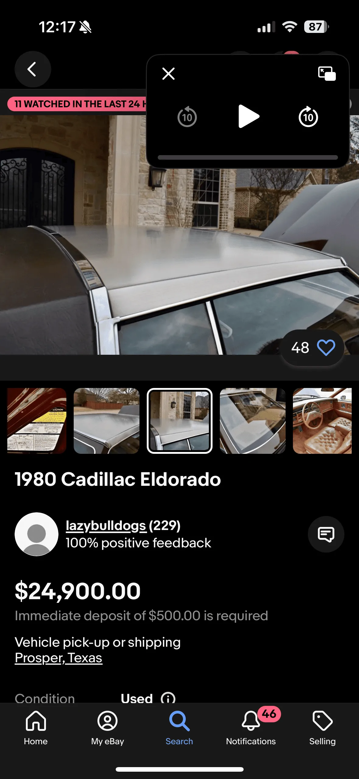

The Cadillac Eldorado Biarritz from 1979 through 1985. Also had a full brushed stainless steel roof.
And unlike DeLorean that almost all sat garages for most of their lives, most of these Cadillacs sat outside and they never developed rust on the stainless steel roof. Tesla is using a different alloy formulation.
The 1957 and 1958 Cadillac Eldorado brougham sedan also featured a stainless steel roof, and those too are still in perfect condition. Without rusting .

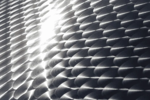

I'm surprised I haven't seen anyone experimenting with different surface finishes on a Cybertruck yet. Those people obsessed with how their truck looks all seem to gravitate towards covering the metal up with a plastic film. Go figure!
Have you considered switching to a linear finish, like a DeLorean, on your Cybertruck by using a coarse Scotchbrite and a linear polishing motion?
Or, how about a "ring finish"
Hard pass on the loopy scales of death, thanks.
I've actually considered the linear finish so that the two vehicles match, hahahaha
