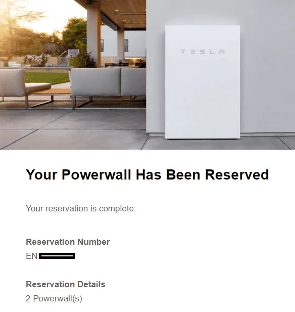

My ONLY regret in my solar journey has been not adding Tesla Powerwalls along with solar. Especially now that the Federal energy incentives are back up to a 30% credit, Powerwalls come out likely cheaper than whole home gas or propane options dependent on sizing and needs.
https://www.energystar.gov/about/federal_tax_credits/battery_storage_technology
We don't lose power often, but its super frustrating when its a sunny clear day and the solar is completely dead when the grid power is down.
We have Natural Gas for heating, cooking, dryer, etc. so a whole home generator on gas is an option, but that also comes with added expenses and permitting issues that are not in play with Powerwall's such as where they can be installed, a concrete pad, annual maintenance and operation expenses.
I would love to throw a pair of Powerwall's in my basement next to my solar hardware and have a self sufficient eco system.... charging PW's during the day off solar, using them for offsetting usage at night on TOU energy plan or during outages, all while being able to keep my solar active regardless of the grid status.
Tesla discontinued PW sales without a full solar install for years now, but just opened orders back up so now I'm impatiently waiting for my number to get called. ?
https://electrek.co/2023/03/10/tesla-opens-direct-powerwall-orders-again/

I very MUCH hope it works out for you and you can get it !
