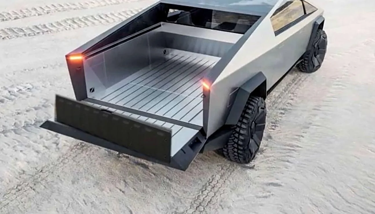

Midgate seals would be a pain to keep clear of debris unlike the door seals where it can be designed to drop large bits, especially considering people will but sand, dirt, gravel etc in the bed. Another reason to not have a midgate at all btw. Lights in the top of the tailgate means you can just drive around with the tailgate open for the same length gain and no fuss around making a midgate work with vault cover, let alone making the midgate wall "flat" so you can actually use it properly as a loading floor. That same midgate crease angle is why a wind down window won't work. It would need a major redesign.
This would be easier and cheaper and you can use it as a step. Better than having a steep ramp too.
If you're one of the rare people who want to fish in your CT, you put the extra effort in to keep debris out. Also keep bagel crumbs and baby wipes out of your door gaps.
I expect midgate lovers to out number CT sailors by 10:1.
What does the midgate give you that the fold down tailgate and stop doesn't?
Whilst traveling the open midgate will mean you lose 3 seats, the tail gate means your keep all 6 seats, and have all the NVH outside of the cabin.
The only advantage a midgate will give you is access to the bed from the cabin, for example for camp mode, which btw is stationary, but once again it will mean you lose the use of the rear seats as well. I think that is a poor compromise, I'd rather see a fancy load stop on the tailgate instead of a useless ramp that is to steep to walk up. I'm also not sure that the vault cover is 100% waterproof in the current design.
BTW the amphibious mode is a consequence of other design features, but not a feature they specifically changed much of the design for to accommodate. The consequence of sinking is non trivial, so they would not want to increase the risk, let alone add something that increases costs, and other failure points. It's also a structural element of the cabin cell btw, at a minimum to protect occupants of a shifting bed load whilst braking.

Midgate seals would be a pain to keep clear of debris unlike the door seals where it can be designed to drop large bits, especially considering people will load sand, dirt, gravel etc in the bed. Another reason to not have a midgate at all btw. Lights in the top of the tailgate means you can just drive around with the tailgate open for the same length gain and no fuss around making a midgate work with vault cover, let alone making the midgate wall "flat" so you can actually use it properly as a loading floor. That same midgate crease angle is why a wind down window won't work. It would need a major redesign.
You are forgetting that the Silverado will have both a midgate and a fancy tailgate....and Tesla doesn't want anyone with better functional features than they have. This might even extend to the frunk design. I do not know what they will have but I do not expect Lightning or Silverado to outshine the Cybertruck. Eventually we will find out.
