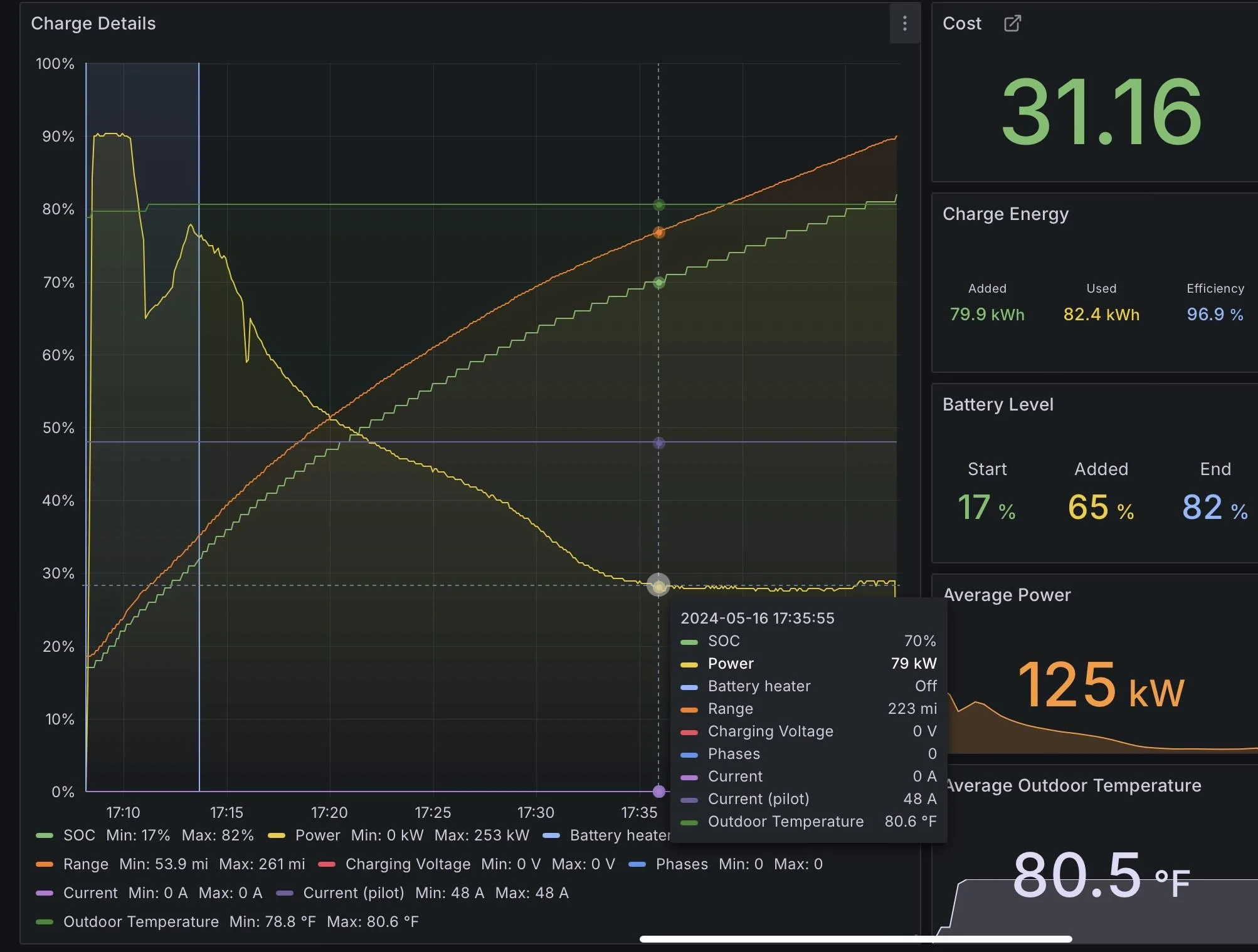

That seems a little low based on what I have seen on the Cybertruck AWD on a V3 Supercharger.
Below is a charge session on a V3 Supercharger. Levels out around 70 kW at 70%
Tesla Roadster 2nd gen Why is my charging speed so slow? IMG_0414

Do you set the supercharger as the navigation destination (good) or just drive up and plug in without setting it as the destination (bad, because it won’t precondition the battery for charging)

Biggest thing is pre conditioning the battery and LOW SOC. Get to a supercharger under 20% and see how it charges.
Also go to the secret service menu and see if any alerts pop up.
I'm assuming its normal and there's nothing Tesla would do unless you're getting alerts that it can't charge or charge level reduced.
