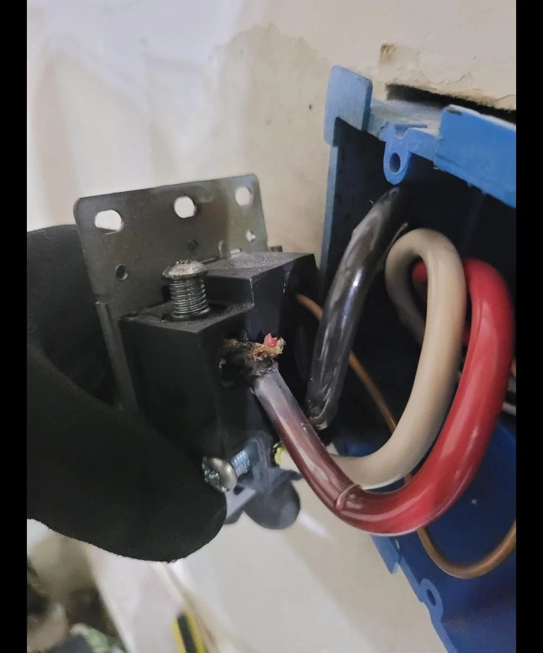

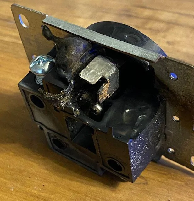

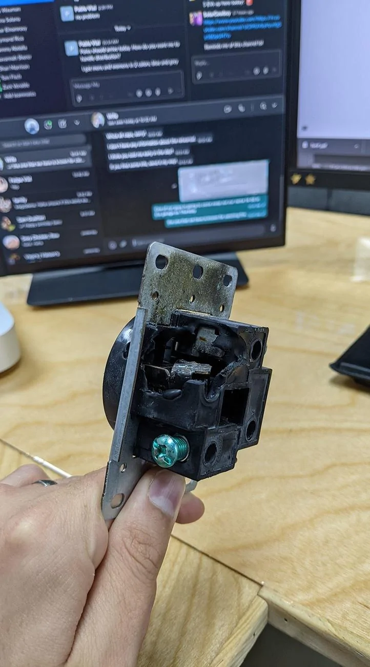

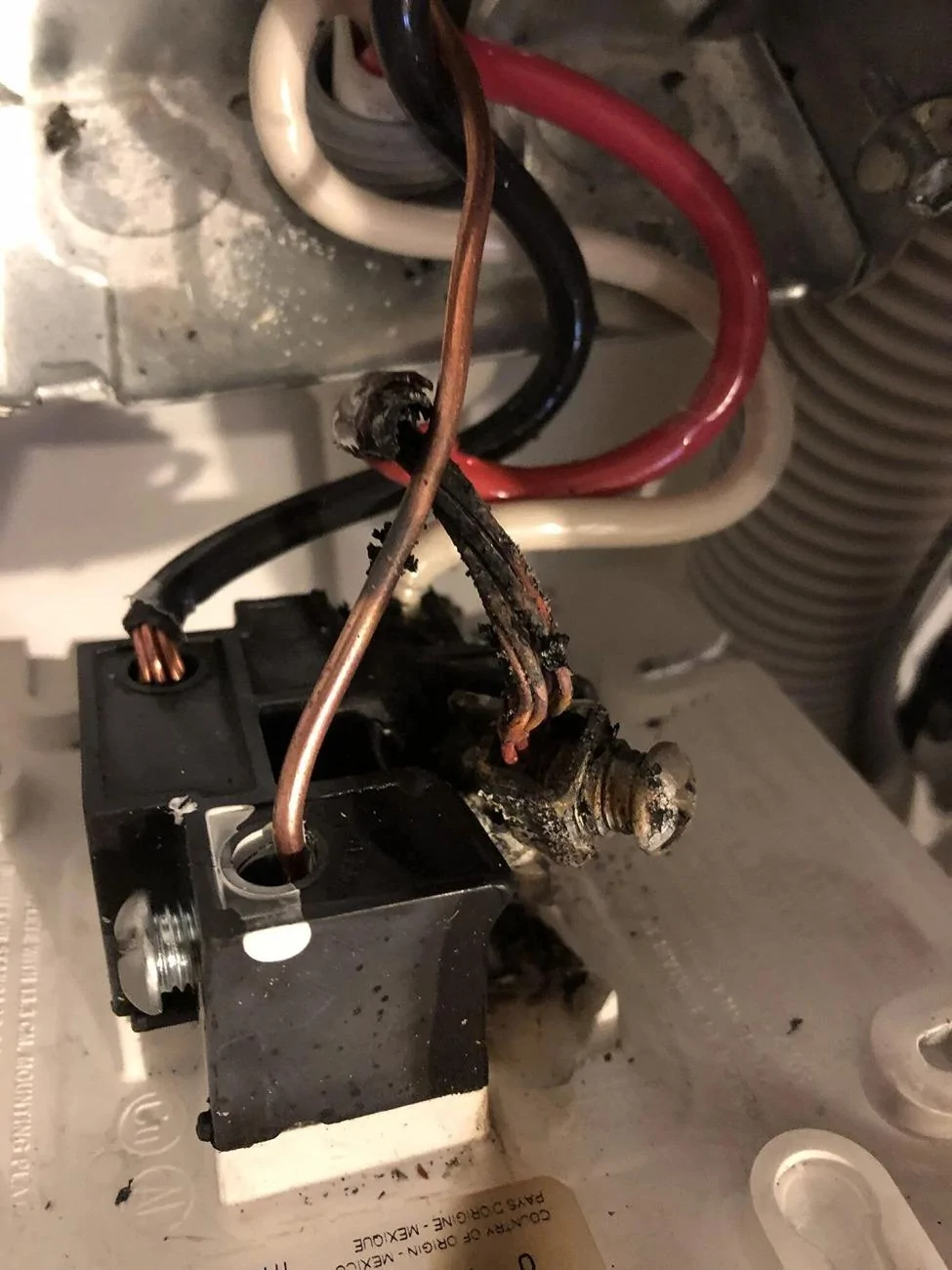

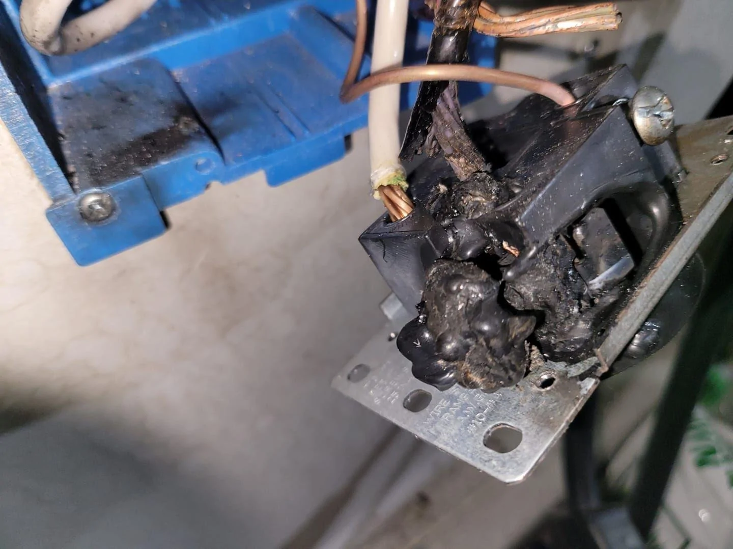

As I've posted in other Tesla forums, if you're going to use a mobile connector, DO NOT use a big box store Leviton 14-50 receptacle. They have issues with poor connections (due to how the wires attach) that can eventually lead to heat, melting or worse. Get a Hubbell or Bryant receptacle from Amazon; they are much higher quality than the $10-$15 Leviton receptacle...
