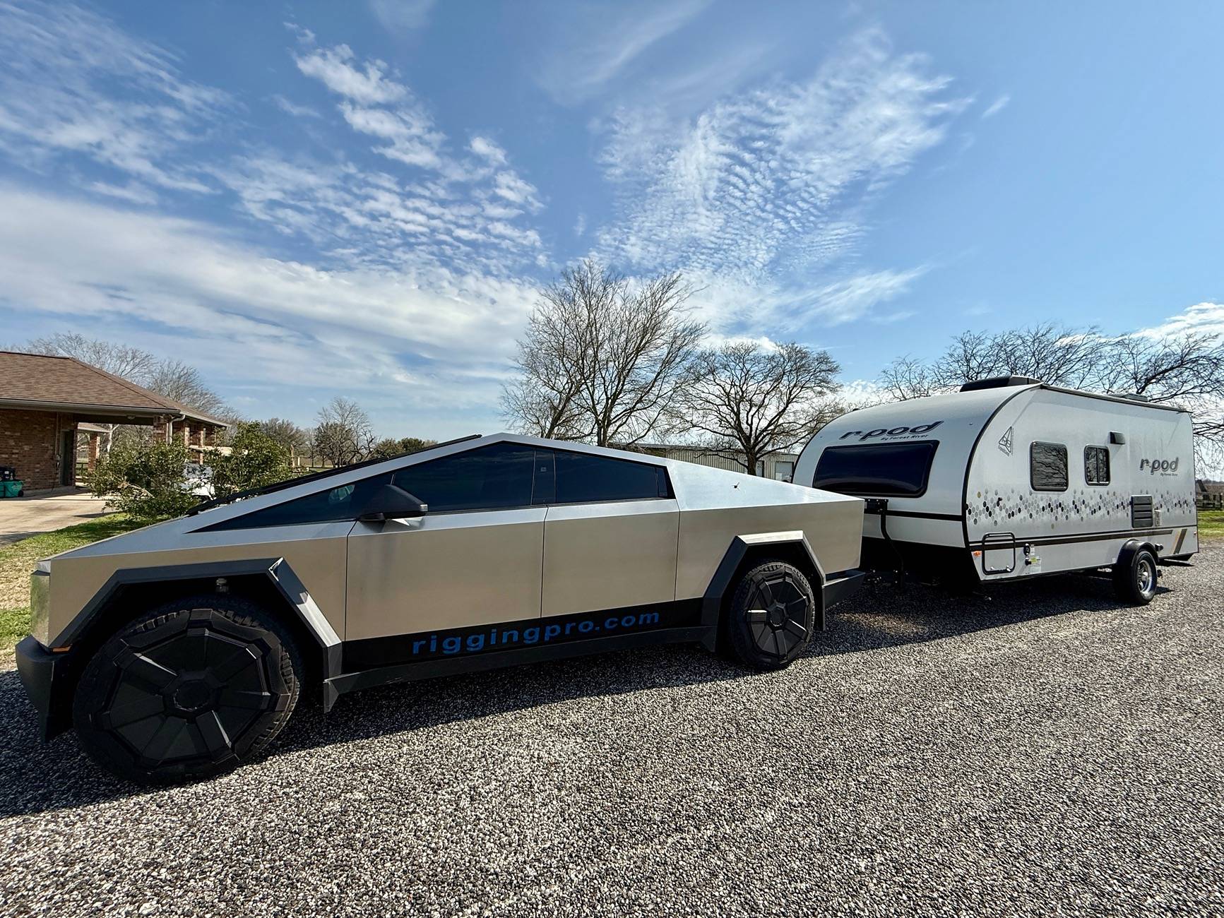

The new update is a big help. When you plug your trailer in and then select your saved trailer profile it adjust the power consumption based on past drives with that trailer.
Just figured that out yesterday because I switched trailer profiles and my range changed.
Tesla implements things that make so much sense but I never thought about them before. Love it!
