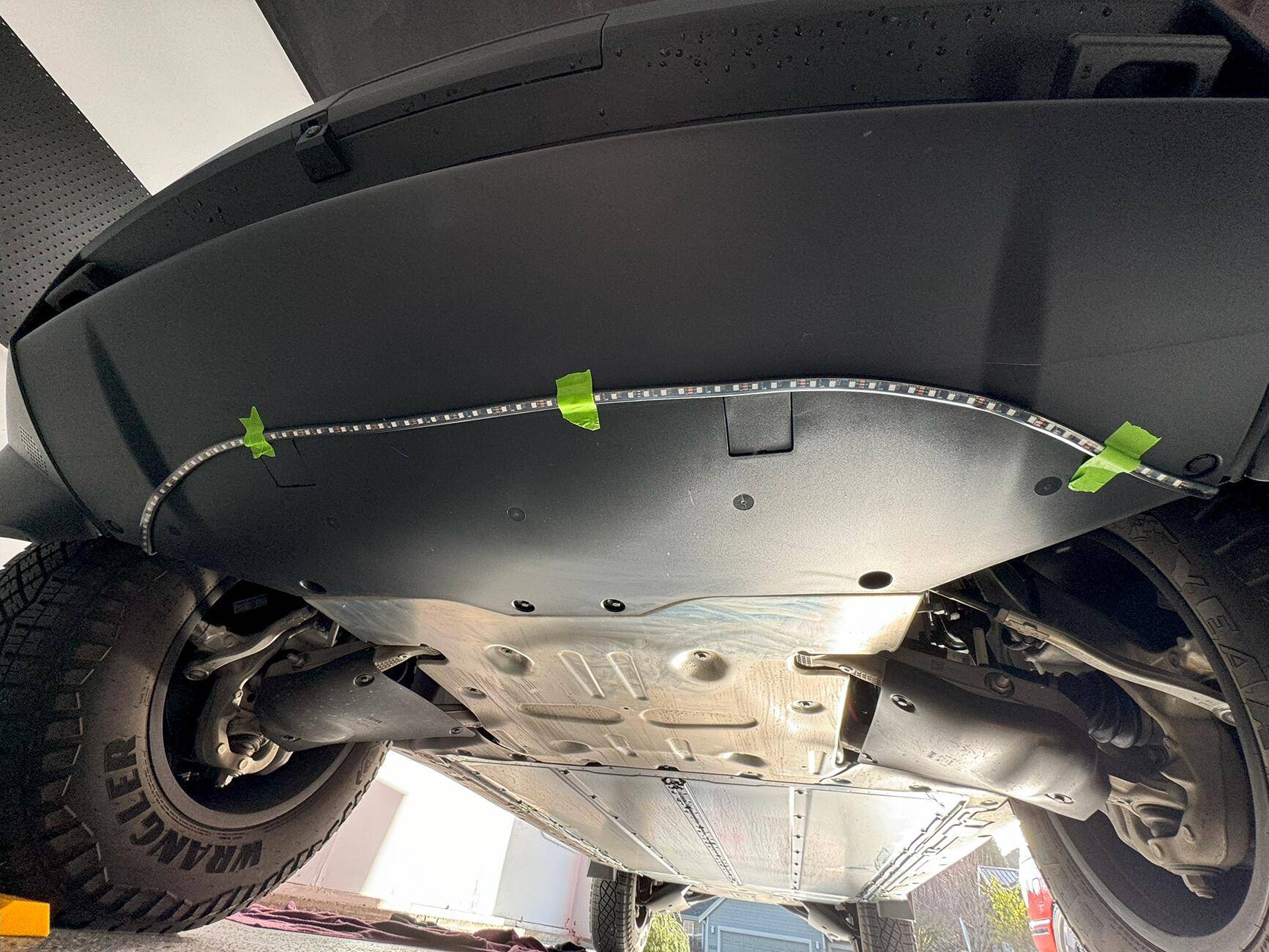

The tricky part for me was actually adhering the light strips to the body, and routing the wires. I didn't do the best job largely because from what I can see, the wires are a tad too short for the overall large size of the Cybertruck. Also I put the truck in Extract mode to do the installation and while it's handy, some of your wiring decisions and clearances change as the body lowers back down to driving height. I knew this was the case so I taped everything into place before I actually unwrapped the adhesive and sure enough, some of my wiring paths (particularly the front wheel well) ended up being too close for comfort once lowered.
I started my routing with the front, then the driver's side, then the back, and ending with the passenger side. Because of the short wires the light strips aren't perfectly centered along each section. It's most noticeable along the last two strips (rear and passenger side) as I had taken up pretty much all the available slack centering the other ones.
Also you may be looking at my placement of the LED strips and wonder why they are curved they way they are. The reason is that the LED strips are flexible but not infinitely so - you can't really curve it with a tight radius so you have to get creative.
Front: I ended up moving the right end of the strip here closer to the skidplate to free up some slack. In retrospect I could have moved the entire strip further into the body but I was afraid it would limit the view of the light pattern from the front.
Tesla Roadster 2nd gen Underglow lighting kits. Do they cause problems? IMG_7234
Driver's side: I ran the light strip along the inside of this channel.
Tesla Roadster 2nd gen Underglow lighting kits. Do they cause problems? IMG_7233
Rear: At this point I'm noticing how short I am on wire which is why I couldn't center this one very well.

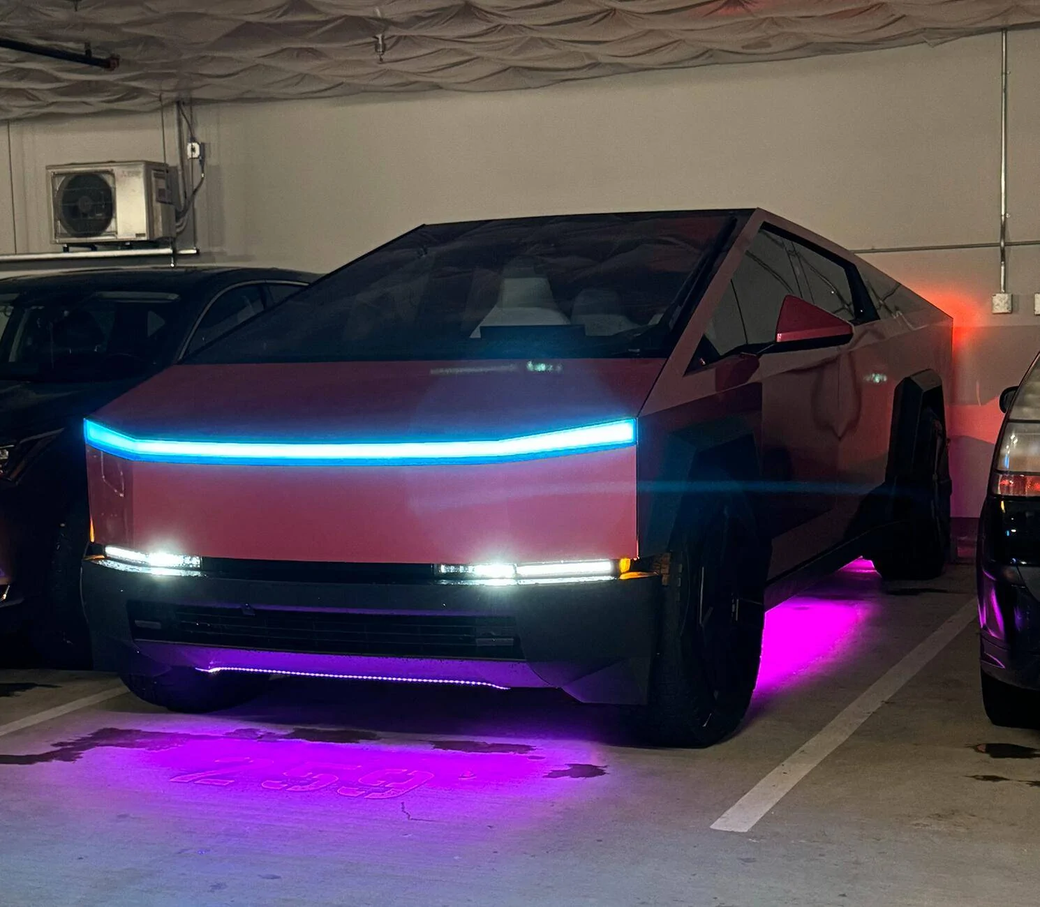

All in all it's been great, my kids love it, and I'm constantly playing with the colors in the app. It does shut off when the truck goes to sleep (this was something I wasn't totally clear on) so I keep the Power Feed ON in the truck menu. When I walk up to the truck and it wakes up, the lights turn back on.
Tesla Roadster 2nd gen Underglow lighting kits. Do they cause problems? IMG_7630
As to the adhesion question, it's already been a very rainy PNW winter so I'll report back if I have issues, but so far so good.

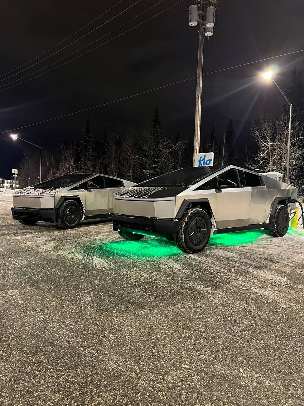

Got mine on in Alaska! The self adhesive works really well on the main metal under the footwells, the plastics near bumpers not so much.
I used gorilla glue clear tape and had it heated up over a Mr heater buddy for a few seconds, this turned the surface into a shrink wrap cling type consistency and worked phenomenally on the underside front and rear.
I feel this is very secure even in Alaska as long as you don’t scrape the skid plate. Install on the metal took minutes front and rear 1 hour each. Very simple electric install. Amazing selection of light choices!
spotted my first other CT owner at the local charged tonight, the green really helped differentiate our trucks. I feel it matches the green energy symbols were so accustomed to ?
it should glow green under from the Tesla factory when charging!
