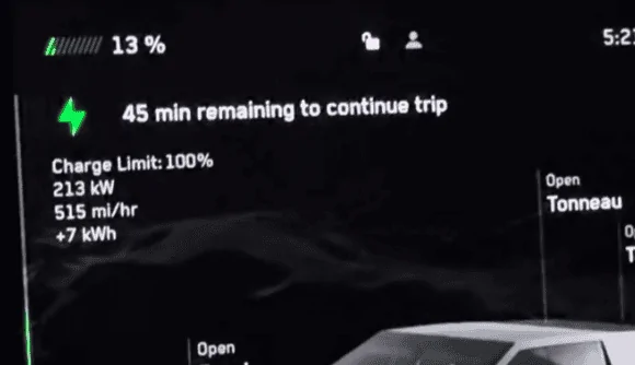

Based on wh/mile it looks like about 80-105 miles of range when towing, which is not the end of the world if they can get the minimum charging time to get to the next supercharger down from an hour.
Battery is taking close to an hour to go from 10-75% on the FAST V3 chargers, so the V2 chargers will be close to two hours to full.
Having to unhook a trailer for an hour or two to charge every 1.5 hours of towing would be pretty brutal, hopefully these early towing reports are worst case scenario, although none have been over 5,000lbs.
