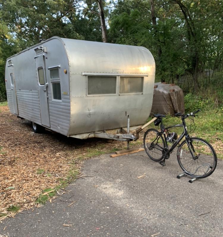

On Towing I’m new to electric but not trailers . I build custom vintage travel trailers .
I’m Planning on towing with the tri motor (500+ mi range with no load ).
I’m anticipating 175 miles with zero range anxiety and plenty of juice left over to plug in a 30 amp trailer for a night of two . Trailer weight AND drag from wind resistance reduce range .
CT from a length width and weight standpoint, should make a good tow rig .
That said when towing with your CT , plan to stop more frequently to top off than your diesel pickup friends .

Those look nice!
What is the range with the bicycle pulling? ;)
