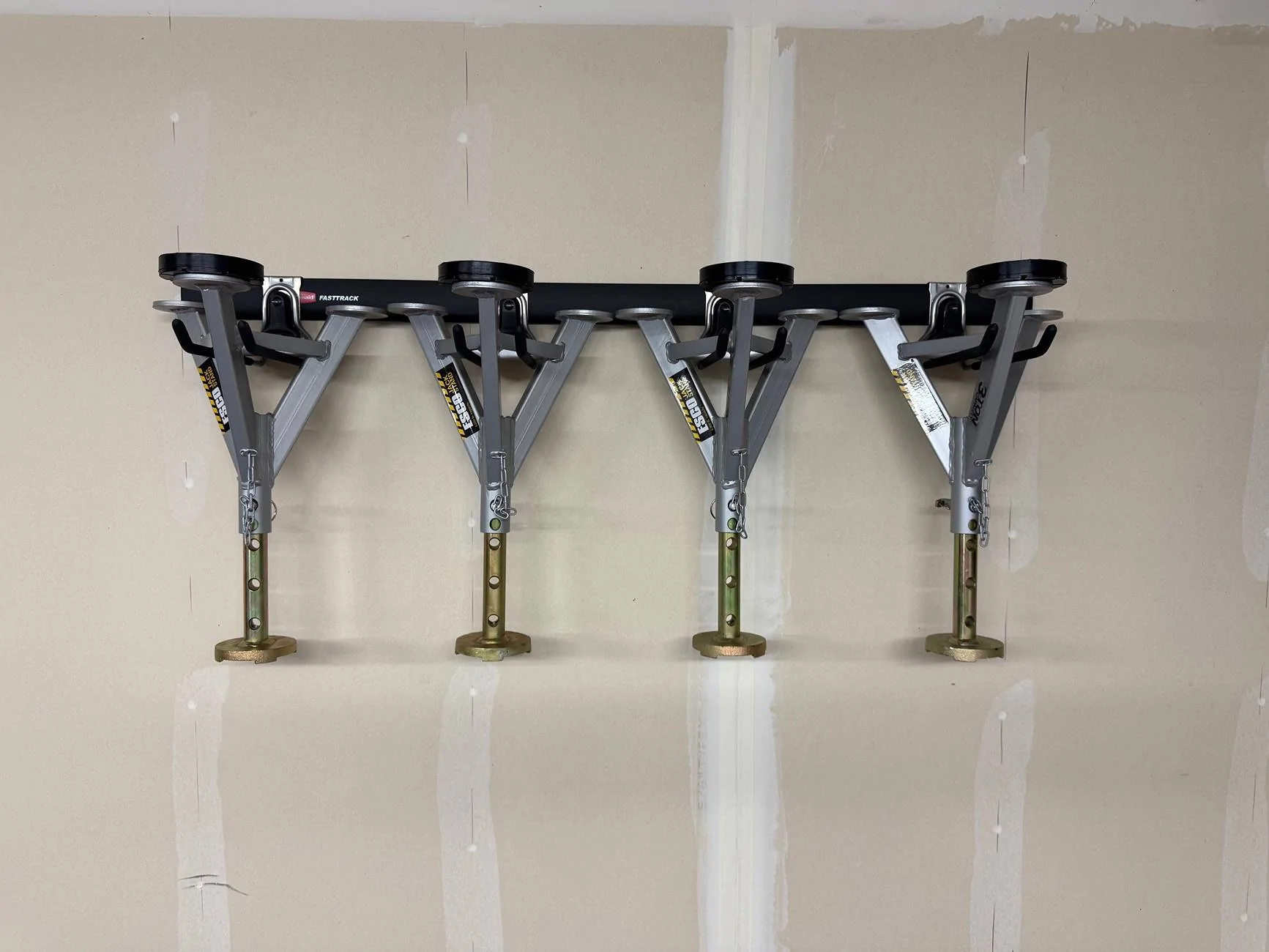

1. Not hard at all, IMO but they are not light. Lug guides are amazing. Easy to find the jack points and the jack stand points.
2. Tools below. I use a breaker bar and digital torque adapter
3. devdrone6 linked this
4. devdrone6 linked this
Use the following tools:
https://evannex.com/products/schwab...8JPIFA_hjpTyVN9KsFYfYv1oFJPjxuZXqesepxG94aLHH
https://a.co/d/48aFEzn
https://abstractocean.com/products/threaded-lug-guide
https://a.co/d/3Rr36A0

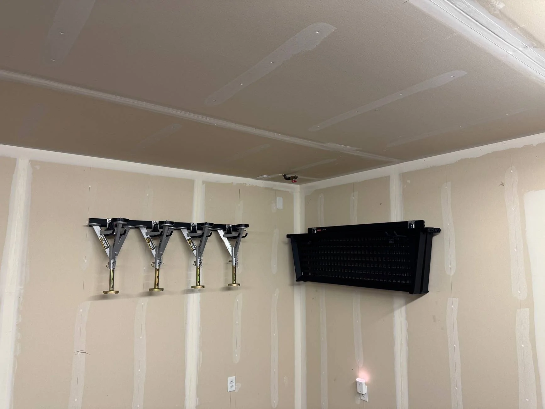

The jack stands store great on some FastTrack rails. I just leave them at the height I need for the truck because it is the only thing I use them on.
