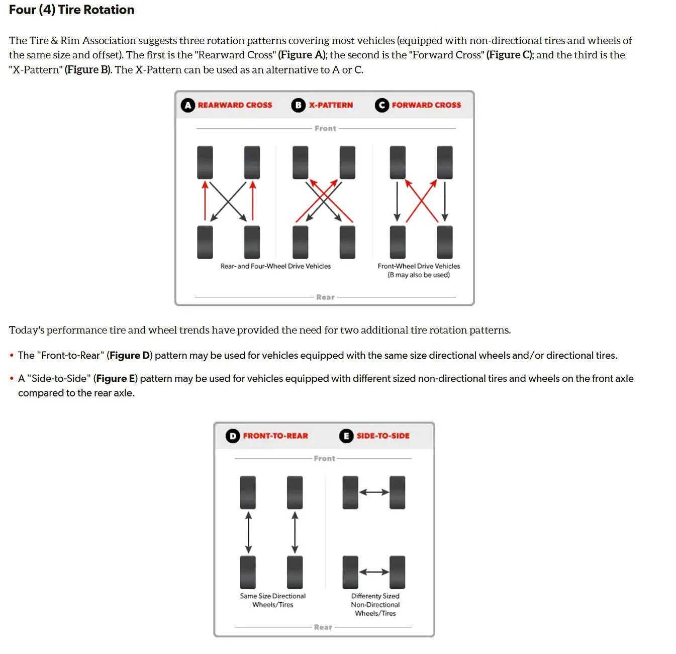

It is my understanding that tire rotation should be left rear to right front and opposite rear to opposite front. That makes it tricky to get those wheels off the ground unless you have a lift ? with specific Jack points you can’t get a Jack stand under the place you have jacked up. I don’t want to risk putting them elsewhere. So, I bought a spare for the Y. I can Jack up one wheel, put the spare in that one, lower it, jack up opposite diagonal wheel, exchange the wheel I removed with that one, repeat until the spare is again off the car. Yes, it’s more time and effort than other methods, but I feel a lot safer doing it that way. I took it to a tire shop, but they rotated rear to front, front to front, etc. rather than argue with them I prefer to just do it on my own time and save a few $. With my Sam’s membership, they will do it for free, but it’s not very convenient.

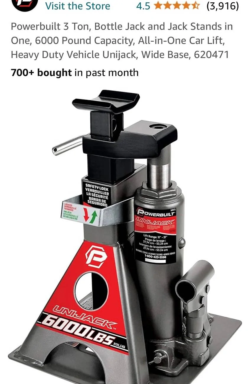

I’ve been using 2 of these bottle jack stands. Perfect since you can set to higher height. I’ve rotated twice so far with no issues. See image:

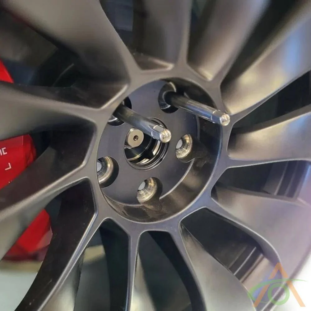

I purchased a spare tire/wheel and have been using it to get some wear on it and rotate with the OE wheels. I struggled the first time because the wheel/tire set up is HEAVY (about a hundred pounds) and it is difficult to align that much weight precisely onto the lug posts. I discovered this product which made the job way easier on my second pass at this:
https://abstractocean.com/products/threaded-lug-guide
It's a little pricey at $20 for what it is but really made aligning the wheel so much easier. They seem to recommend buying two but one got the job done just fine. Highly recommend.

Wouldn't you need to put the whole guy on 4 jacks to do the appropriate X-rtation?
