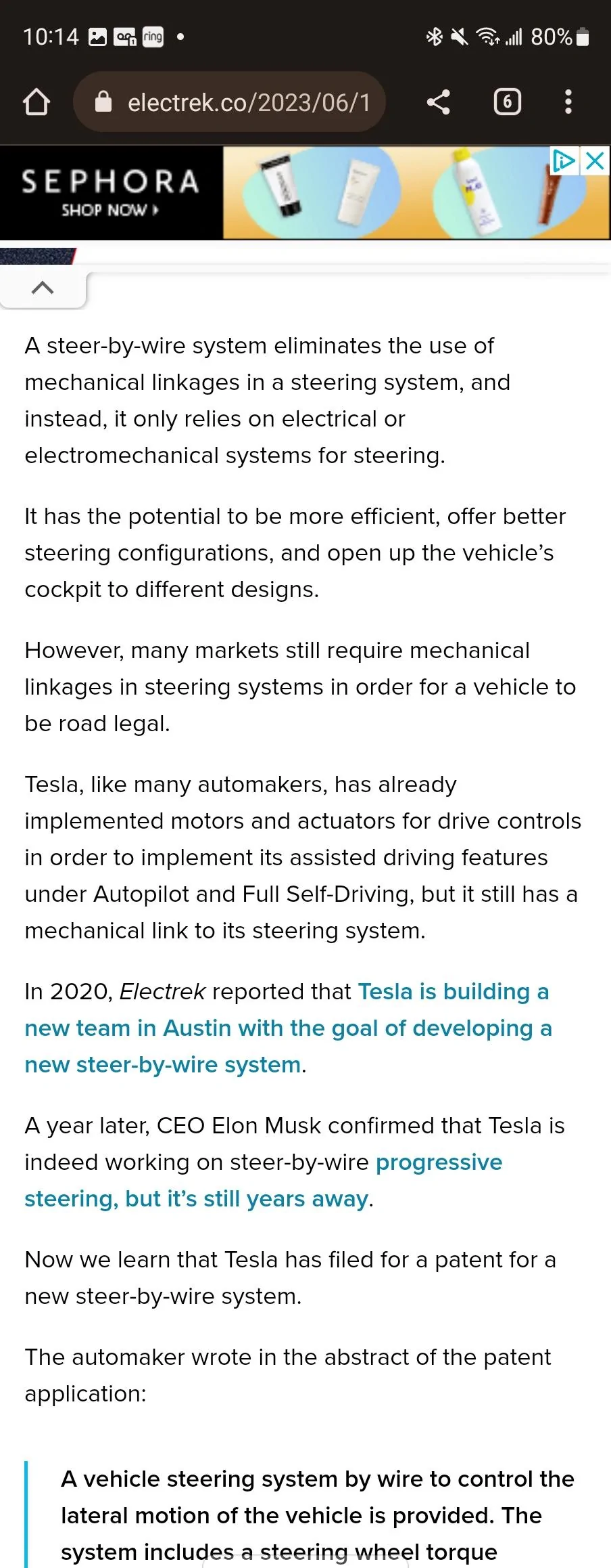

Unfortunately, it's only been confirmed for the rear wheel turning.
Has it even been confirmed for the rear wheel steering? I haven't seen a verified source. It makes 'sense' for the CT to have 4WS with progressive steer-by-wire (and I have been hoping for it) but if wishes were fishes ...

I am not disagreeing with [either] of you, and it only makes sense; I just haven't seen it confirmed. Also, using your same logic/reasoning, why would Tesla use SBW in the rear and not in the front. Perhaps this new patent allows them to do just that. I dunno.

U.S. NASA invented digital fly-by-wire for some of its aircraft in 1972.
The Tesla patent is important but in the U.S. the patent probably does not change the main roadblock, archaic auto regulation.
In U.S. regulation, a human driveable car can have steering wheel connected to steer-by-wire (SbW) system but it must still have a backup mechanical linkage from steering wheel to front wheels.
If the car maker still needs to put in a backup mechanical linkage, the extra cost of the backup mechanical linkage cancels a significant part of cost reduction possible using SwB, cancels some of front crash safety advantages of SwB, and prevents easy right-hand/left-hand drive models manufacturing cost/complexity reduction of SwB.
Example: Being allowed to do SbW without backup mechanical linkage will probably be critical to whether Cybertruck is ever officially delivered to Australia and other right-hand drive countries.
New U.S. regulation for 100% fully autonomous (no steering wheel & other controls for a driver) vehicles (shuttles and robotaxis ) say these vehicles can use SbW and do NOT need to have a backup mechanical linkage.
If SbW without backup mechanical linkage is safe enough for 100% fully autonomous vehicles then it should be safe enough for drivers too.
This U.S. issue is similar to situation where Cybertruck still has to ship with exterior mirrors even though Tesla camera system is better.
All modern airliners that have several hundreds of passengers at a time and even when landing can still be traveling at speeds in excess of 100mph, have SwB system with NO backup mechanical linkage.
Some classes (F1) of race cars that regularly travel 150-200mph for 24/48 hour races use steer-by-wire (SbW) and brake-by wire (BbW) systems.
Formula One and some sports cars such as the Audi R8 LMS GT3, BMW M6 GT3, and Mercedes-AMG GT3, Infiniti Q60, Lexus RZ450e, Toyota BZ4X EV, and soon might be a model from Nio (Chinese EV).
Vehicles driven by some extra challenged drivers use SbW since the driver is NOT physically able to use standard steering wheel and maybe other standard controls. Some use joystick for steering.
