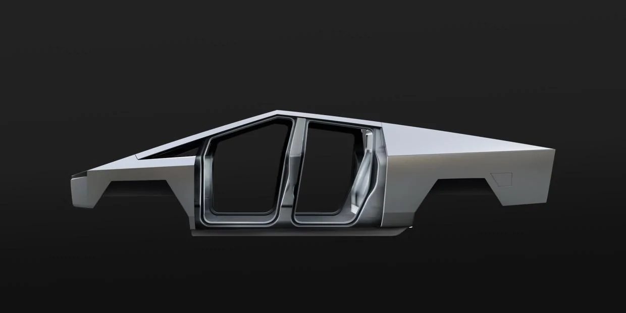

There is no evidence the design has changed. The render they shared on reveal night has the same cabin structure we're seeing on current Cybertrucks:
Tesla Roadster 2nd gen Some very apparent steer-by-wire action! {filename}
That image shows no front and rear casts whatsoever, nor any definition of a structural battery pack, both of which do more than any skin surface on the vehicle.
It's just a placeholder to show the "intent" of the design, and it's form, but in no way indicates if the exterior is structural or not.
As for changes, we know it's not the same length, not the same angles etc, so yes it has changed.
To the better as far as I can tell. ;)
