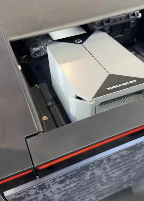

Don't know which company manufactured this but here is flexible solar panel wrap installed on a Cybertruck at CES 2025.
Cost is $10K (includes the 5kw battery inverter) and warrantied to 15 years.

a 5kw battery inverter ... so does that mean in perfect conditions it can charge at up to 5kw? That's pretty decent but seems a little surprising considering what I have seen from other solar panel setups that have panels pointed directly at the sun vs this where your just hoping the angles line up.

This looks like a fantastic product!! The cost seems too good to be true? A normal full application of PPF will run you about $7000, labor included. I imagine it won't be long until they are able to print different patters or solids for the design on the vinyl? My first reservation would be the fact that there are Cybertruck haters here in Washington state, where I live (not to mention the lack of sun-power), who impulsively try to damage our Cybertrucks. Another potential problem is the space for the battery... I wouldn't want to take up vault-bed space with it because I use my vault quite a bit already.
