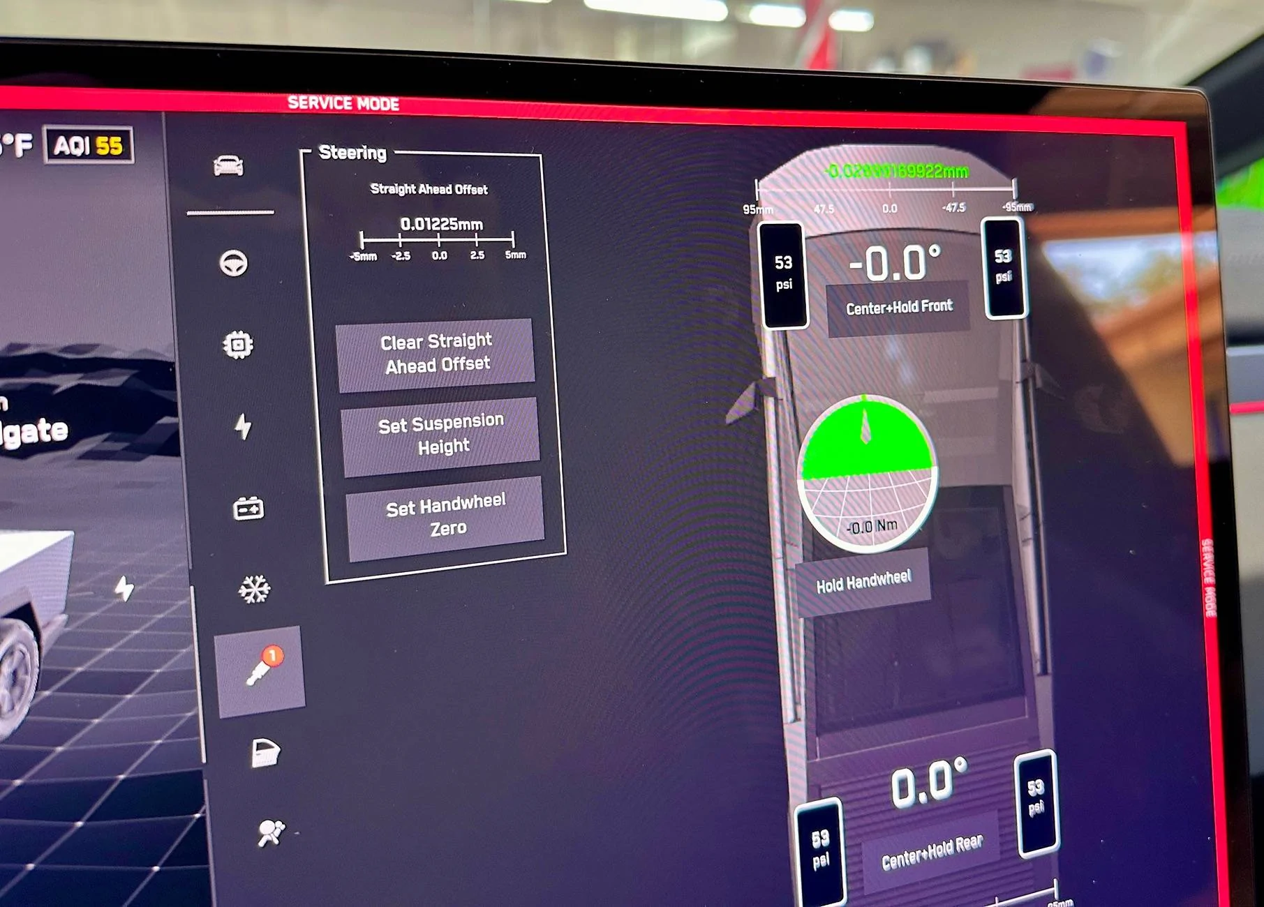

Ok so i got a alignment at tesla and this is the after pic.is this within spec?dont know much about alignment numbers
Did they provide you with the before and after data from their alignment equipment? The straight ahead offset can be helpful but only after the vehicle has been driven and the system has had enough data to establish the straight ahead offset., Attached is what my vehicle shows after the alignment and road test.
Yeah one should get a standard printout in the industry showing the before/after, and spec for vehicle. In car thing is cool, but post work one should get the printout.

Most vehicles leave the factory with alignment issues. I had my truck on the alignment rack right after delivery and it was indeed off.
How do you get to that screen on the monitor??? Or is this a screen shot from SC? Would be useful if one can pull that info up.
Go into service mode
