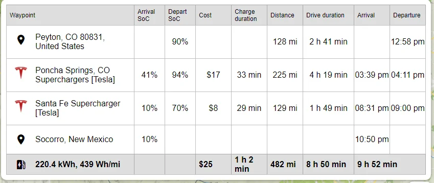

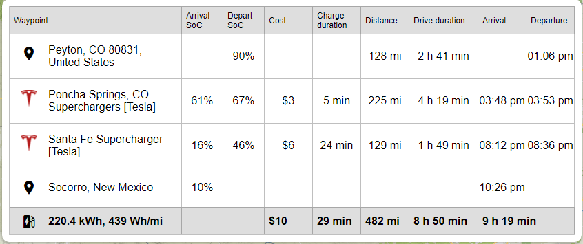

... Now yes we could have stuck to the freeway but we wanted to take the longer scenic route. From the Poncha Springs super charger to the Santa Fe super charger has a real long stretch of 65mph signed road that we were doing 75 on and still getting passed iregularly so we would have a range loss then as well on that stretch.
Seems like you were driving really fast and should've stopped for dinner somewhere and a few kWh. Lunch at a 14-50 will get you almost 10% SoC back.
