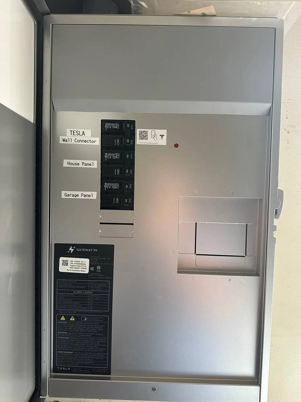

I don't think that they installed it correctly. Since they didn't connect the in coming power using a main disconnect breaker, they might have bypassed the internal, automatic disconnect switch that is used in a grid down situation. Could you take the panel off your gateway, take some pictures and post them so I can see how they routed the incoming and out going power lines?
Is your (House Panel) and your (Garage Panel) rated at only 100 Amps each?
My entire main panel (whole house) is backed up by PowerShare as well but my main panel is 200 Amps so they installed a main breaker in the blank spot that that's not being used in your gateway.

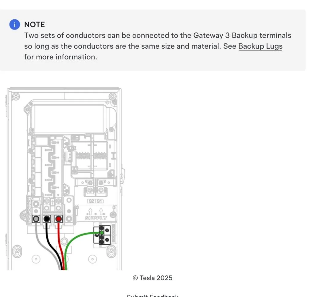

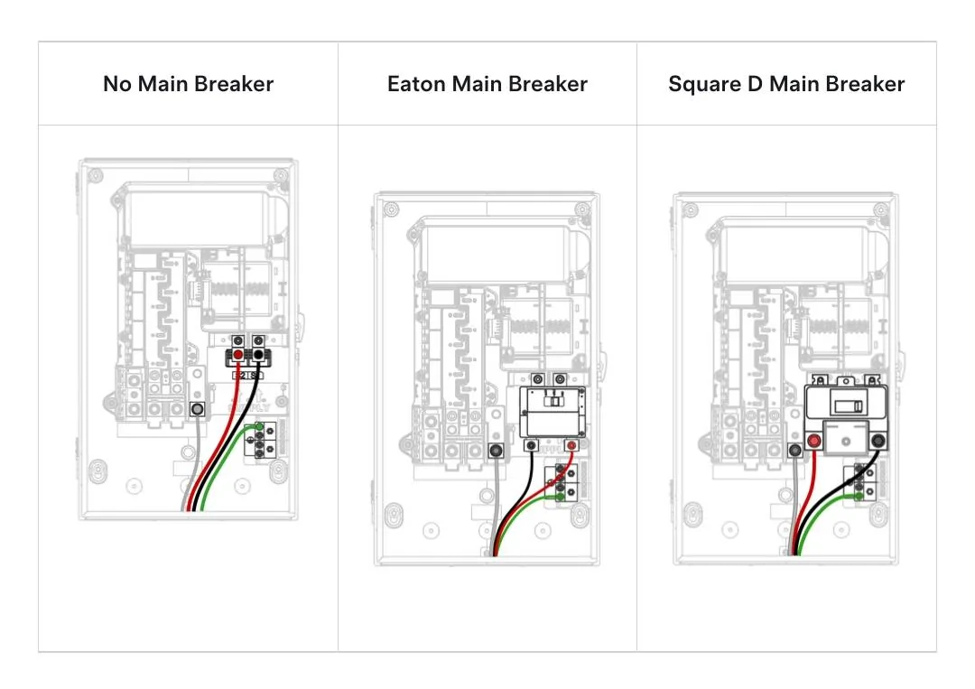

The power input doesn't require main breaker.
The transfer switch could be bypassed if they did it really wrong and used the double the output lugs. However, given the lack of a main breaker there must be a disconnect between the meter and Gateway.

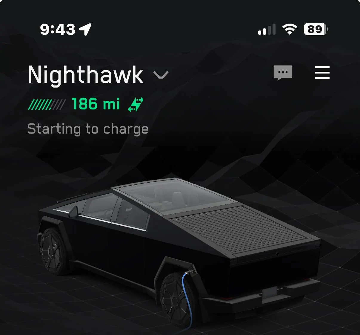

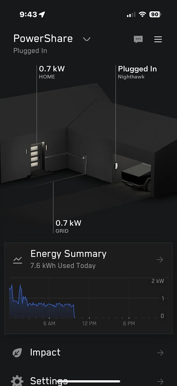

Sure. I done have the switch in the charging section of the truck yet. The PowerShare shows up as a “Site” in the app, swiping right or left can get you there.
