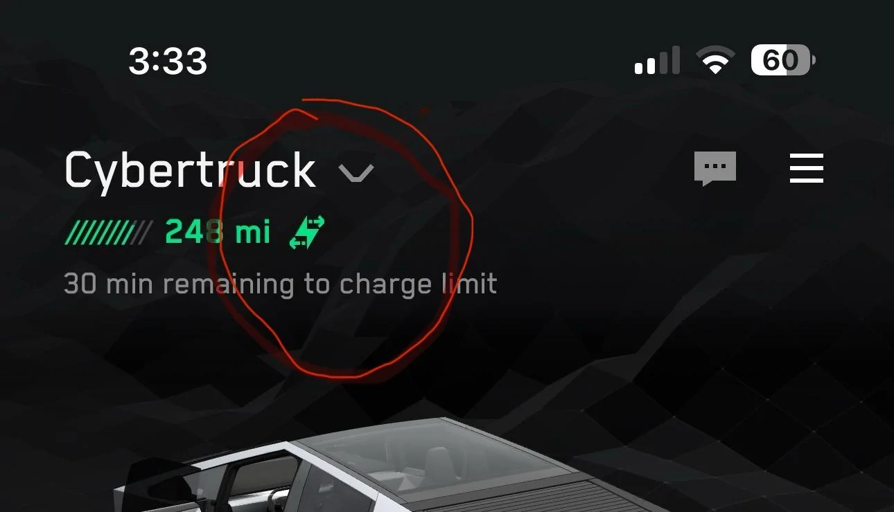

I have the same problem. Installed Monday the 8th of July, see the powershare icon when the vehicle is plugged in, but no option in the truck or the app to enable it. Not getting anywhere with Tesla support.
Where do you see a PowerShare icon? I don't see anything indicating PowerShare - would you mind posting a picture?

Update: it was just activated! The app opened with a tutorial and after clicking through, it was enabled.
