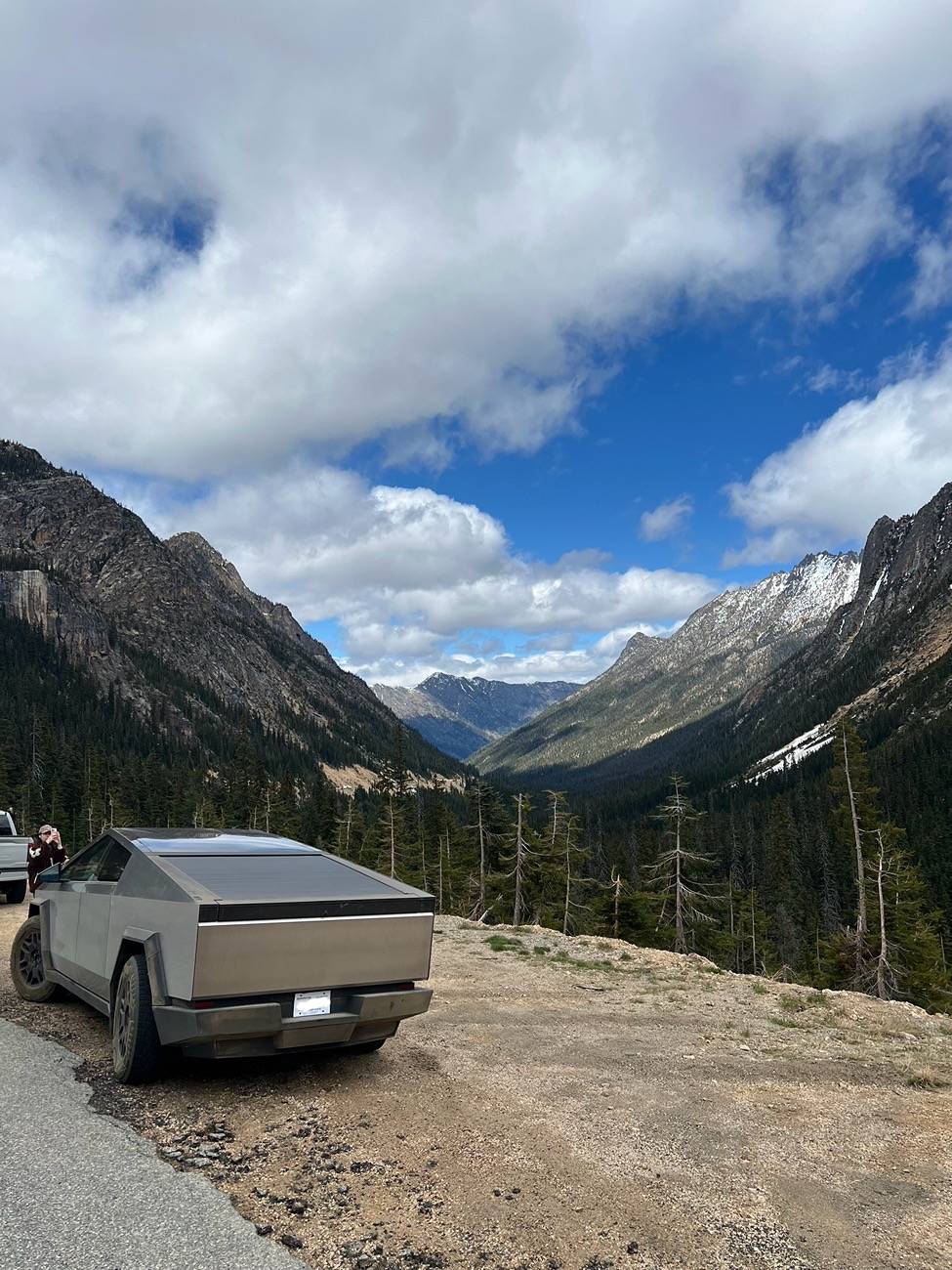

That northwesternmost one is North Cascades National Park. Beautiful place but you can’t stray from the main highway in an EV due to range concerns. I charged at Chelan to 100% then drove through the park to the supercharger on the other side. Got there with 20%.

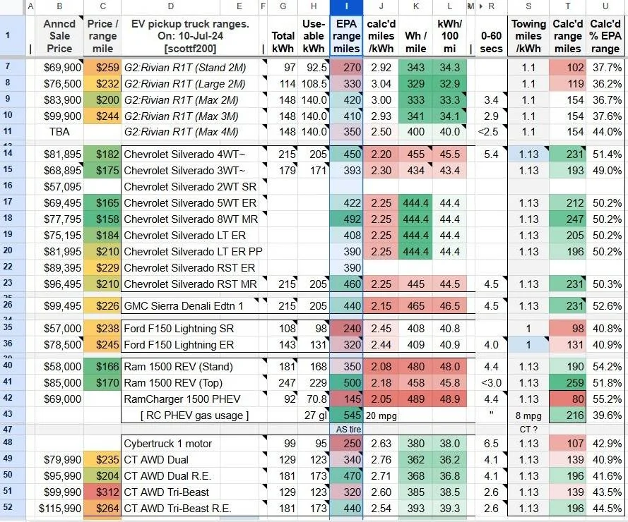

Here is one of the major reasons I'm not considering any of the other EV trucks although some of them have various pros compared to the CT. It sure sucks that the ~50 kWh Range Extender/RE takes up 1/3 of the CT bed. These other trucks can only operate on the V3+ Tesla Superchargers. The CT by comparison does both v2 and v3+. I updated this GIF 2024-10-24.
We charged at Entiat before heading through Winthrop and back west along the North Cascades Highway a few years back in our Model X. I don’t think that trip would’ve been possible with the older 75kWh MX we had previous to that one - not without relying on L2 charging or worse. Not long after that trip Tesla had a survey on where their next Superchargers should be installed, I sent a destination or 2 along that route. Doesn’t seem they have it on their radar at all. Definitely not a route you’d want to tow anything unless your camping over night and have 240v access at a campground.
