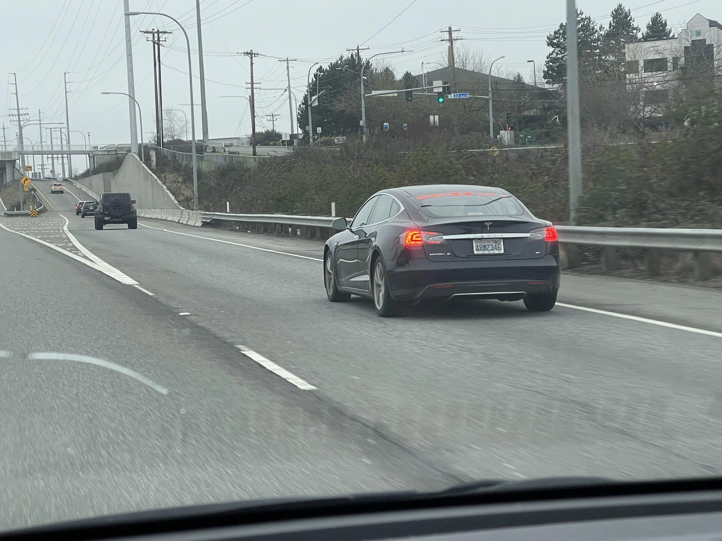

Driving around the other day, I saw this car:
Tesla Roadster 2nd gen LED Failure? 1643872192935
If you look closely, the LED brake light bar at the top of the rear windshield has some blank spaces. At the time it was really clear that some of the lights in the bar were not lighting up. These lights were only coming on as part of the brake light signal.
So I’m wondering how often these lights fail. Seems really unlikely that there would be so many failures on the same light bar. On the CT with the front light bar I’d really hate to have to keep fixing these things.
Anyone have any insight as to what was going on?

Reliability is all over the map on the LEDs we've bought. While there's no real reason for them to fail without tens of thousands of hours... the leads can break, solder joints can fail, and the control chips can delaminate or absorb moisture. In the case of that bar on that car, I bet moisture got in, and corrosion made the copper traces to burn out.
If a part is properly potted and shielded from bending or vibration, this shouldn't happen. Cheap stuff is cheap, it's not about being LED or not.

Just for people who might not know, that light bar is not OEM. It's an aftermarket accessory installed by somebody. Some aftermarket LED lights come with a resistor that you can install in series them to reduce the current going through the LEDs. This is because if the circuit isn't designed will enough or you connect it to a higher voltage than designed, you will cause the LED/s to burn up. Perhaps that person did not install the resistor.

That could be an open led strip similar to what I have inside my RV where wires and bulbs were exposed and simply being held by the plastic runner. Yup, that's flimsy enough to have solder fail when stretched or pulled. Otherwise, led bulb will hold and won't fail with even violent jarring (talking about my led Christmas lights that I just pull out from the roof and would fall on the ground before I wind into it's wheel receptacle).

Sometimes LEDs fail. I've seen multiple newer cars that aren't more than 3-5 years old with LED driving lights or signature lights that are burned out. I've had a few aftermarket puddle lights burn out for my Model 3. And I've had multiple LED house light bulbs burn out as well. I actually also expected them to last a very long time, but it seems like if one LED light fails it can cause the others in a string to overheat and burn out.
