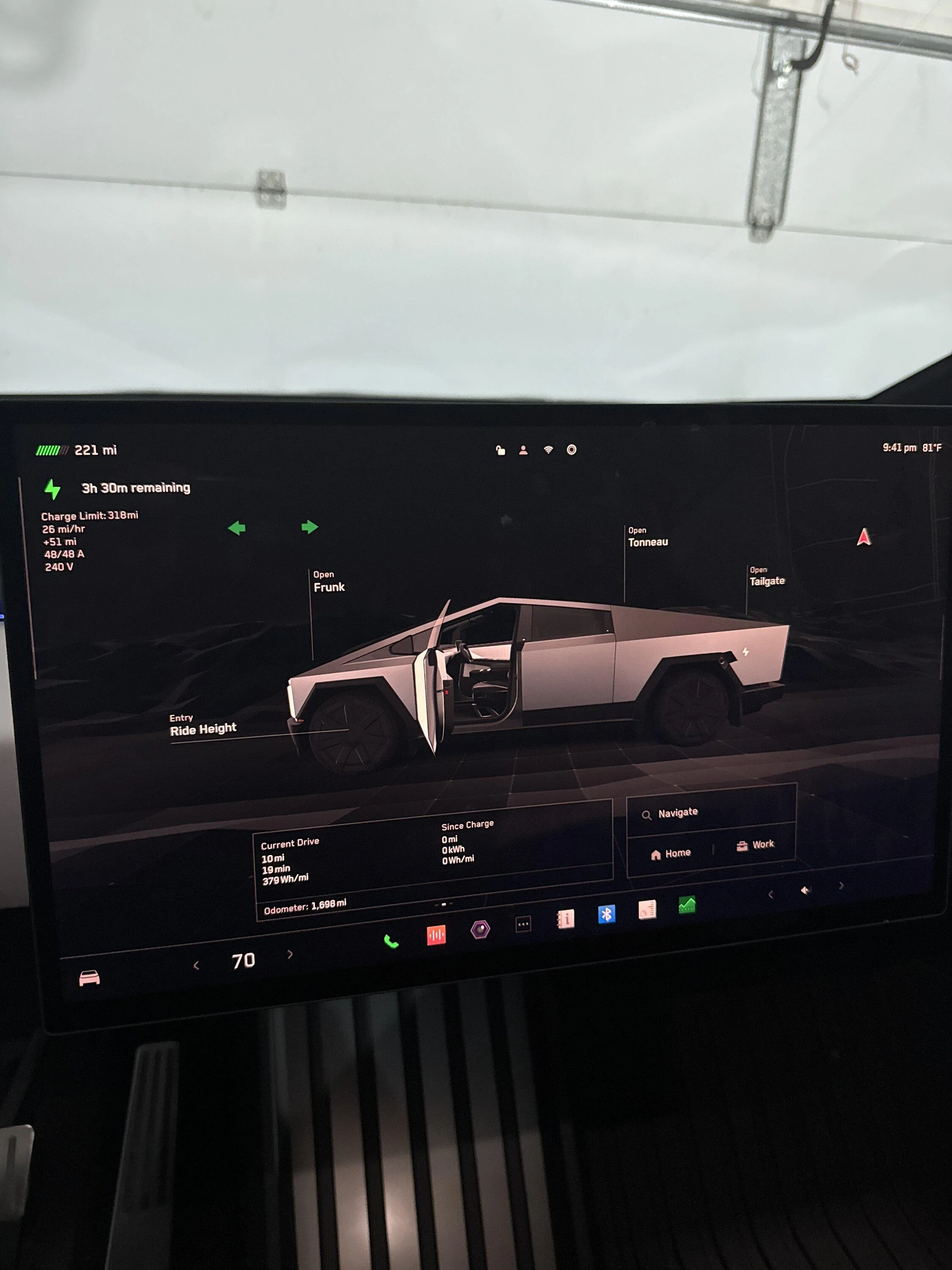

Hazard lights will not shut off touch buttons above the rearview mirror do not work or respond to touch. Haven’t had any luck with Tesla service or roadside. Their suggestion was for me to drive two hours to the service center to see if they can get them to shut off, if anybody has any suggestions, please send them my way I have already tried the two button reset on the steering wheel and the power off in the safety feature on the screen.

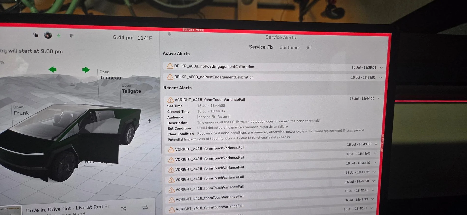

Mine randomly came back. My wife was going to take it to service today while I was at work, but she tapped the button and it shut off. Things I did... Full software reinstall from service mode. Removed FOHM and disconnected harness, then reinstalled after a few minutes.
