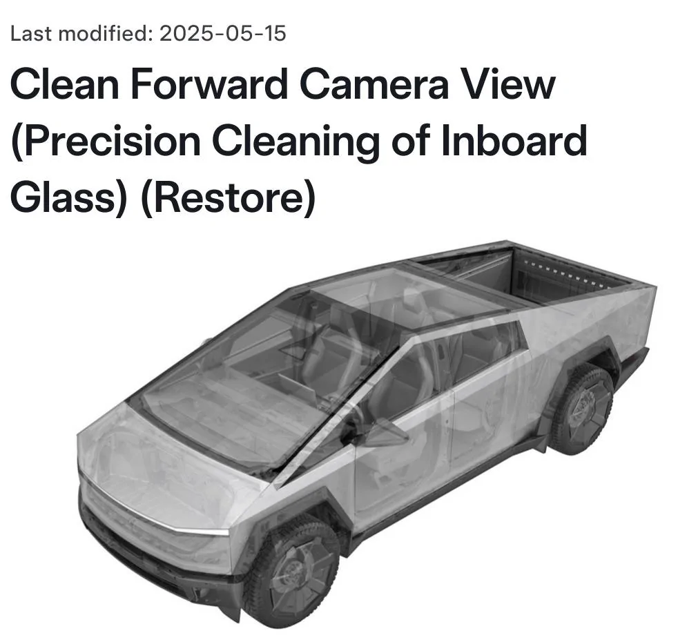

They may be confusing "professional" with "precision" cleaning. Regardless, a tissue around the car isn't going to fix the inner fogging.
While removing the five subassemblies to access the section of windshield in front of the cameras is in the realm of DIY, having the service center do it is much lower risk.
https://service.tesla.com/docs/Cybe...UID-6229D89E-739C-4ABF-BF8B-58E8FD447952.html

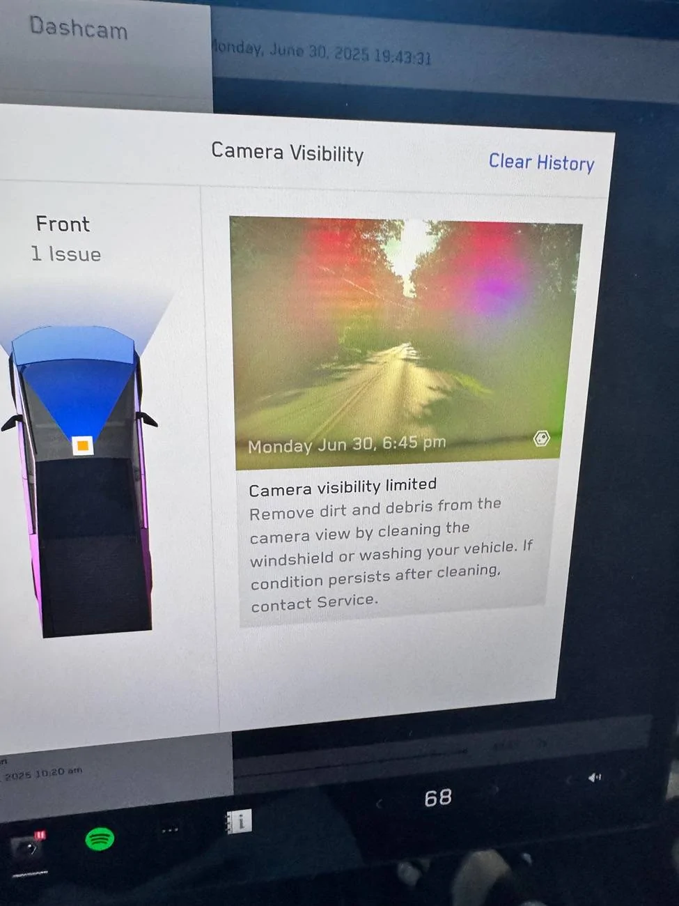

I got this alert which prompted me to take it into Tesla service. They are saying since I only got one alert and it didn’t show up again, I may be charged the hourly diagnostic fee if they don’t find anything? I’ve never had this happen with my other Tesla vehicle. Is this common practice?
I had the exact same message a few day after I picked up my truck. Made the appointment as instructed by the prompt and they fixed it no issues. I was told it required a software update. When I asked why an update could not be performed remotely, I was told the update doesn't always fix the issue and they are still working to permanently resolve the problem with a future OTA update. This is a known issue and is ABSOLUTELY covered by warranty.
