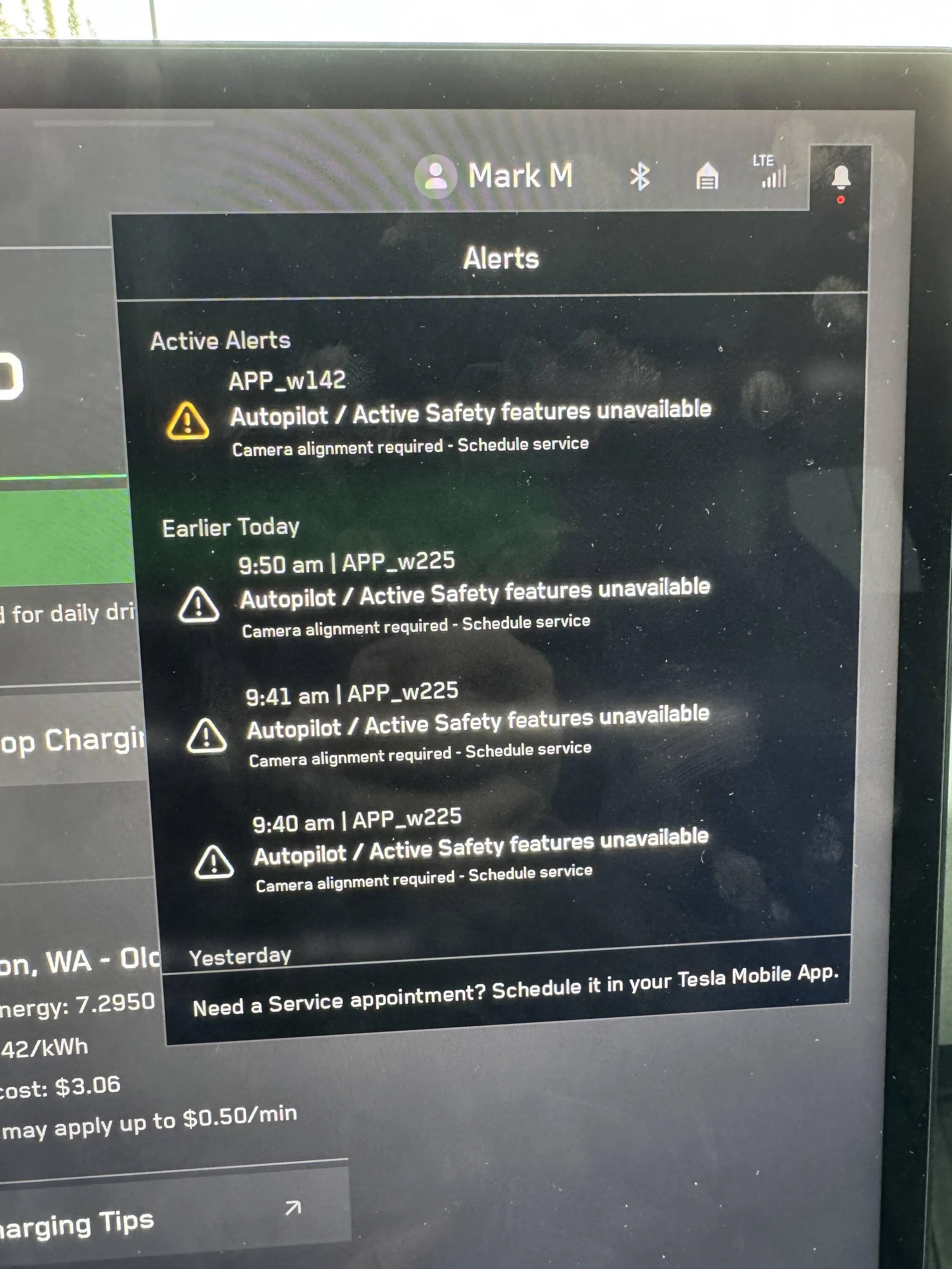

App_w142 alert "Camera alignment required - Schedule service" I've had my CT serviced twice for this and still get it.

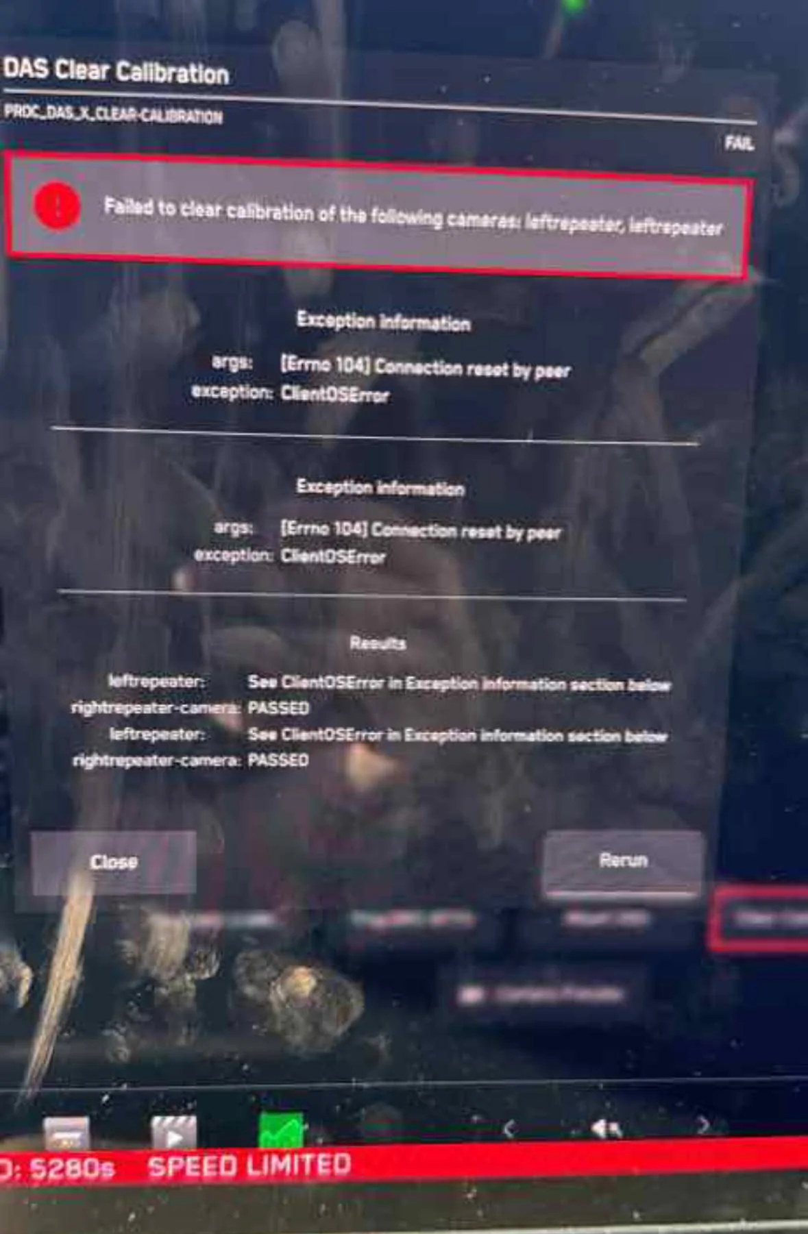

I keep getting kicked out of autopilot with this alert. I can clear camera calibration in the service menu and get it to work again but it shouldn't be happening, or is this an endemic problem with all Cybertrucks? Based on the service summaries it does seem to be a hardware problem but I'm starting to wonder if it's a software issue.
In the notes from my last service visit they say they found the swivel screws were loose and also replaced a wiring harness. I thought everything would be fine after those issues were fixed but it happened again 2 days later!
Interestingly, I get a ClientOSError frequently when clearing camera calibration in the service menu. If I keep retrying, eventually it clears without the error.
