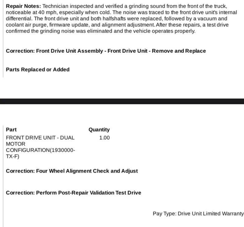

I wanted to give a detailed update in case anyone is experiencing the same issue I had. Just a recap:
My truck experienced what sounded like a gear grinding / plastic vibrating sound when I accelerate or decelerate between 30 mph and up. It was very apparent it came from the drive unit due to that behavior.
I took my truck in the first time to Gilman service center in Berkeley and they checked to make sure the fluids in the drive unit was proper and determined everything was fine. My problem persisted after that.
Couple months later, I encountered the front motor disable OK to drive error after supercharging which reset itself after going to sleep. But I scheduled a service appointment in San Francisco along with the grinding / vibrating issue.
The service tech rode along with me and acknowledged the issue. The told me later they would replace the front drive unit due to the front motor disabled and this grind issue. The service took 5 days.
Attached is the screenshot of the tech’s note and resolution.
If you have a similar issue, don’t let service brush it off as it’s normal and other trucks exhibit the same sound.
My truck is completely rid of any grinding or vibrating noise from the drive unit. It sounds like my model Y now.
Hope this write up is helpful. I am very happy with the result.

I don’t know if we had the exact same issue, but it’s very noticeable on mine and is definitely an issue since the replacement drive unit makes no such noises.
