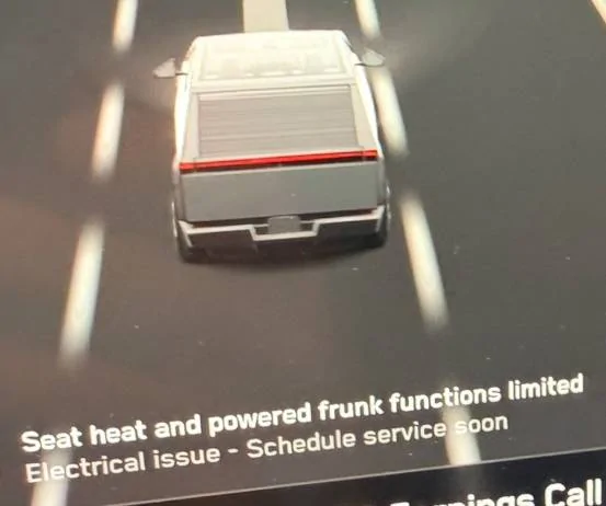

I had this exact same message
No error code
Eventually, my frunk would not open with the external switch.
Took it to the service center, and they found the exterior frunk switch was stuck in the closed position. I was able to open and close it using my app and the screen and close it with the switch inside the front.
Luckily they had The switch in stock and replaced it and all has been good since then.

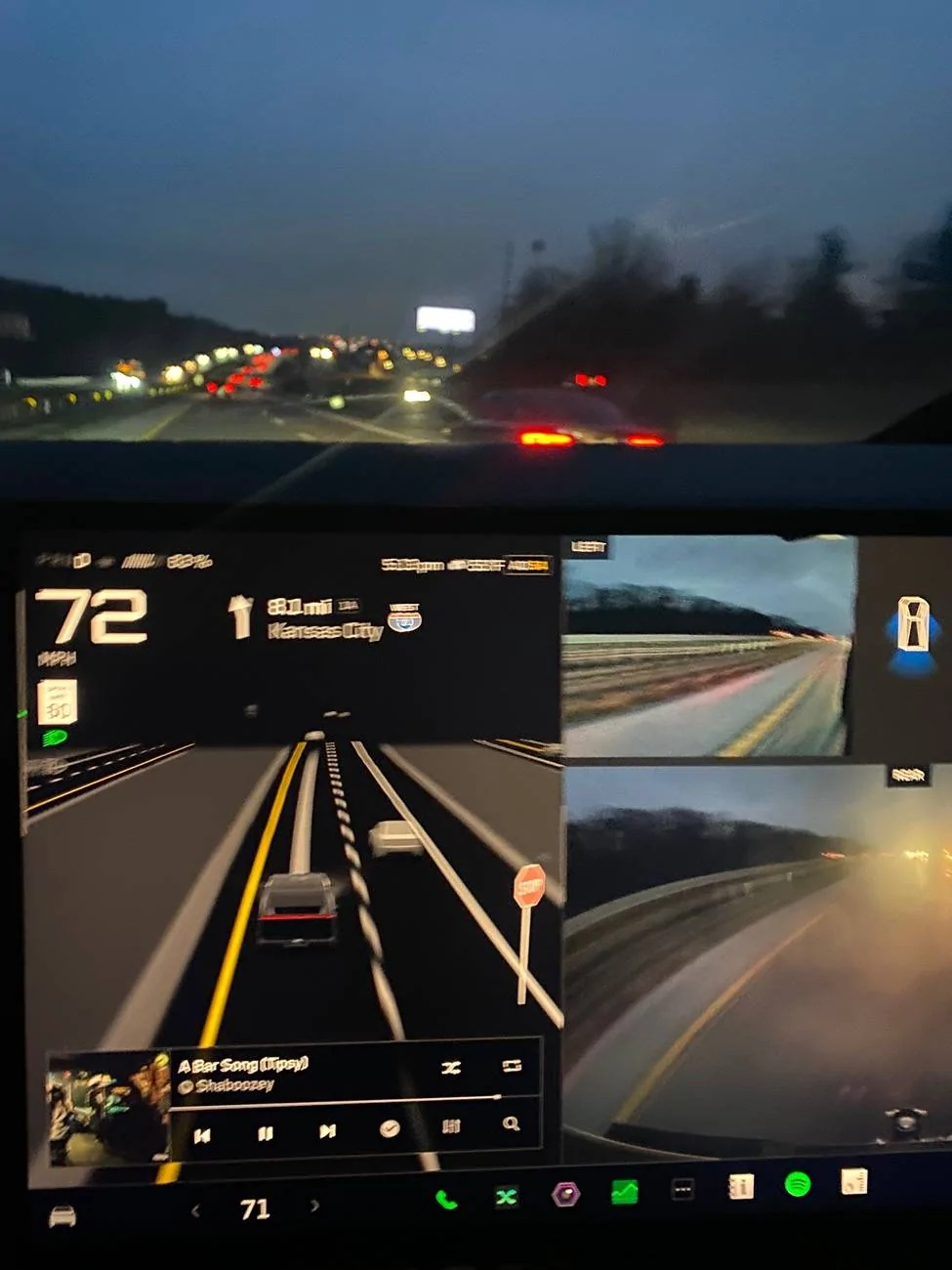

I agree with the statement about this most recent update being buggy. I was leaving the SC and stopped to charge before heading home. Put the truck in drive and started to go but the truck tried backing up! Did it 3x then did the steering wheel button reset and it worked right. About 10 min later was going down the highway and a stop sign was floating in the slow lane on the display. Earlier today the rear view camera feed disappeared feom
The screen and wouldn’t come back up. Everything worked great until the update. (Was at the SC to pick up my snow tires and have them install the bolts they forgot during the inverter replacement)

A bit more detail…
When I first saw the message I immediately attempted to make an appointment in the app. I received a quick response that if I had safety concerns I should come straight to the service center. I drove straight there and they could not diagnose an issue. The frunk switch failure occurred days later and I drove to the Service center arriving when they opened. It was obvious that the message was a result of internal diagnostics of the switch starting to fail… pretty cool. I’m guessing that the heated seats and the frunk switch share some common electrical element as to make it unclear where the issue was emanating from.

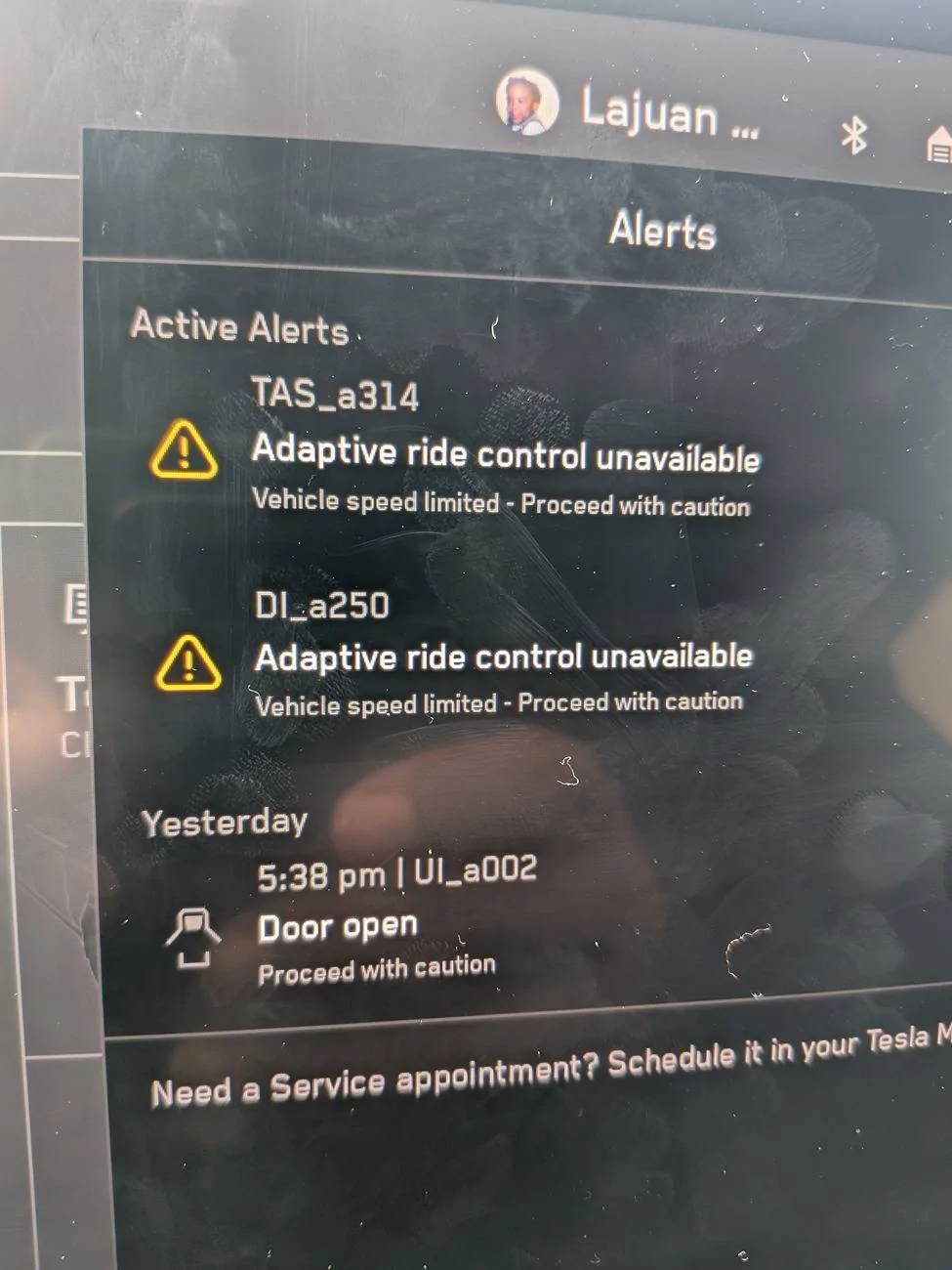

Has anybody else gotten this error? I tried holding both scroll buttons down and rebooting the system and went into the settings and did a full shutdown of the car, but the error persists…
I have got that but I got a suspension one but it went. Away . It did limit my speed to 91 but I drive it and it went away .
